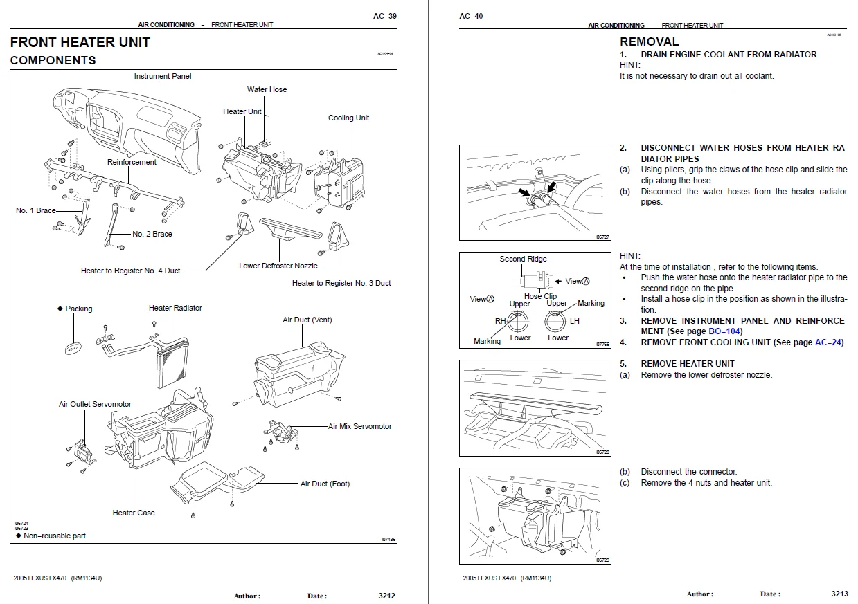

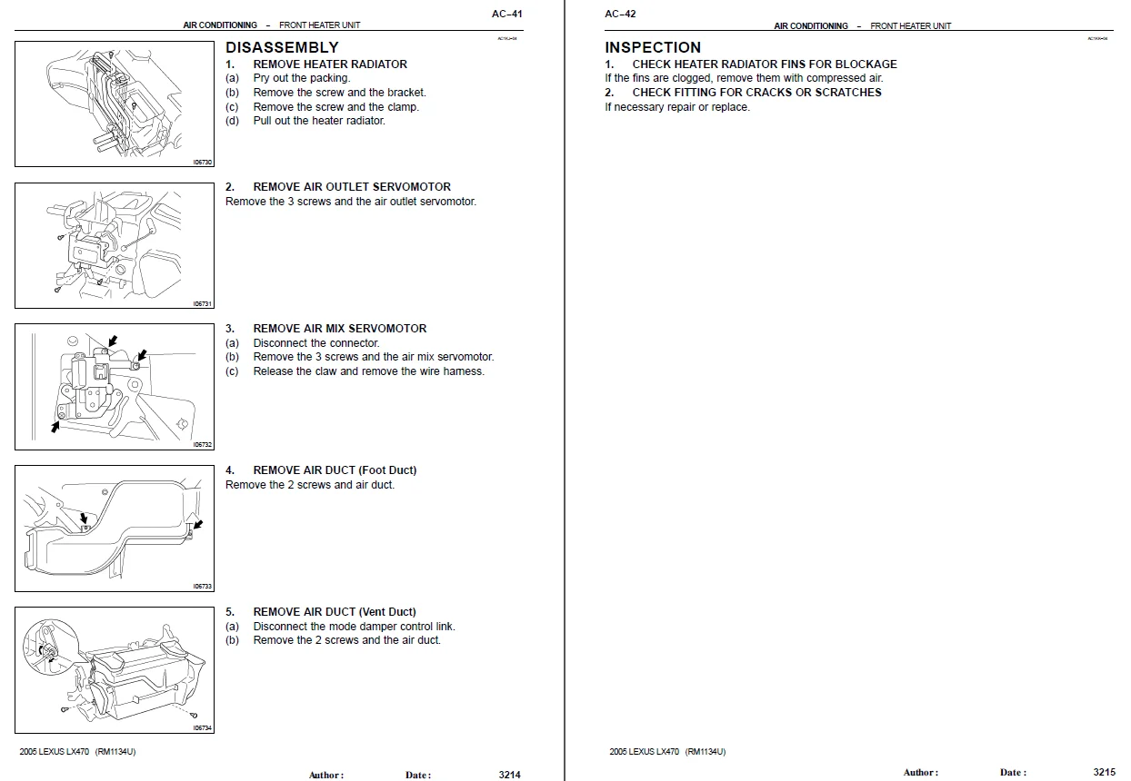

After conquering the AHC issue, now fixed (thanks!), I’m wondering if anyone has a video tutorial or step by step pictures on how to replace the blender door motor in my 2005 LX470? I’ve searched and searched, none are located. Am sure that some exist, just need a link. I have the digital shop manual, I’d even use that if I had the right search terms to use.
I have the issue that has no temperature control range control. AC is ice cold or hot but no adjustment. Same for the heat.
Youtube link or whatever would be appreciated.
