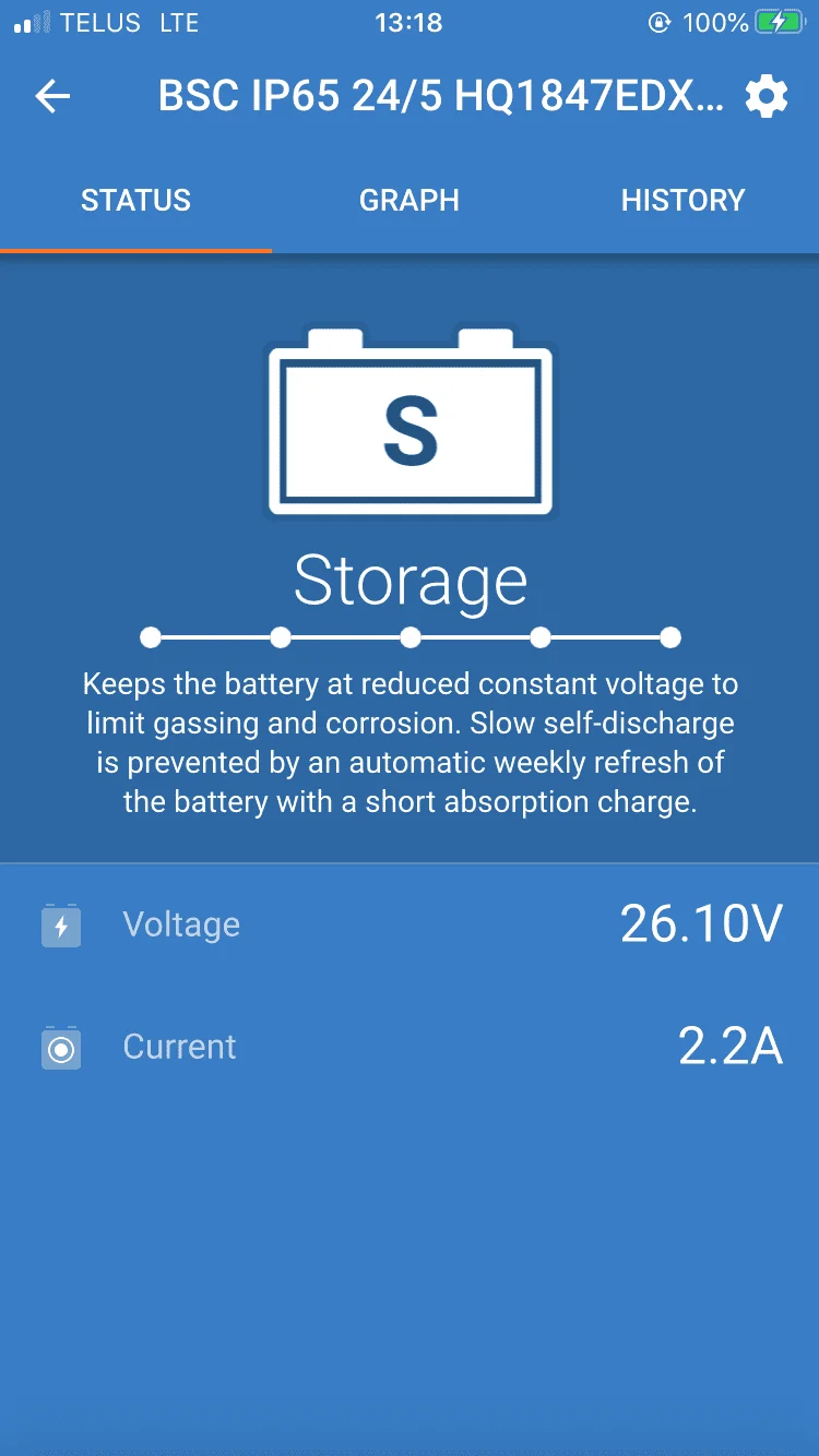

Took this picture after turning on the fridge when the charger was in storage mode. While in storage I could hear the charger clicking a couple times every minute as it cycled and the readout would go to .2amps for a bit.
When the fridge was on it jumped to just over 2 amps (fluctuated up and down .3amps or so) and maintained the battery bank in storage at 26.10V

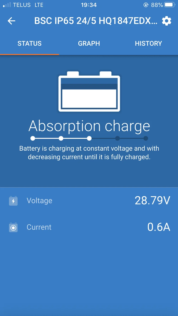

I happened to be at the shop yesterday for a short bit and checked. Not sure if I triggered the absorption cycle due to playing with the settings but from what I saw of the amp load when in the absorption cycle I think I will be fine with the fridge cycling (if I happen to have the fridge on and vehicle parked long enough to hit that cycle when in maintenance mode. This was about one minute into the absorption cycle.
