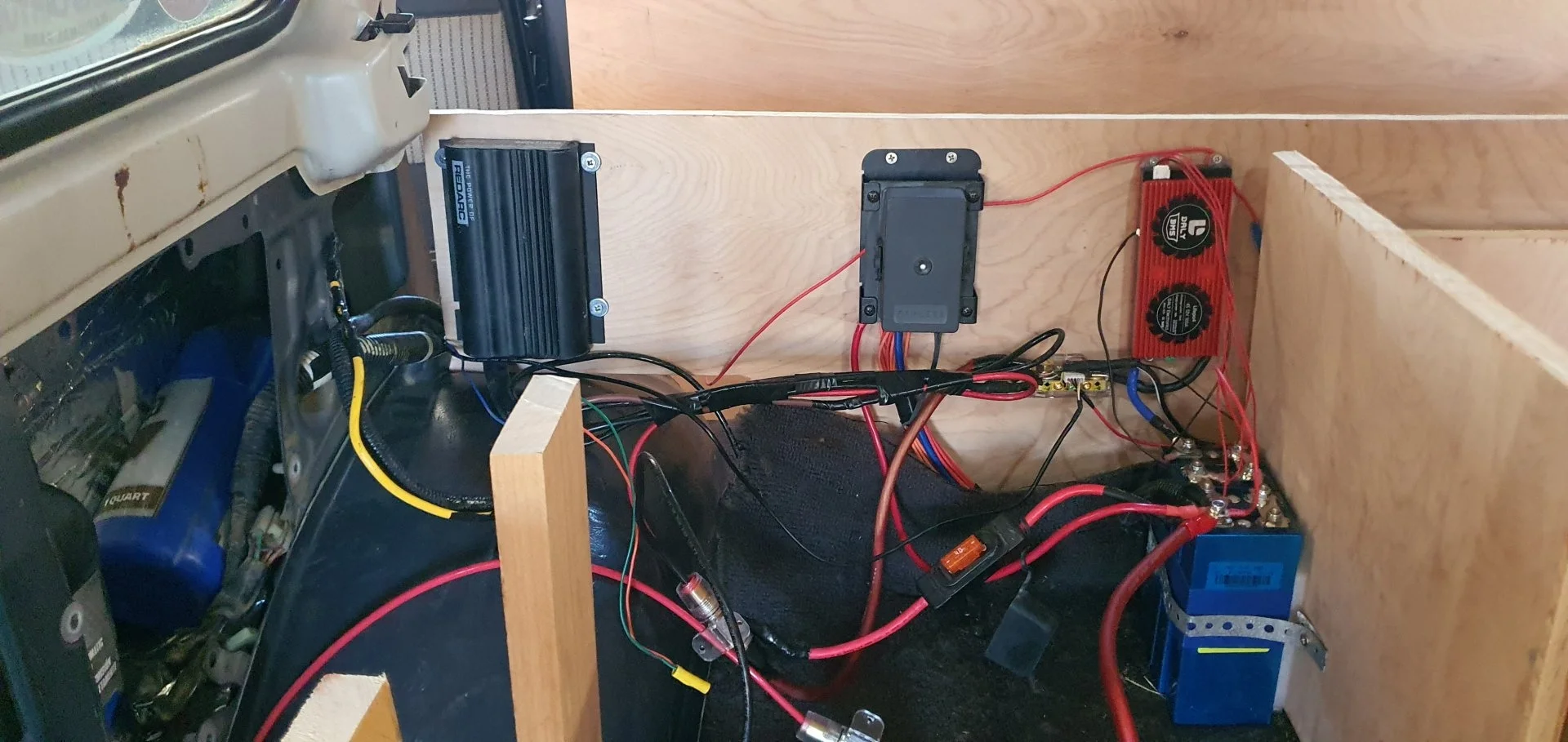

This is the most bang for $...
I build this is in the back of my FJ62, wiring is tidier now...
100 Ah in LifePo (4 cells x 25ah) - $100 + $50 in shipping
BMS (Manages the charging, load balancing, temperature control etc.) - $120
Not so smart Shunt to keep track of in and out coming current - $40
The Redarc BCDC I already owned,its about $350... I highly recommend getting one of those. My alternator only puts out 50 amps and I don't want to put any load on my main battery outside of starting/running the car.
And then I have an pure sign wave invertor hooked up to it all as well as my Twin ARB compressor + Fridge.
Its working so well...100AH with lithium goes a long way...
Do you mean 4x 100Ah cells (in series for a 12.8V nominal battery)?
No they're actually 3.28 Volts per cell. X4.
All sorts of ways you can set this up depending on the amount of AH or voltage you'd like. 100 Ah is enough for my needs right now. But you can buy 4 100 ah cells @ 3.28 Volts each, they're only like $125 per cell. I buy them here in Utah.
You need 4x 3.2V 100Ah cells in series for a 12.8V 100Ah battery. If your cells are 25Ah and you connect 4 of them in series you have a 12.8V 25Ah battery.
