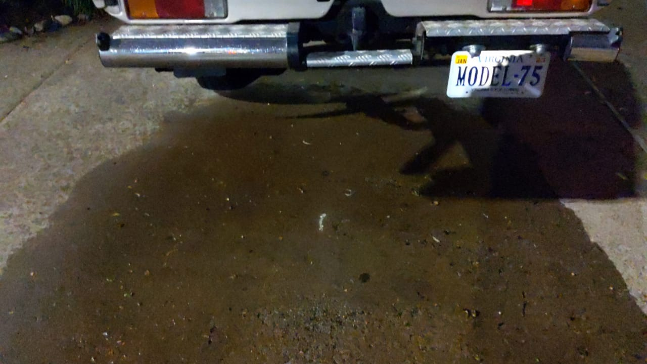

On a somewhat related issue, I've looked in the FSMs but cannot seem to find a comprehensive fuel diagram and I've got a bit of an issue with Golden Boy:
This is a photo after about 24 hours parked with a slightly nose up attitude. Drips appear to be coming from both sides of the rear tank.
Golden Boy is a 1991 HZJ75. The guys in Dubai swore they fixed the fuel switch system but now when I press for the sub tank the light in the little binnacle just flashes erratically. The front tank fuel gauge works to an extent--It shows a quarter tank when the front tank is completely full. I've been driving the truck quite a bit and had noticed that when the tail is lower than the nose it did drip just a little bit, but not as much as this. Yesterday I filled up the front tank to top (which I should not have done), figuring that the issue was only with the rear tank. The drips are definitely only from the rear tank and it seems to be dripping from both the right and the left side.
What I don't get is how the fuel is getting from the front tank to the rear tank. I think the rear tank should be pretty empty by now. I can't seem to find anything in either the 70 series body FSM or the engine FSM that is very useful. I get that the injection pump continually sends fuel back to the tank, but why is going to the back tank?
I've been meaning to dig into this, but I am leaving for a couple of months. I'm trying an experiment by putting the truck in a slightly nose down attitude to see if that makes a difference.
I'd really rather not fiddle with this before I leave. Thank goodness it is only diesel and not gas. I probably will go out and get a fuel siphon tomorrow and try to drain the rear tank at least.
I'd really appreciate any thoughts or advice the forum might have for me.
first off, you should have two tank switching valves, one for fuel to engine, one for fuel returning to the tank. When you are running off of the front tank, the fuel return should go to the front tank. If running off of the rear tank then the return should be to the rear tank. At least that is my understanding of how this works. When you remove the fuel caps is there pressure with both or one of them? Does the rear tank level indicate empty? I am guessing that one, the level gauge for the rear doesn't work right, and second, the return switching valve is not working and it is stuck with the return to the rear, therefore overflowing. Just a thought.
The good news is that the leak almost completely disappears if the truck is parked slightly nose down:
I'm just going to have to drop at least the rear tank. But I won't be able to do that for a couple of months. Sigh.
