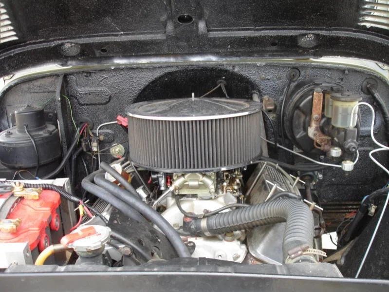

I wanted my batt under the hood and not in the cab but also wanted to keep it away from header heat. Final solution was making a box (sad photo) that mounted to the fender on the outbound side and mounted to the frame on the inbound side.
I was thinking it wouldn't fit there for some reason...have to relocate the dipstick. Glad it will fit. I've been so focused on the tub I forgot all about this.

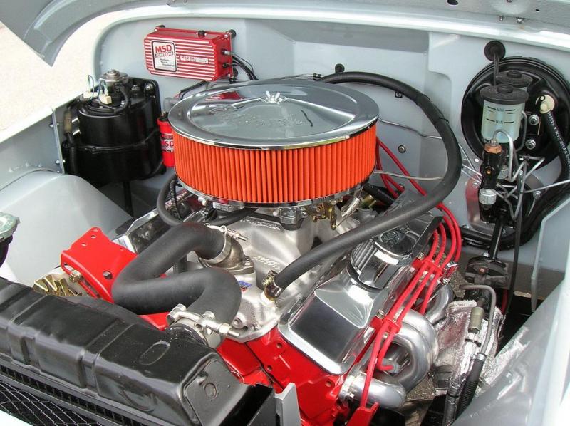

I wanted to keep the engine bay tidy and at the same time help with some weight distribution so the battery was moved to the back of the tub.
More engine porn.........what type of engine setup is that?
The engine is a Chevrolet 350 cu.in. crate motor rated at 290HP before the Edelbrock add-ons. I used the Marks V8 adaptor kit which allowed me to use the stock Toyota T-case and transmission. One of the benefits of this kit is the driveshaft lengths are stock and unaltered.
