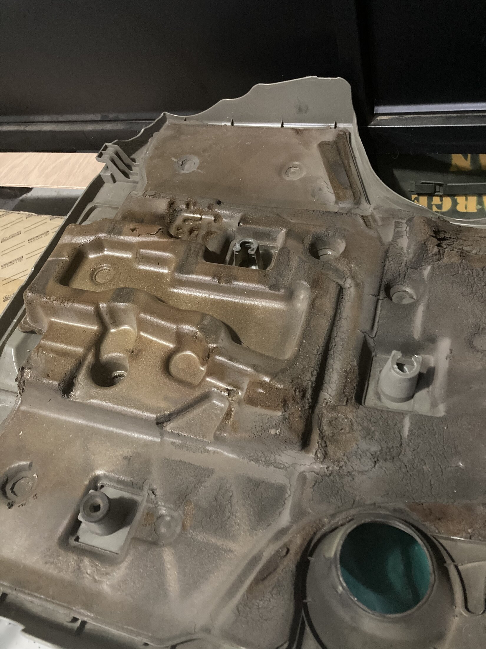

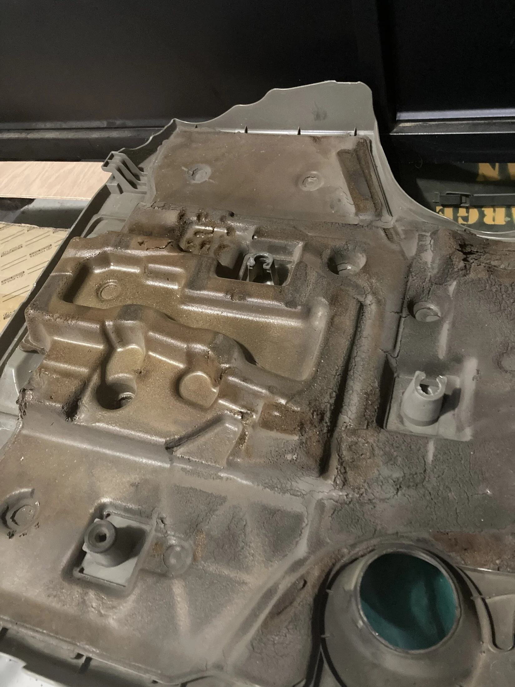

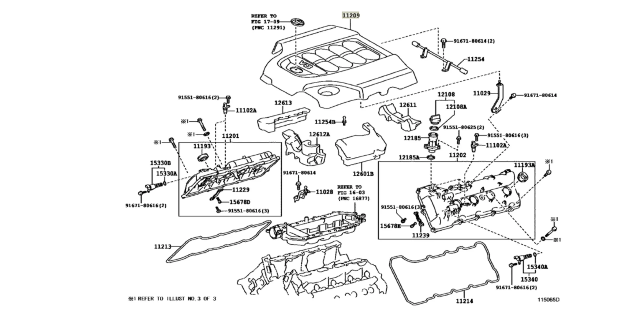

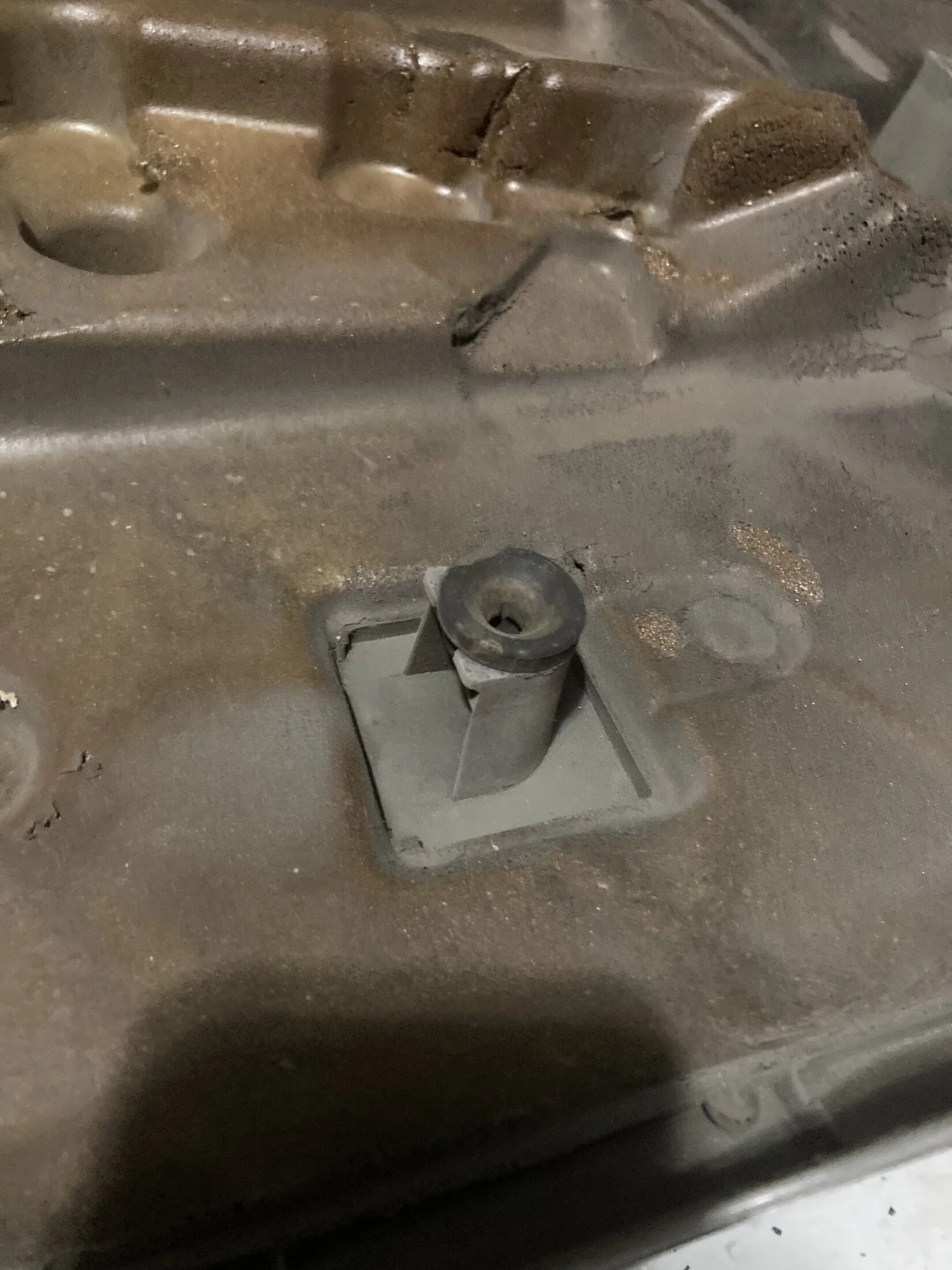

Hi, I was wondering if anybody knew the PN for the rubber pieces that attach the engine cover onto the little spherical "stands"? I've looked on multiple schematics diagrams and just can't find the PN. Photo 1 below shows the one piece that I still have intact. The other 2 have pretty much disintegrated. Thanks!

I don’t see a separate number for that part, but there is one on lots of other Toyota models. Try an image search for 90480-22024 and compare your one remaining part to that.
