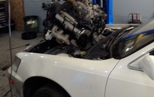

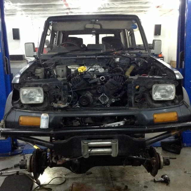

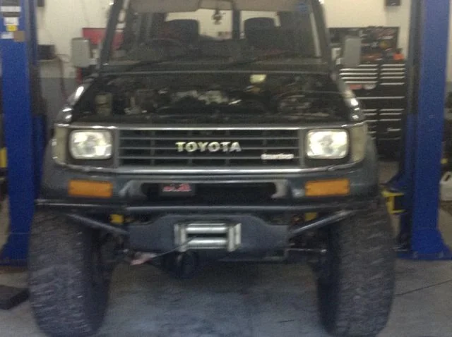

I'm posting this for Pradocruzer (BC, Canada), as he doesn't have much time for posting these days.
Pradocruzer imported an LJ78 about 10 years ago. He made a number excellent modifications to his truck and drove it without any issues (no head problems) for that time. Recently, although his 2LTE was still running fine, he decided to go for a 1UZFE out of a JDM Toyota Celsior for a bit of a power up. This is the RHD equivalent of the Lexus LS400, minus some of the emissions stuff.
Over the space of just a couple weeks in his spare time he swapped in the 1UZFE, and had his truck drivable again. Sounds like he is tying up a couple odds and ends now like going to a quieter exhaust and installing an aftermarket trans controller (spitronics).
As far as I know, this is the first 1UZ into an LJ78 in North America (this swap is more common in New Zealand as I understand it). So hats off to Pradocruzer!! I'm hoping this is the first but not the last LJ78 to be converted to 1UZ.
Here are some pictures of his work:

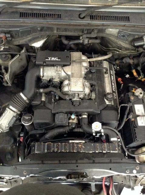

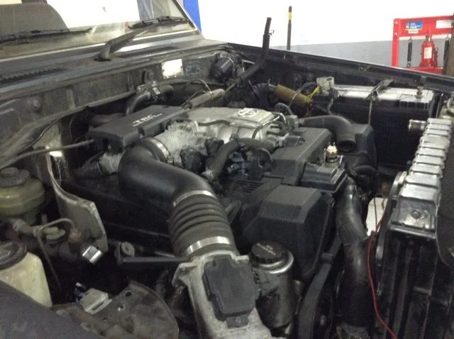

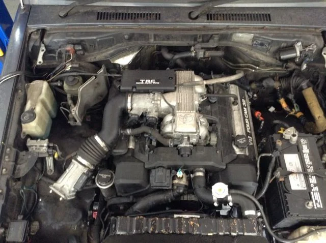

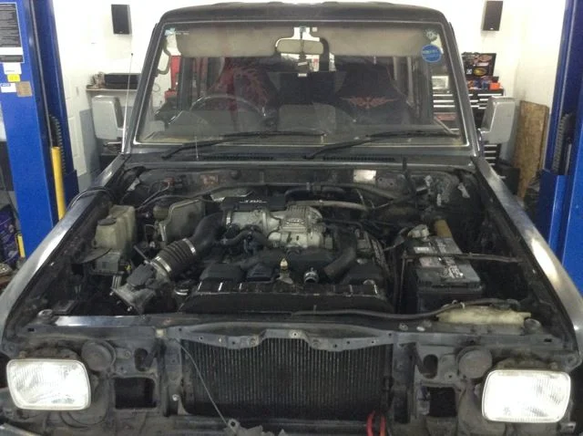

Good work. They fit there nicely eh? I moved my radiator forward a bit to fit in an engine driven fan. You'll need a pretty good electric fan to keep up if it's ever used in warm slow conditions.

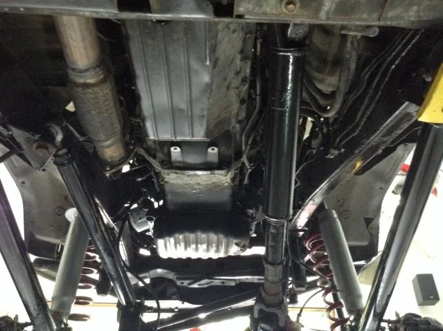

Is that a std front-hung sump or has it been modded? Mine was a mid sump & we had to do a cut & shut on one side to clear the front diff.
If it's going to be used anywhere wet look into sealing up the cambelt area - you can trim down & seal/rivet in a std lip seal to go in the hole in the cover in front of the cambelt pulley. Gobs of silicone sealant around the rest of the cam belt covers & you're done.
Cheers
Clint
Hey Clint they do fit nicely. I was concerned about the electric fan also and may have to switch back to a clutch fan.
I recycled lots of parts off the 2lte like the intercooler pipes (now exhaust) and the electric fan I already had.
It is a front sump and no modifications to the pan.
I have about an inch and a half clearance at full stuff with my lift.
Thanks for the waterproofing tip I noticed the timing belt cover was not sealed well.

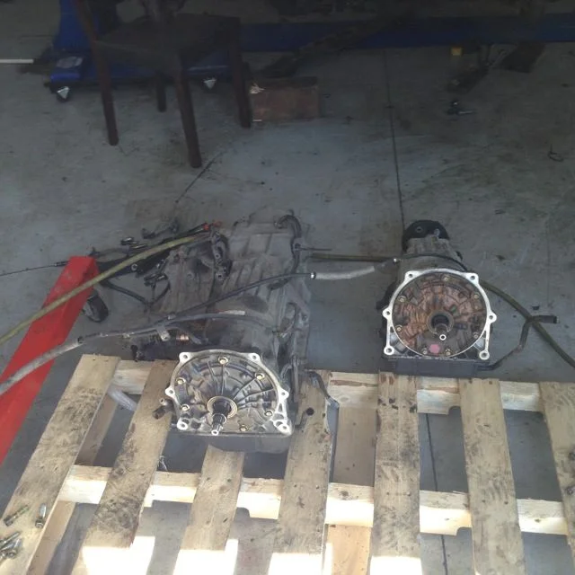

What trans are you running in yours?
I have the Prado autobox with the mods to fit the 1uz.
Just ordered a Spitronics trans tcu we will see how that works out.
With the 529 gear ratio I wanted to custom tailor my shift points.
One of the guys here in NZ has kept the hydraulic controlled radiator fan. Works really well... He had it in the front and now has rear mounted it...
Make sure all the electronic sensors are water tight... Esp the crank angle one any sign of water and they cough and splutter. Also the starter is in the tunnel the Vee of the block creates... This also can fill with mud and water.....
Hi Mate, we just used the existing R150F 5 spd trans. Custom machined flywheel, Modified the 1UZ bell housing to take the clutch slave cylinder & fitted an adapter plate to match onto the gearbox. My friend Mike who was the brains behind the conversion has done several into different Toyotas so had drawings & templates for all the bits.
