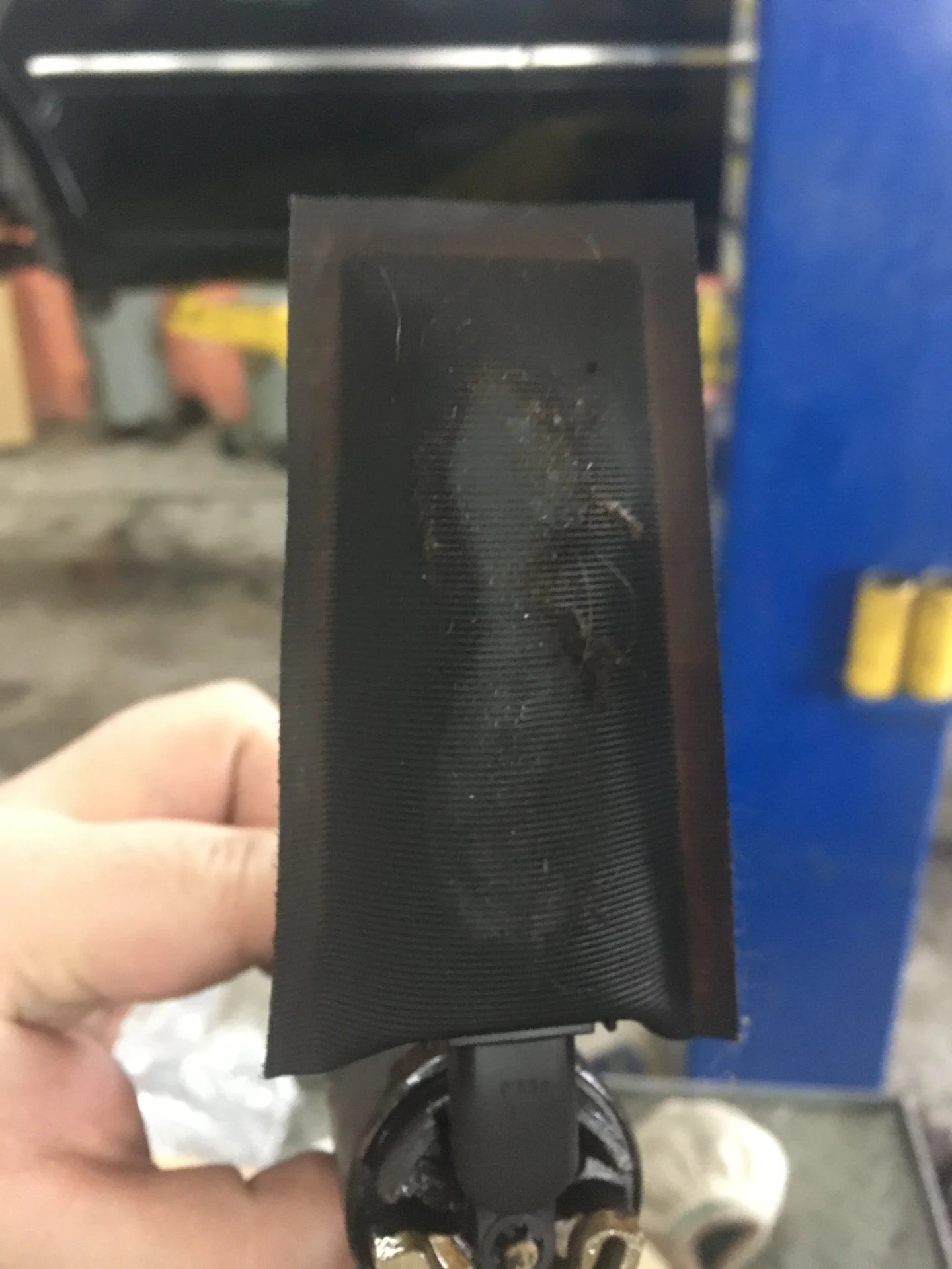

First picture is old fuel pump filter. So it's very very dirty.

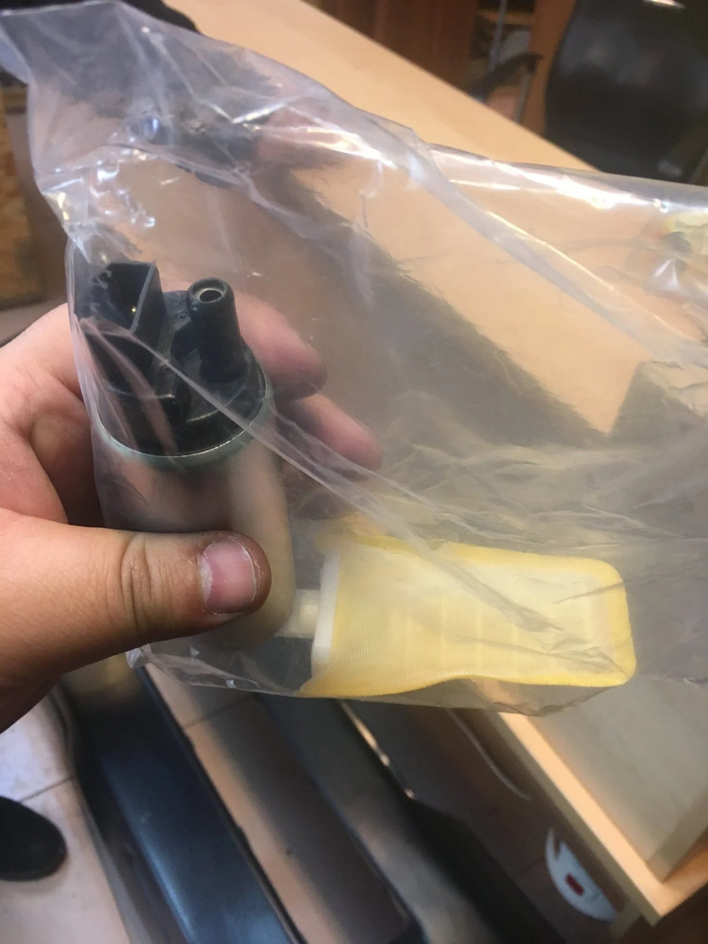

Second picture is new fuel pump that i purchased

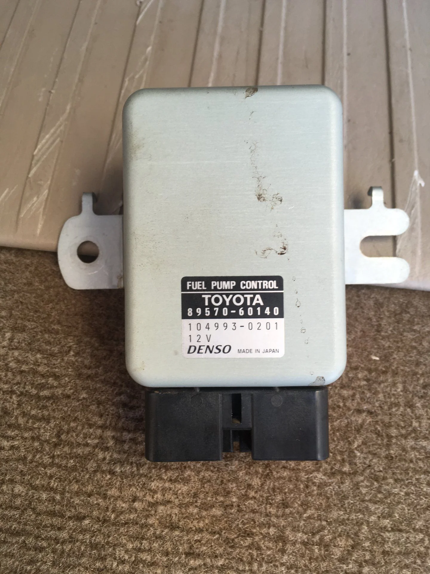

Third picture is old pump
