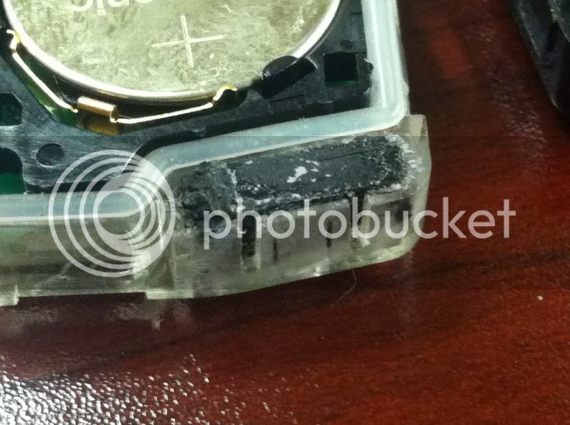

The transponder chip is not powered by a battery. It is tiny - about 1/4" long. It's in a slot next to the remote (the part that is battery operated to lock/unlock the doors) and looks like this:
Make sure the transponder did not fall out of your remote shell. Also, it needs to be right by the key head, and it should NOT have other transponder keys near it when you are trying to start the truck.

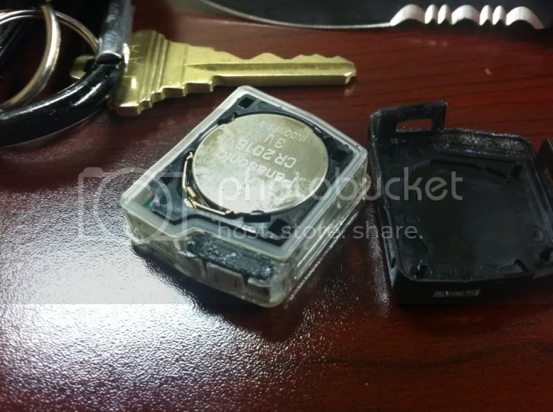

You need to take the key apart (small screw). It's mounted on the backside of the button part next to the battery. I have a totally useless keyfob that was washed a few years ago with no battery and the truck still starts fine. The transponder can't fall out.

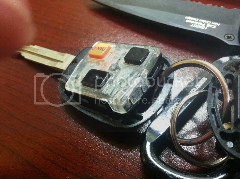

Yup, that's the remote. The Transponder chip is glued to the inside of the remote "shell". Pics to come....
2004 remote, with the "key clamshell" removed:
Remove the back cover to access the battery inside the remote:
THIS is the transponder chip:

Ryan: I think they changed the internal design in 2004. It still works the same. On mine, I can remove the transponder chip without disassembling the remote piece further than what I pictured and the transponder travels with the remote. Not sure about the earlier ones...
