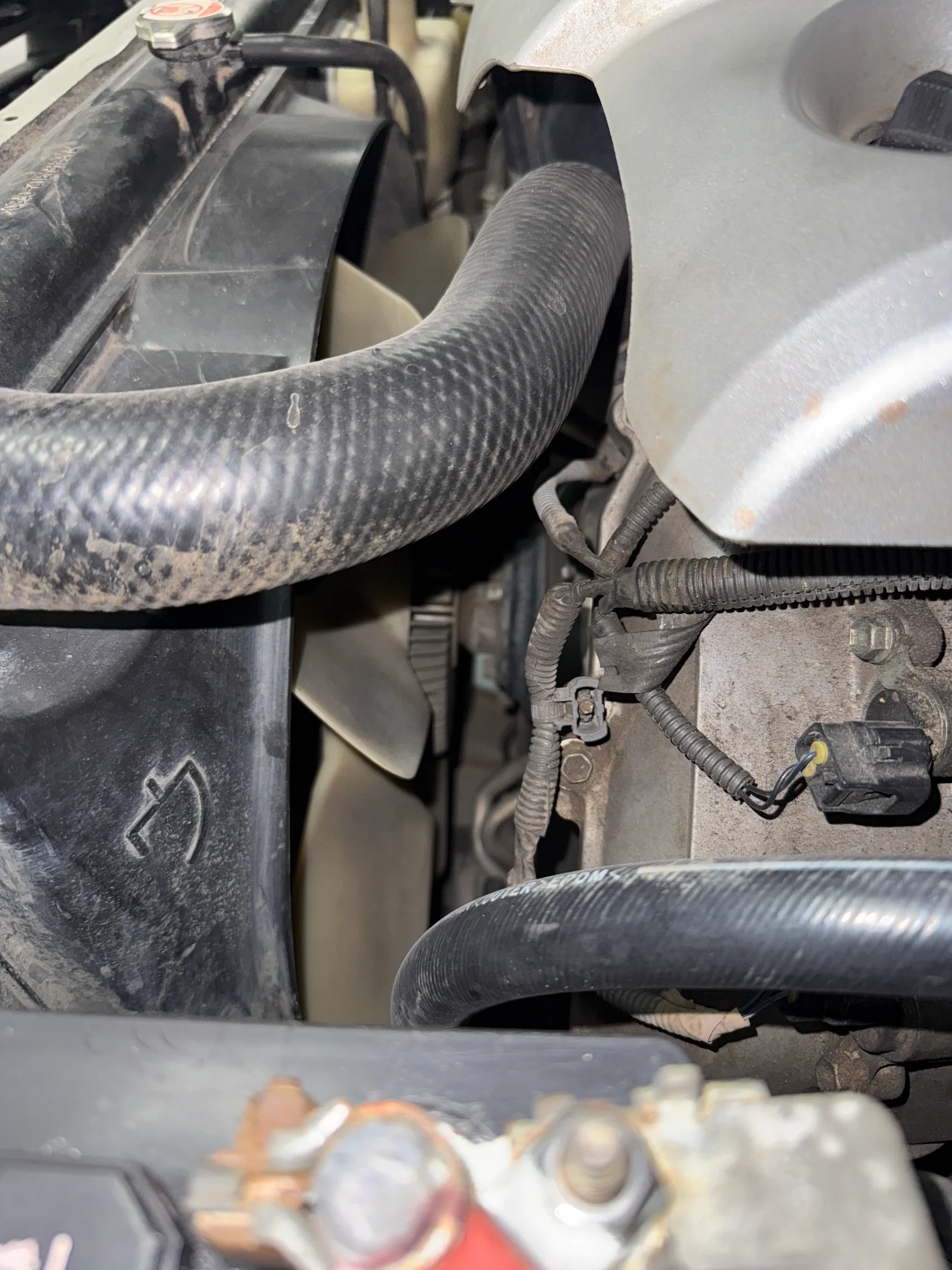

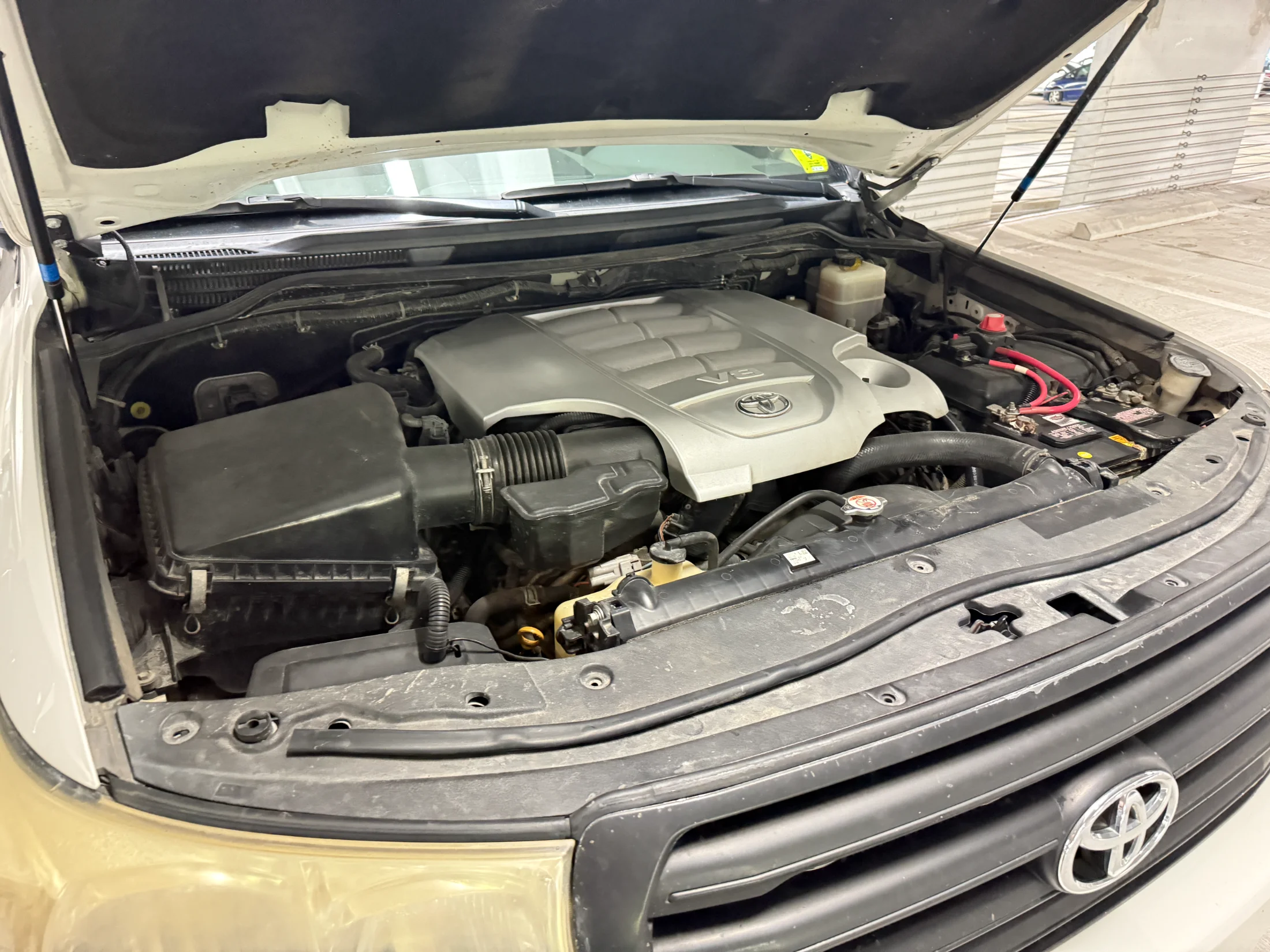

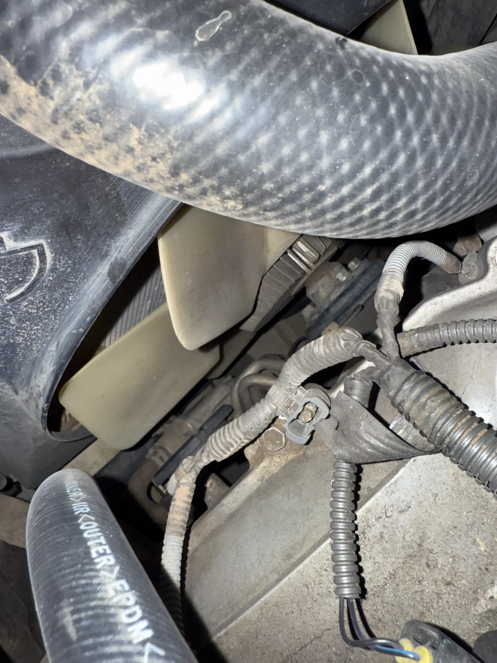

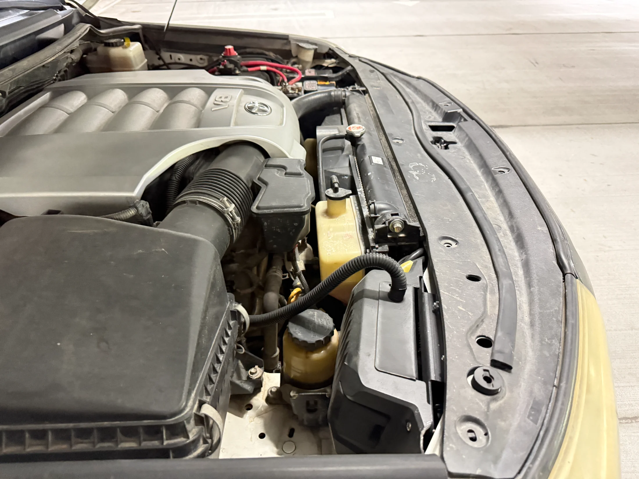

Is the fan supposed to be this far back? Seems like it's out of the shroud.
Also, is it supposed to be stiff or loose if the engine is not running?
So the winch definitely blocks the bottom of the radiator; I don't think the winch box does. This is my first summer trip with the winch, but my issue is with idle/slow speed, not highway speed.
When the engine is off, you should be able to move the fan, but there will be resistance. If it spins freely the clutch is shot.

Okay, well, definitely shot then. It spins completely free.
