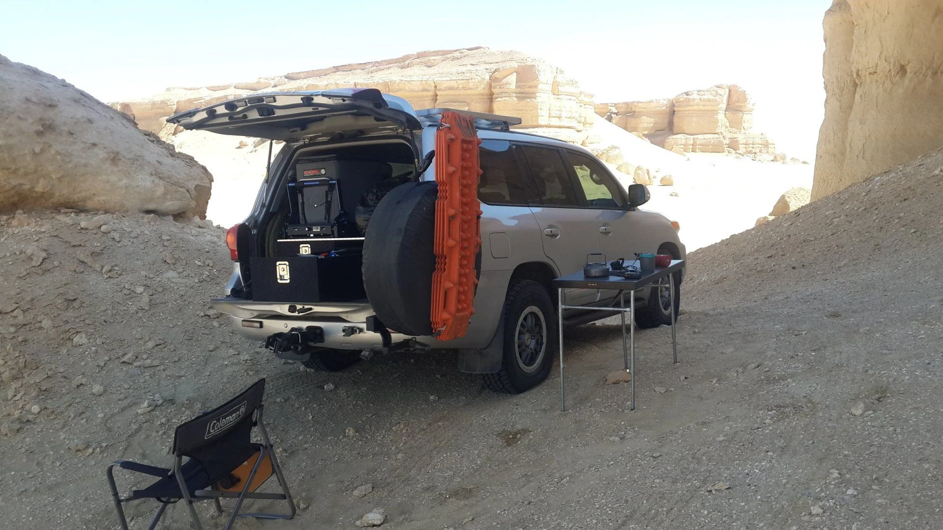

Thanks all for the info.. I have around 700-800lbs extra constant weight (extra 45 gallon fuel tank, drawers full of stuff, fridge, tire carrier) and want to offset this with airbags. Sensors are at standard height.. I do a lot of offroading so need my suspension 'fresh'..

I had to do a double take there. I believe you said LX570, but the pics are of a LC? Or do you guys have AHC available on the LC platform in Egypt?
I do have an AHC equipped LC.. But I know my coils and suspension are the same as the LX's and you guys in the US only have AHC on LX so was taking a shortcut :)
The truck is European specs.. Imported.

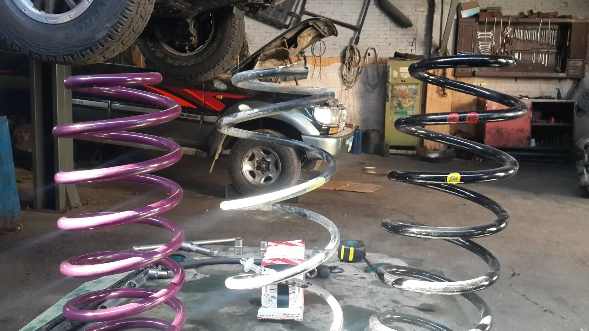

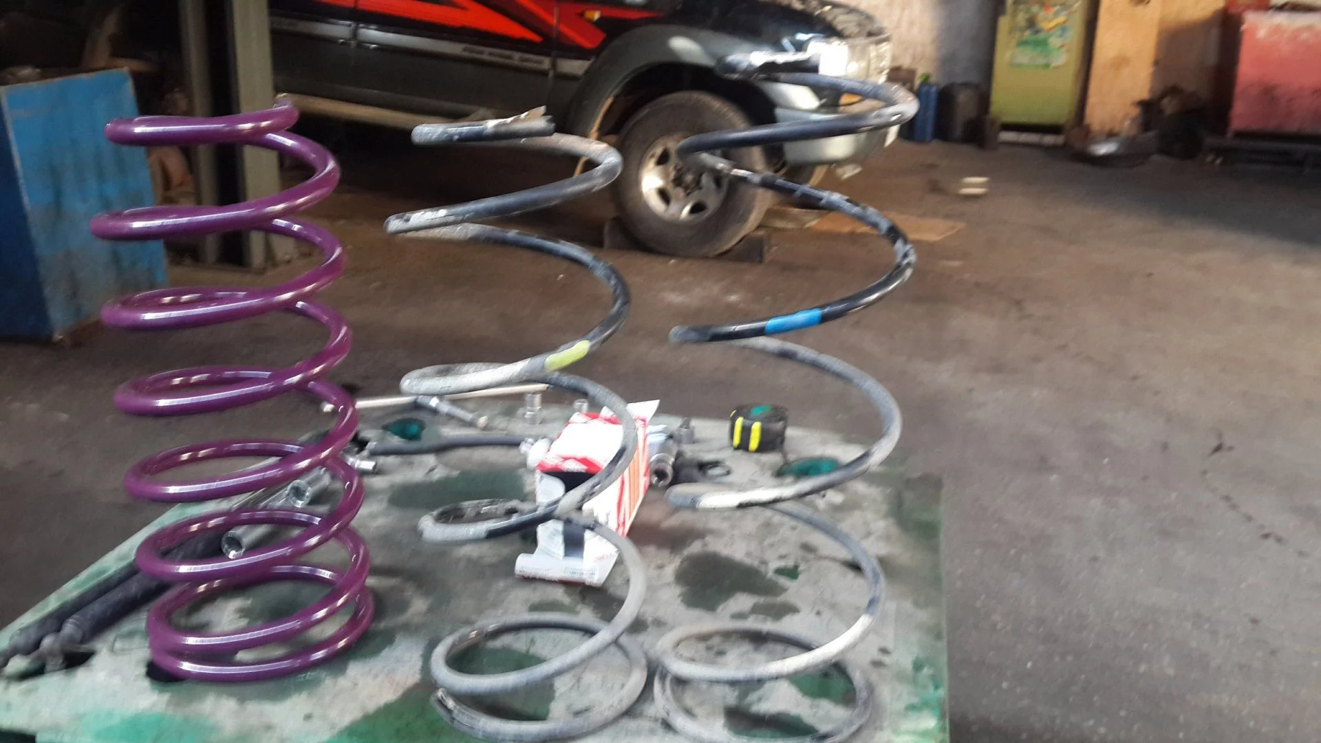

Well, I have good news for LX570 and LC AHC owners..
I had stock LC 100 Springs from my other truck and installed them today instead of the stock AHC Springs.. they did the job magnificently..
All Heights available on empty and full fuel tanks... Pics of the springs will follow..

Embedding @Mago 's pics here:
Left to right: Armoured AHC spring, stock AHC, LC100 stock.
I noted the right AHC spring is higher than the left one by almost 2 inches..

So far I think they are a bit oversprung.. On a speed bump exit I feel it is going to bottom out but it doesn't.. Otherwise I have my truck back :bounce:
Anyways I need to load it more and test.. This is an excellent start because now we know incrementally heavier Springs would work if those are oversprung in the future.
If regards to it being oversprung...
If haven't done an AHC sensor lift, you could try lifting it that way incrementally. This would have the effect of reducing preload on the LC100 springs. And in effect, reducing the spring rate at normal ride height. Perhaps an 80-series spring might be something to try if you have availability for that.

The purple spring is a German Eibach... Am dying to try it out.. But I know it will be too stiff with the stock shocks. It requires larger shocks, which I also have.
