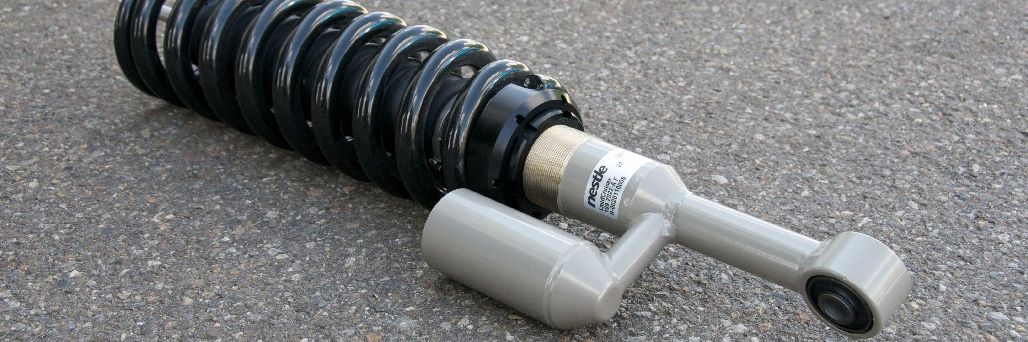

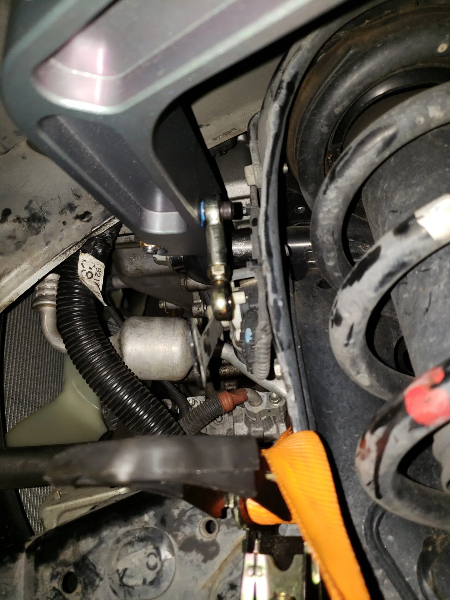

Upgraded AHC suspension..
Larger AHC shocks? Ooooh. Tell me more. Do you by chance have a part number for those?
Those are the fronts. I'll take a pic of the rear ones and post by next week..
Made for Toyota Nestle in Germany..
Equipment Land Cruiser V8: OFFROAD-NESTLE
More oil, more damping..
To be used when you add a static load of 1200+ lbs. I think if you add two bumpers, a 40 gallon tank, drawers, and other gear you need those.
Nestle has diversified beyond food and drink into higher capacity AHC shocks? Interesting.

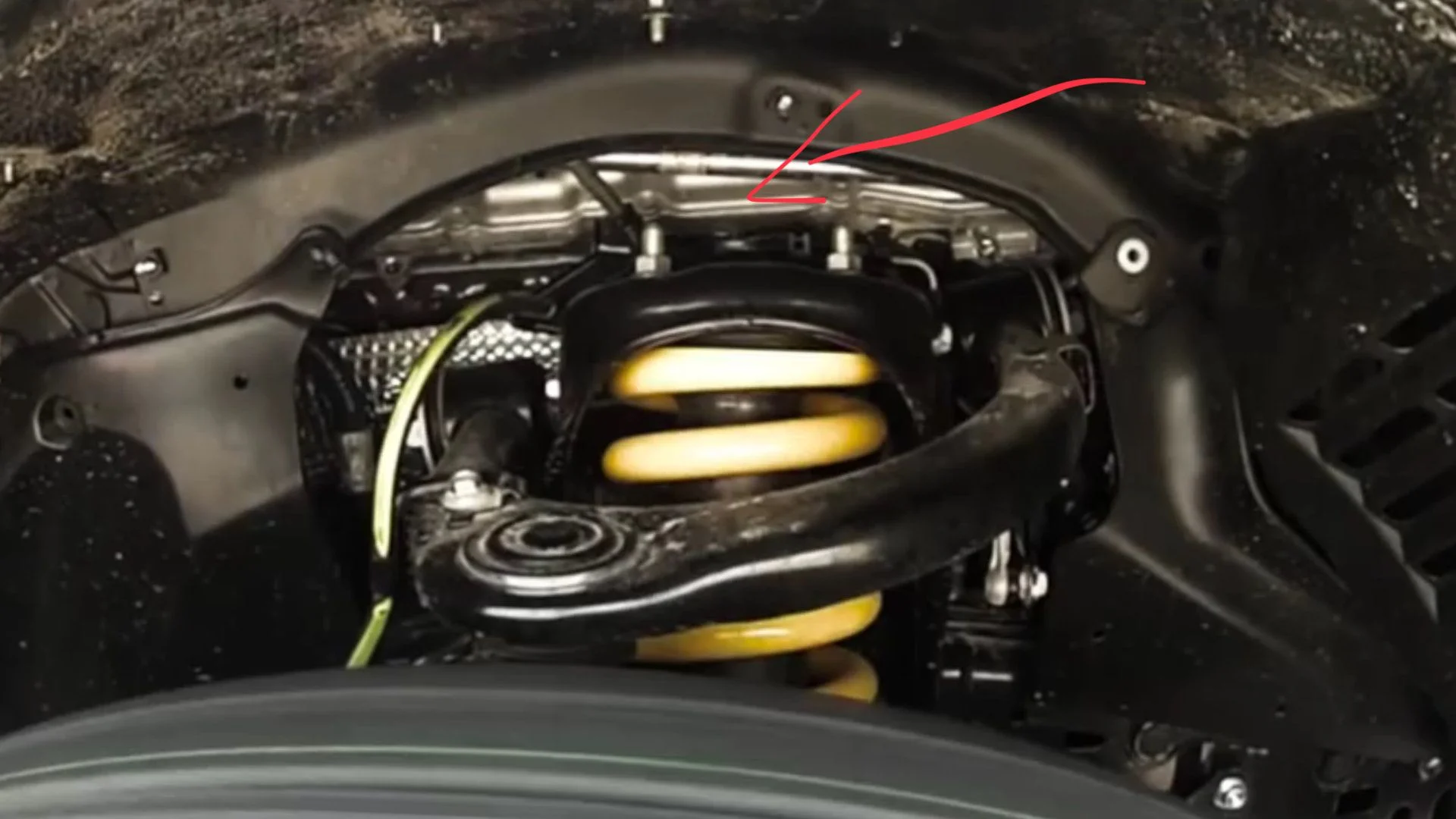

Here's another on an armored LX. Luxo-battle wagon.
Here are the screenshots from that video — agree, the AHC “plumbing” at the top of the shock seems to be missing, suggesting it’s an LX running on LC non-AHC “heavy load” suspension components.

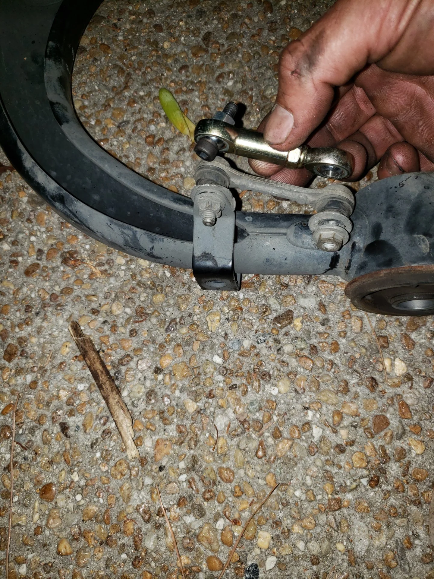

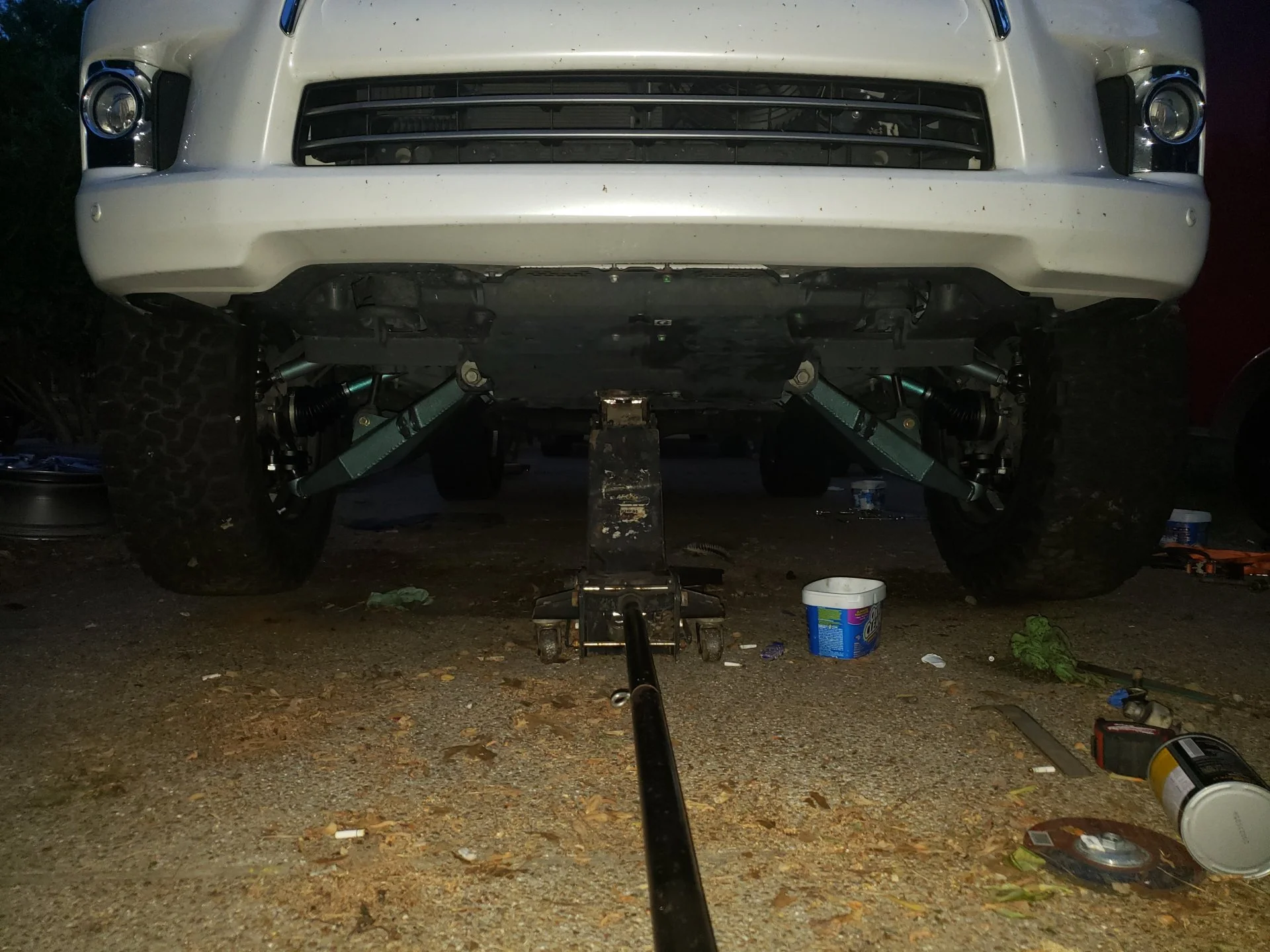

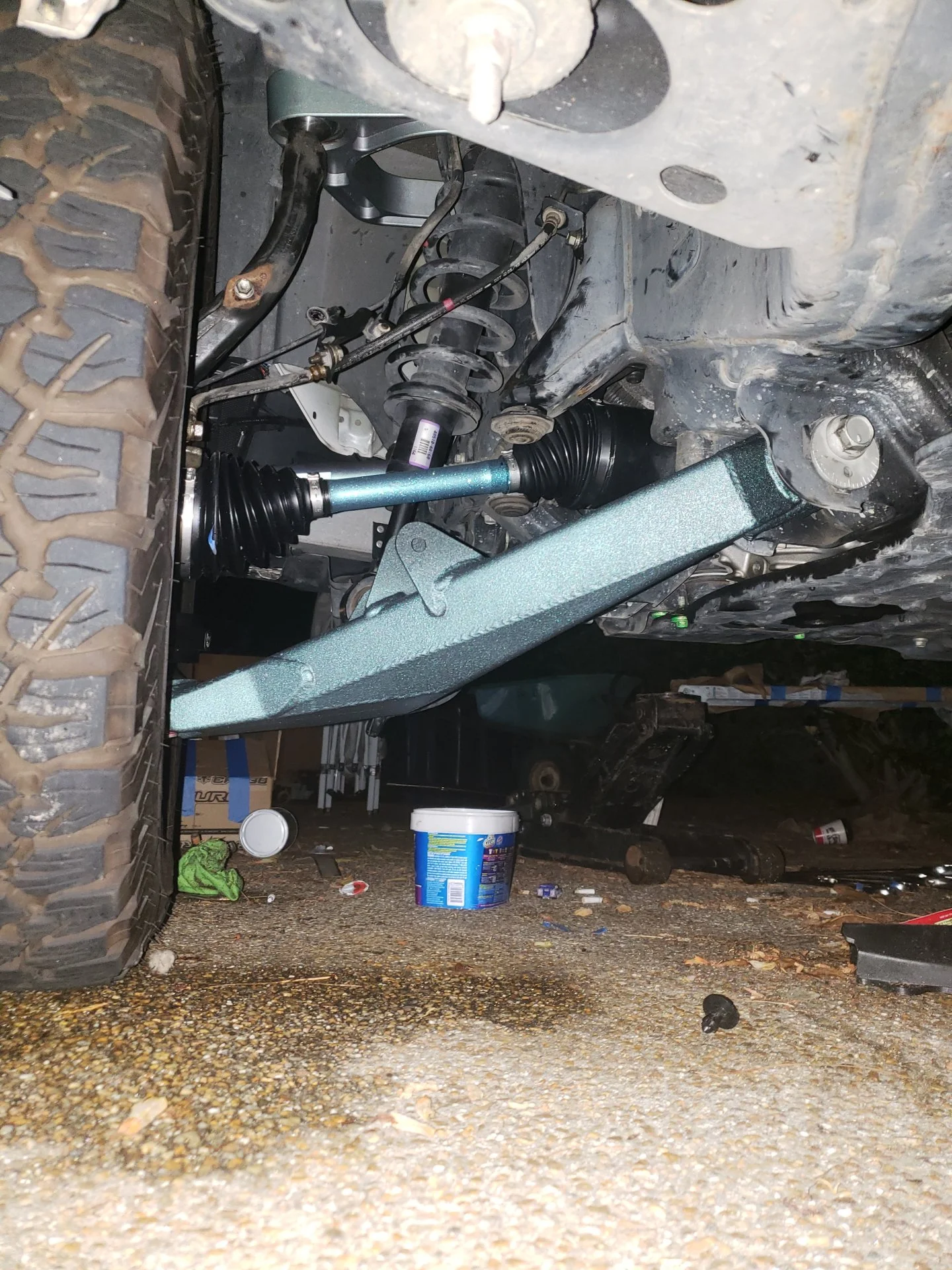

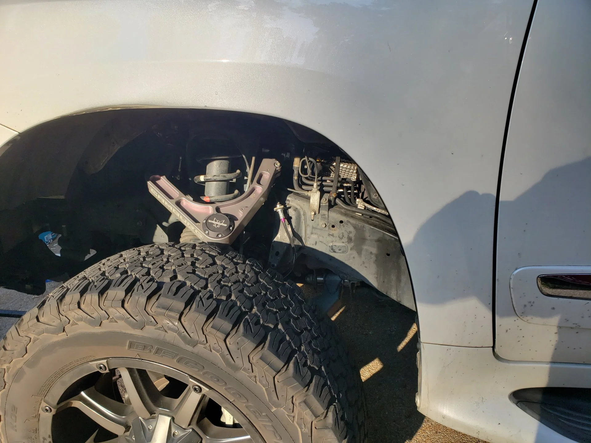

Hey bud..... if you are able I need info on these. Only thing on web coming up is this thread. I did a long travel kit with my ahc 2 weeks ago and didn't know of this product till today someone mentioned these on my thread ;long travel lx570.
Id like to know specs as far as length and travel compared to stock... or even just a link where I can order.
Thanks in advanced

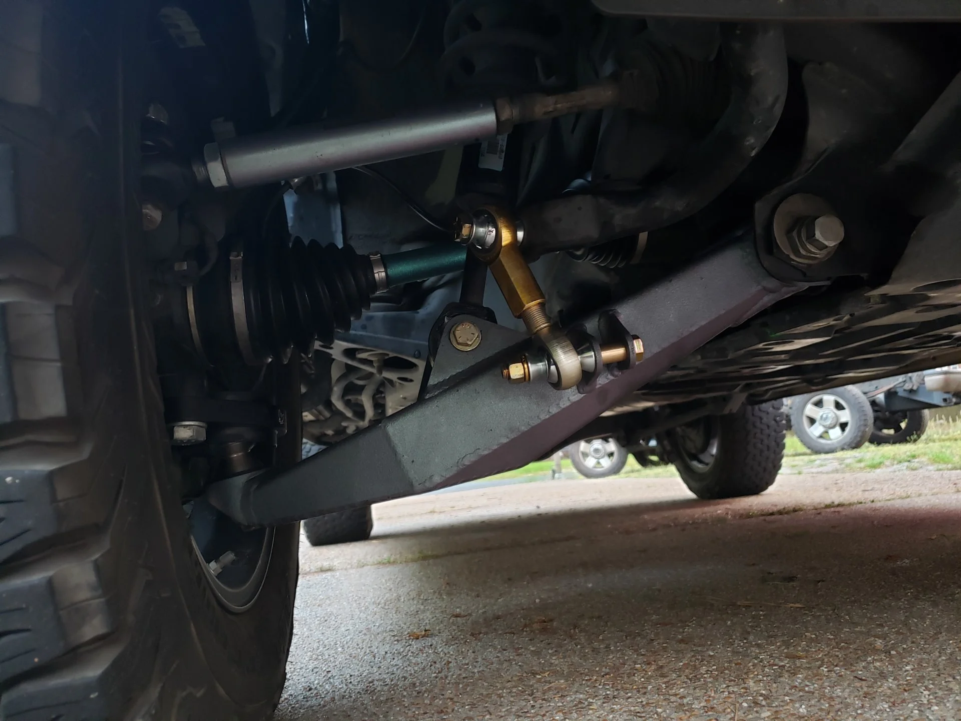

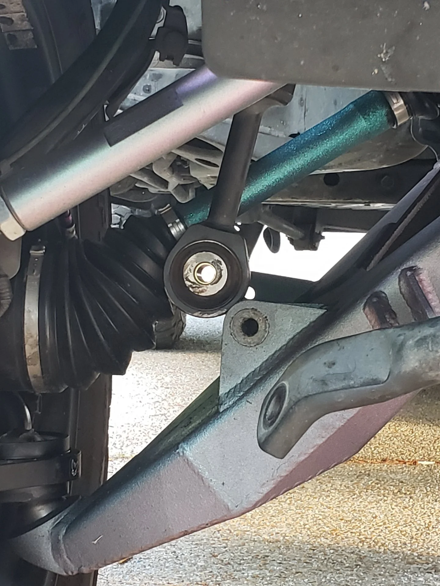

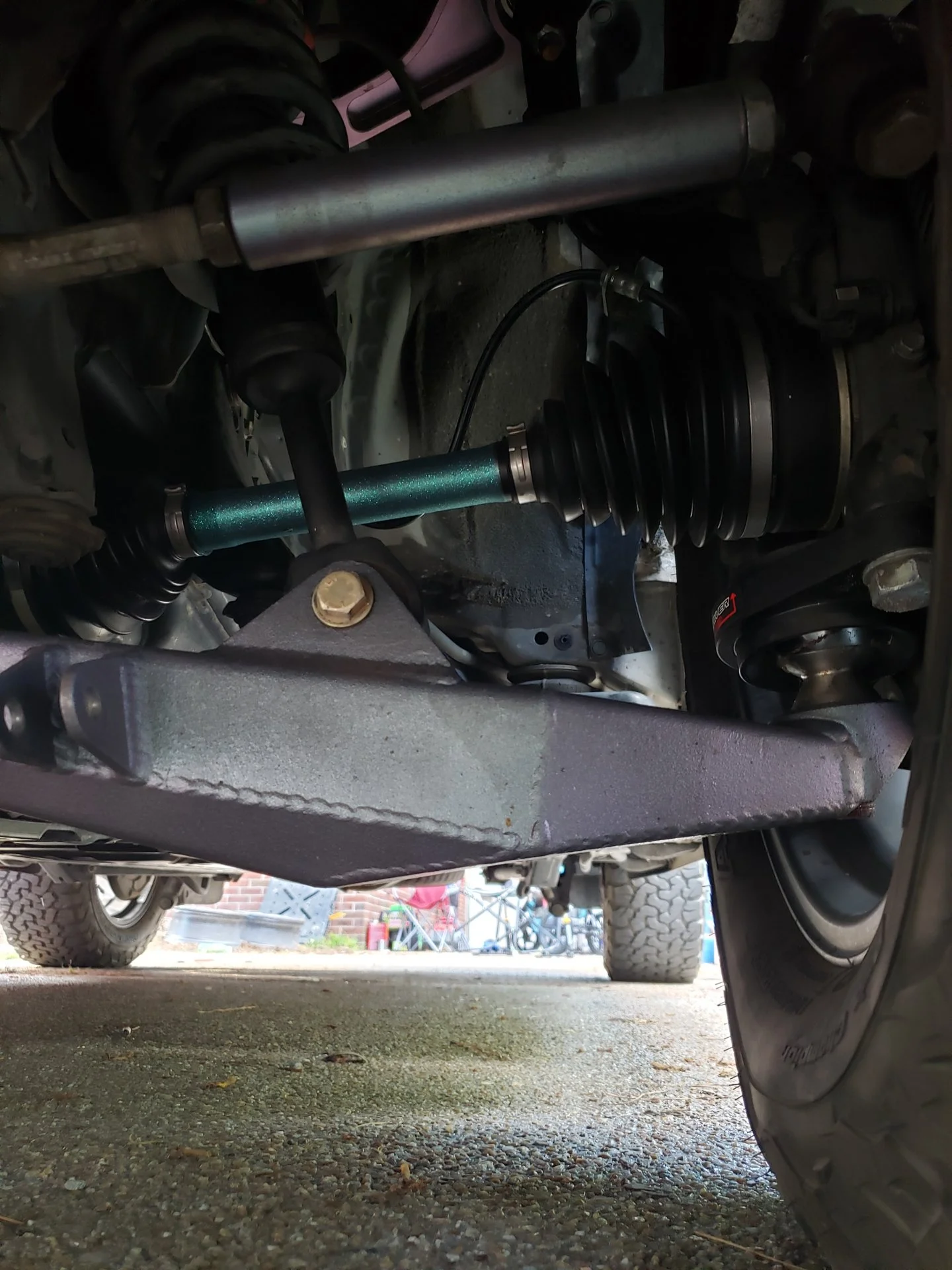

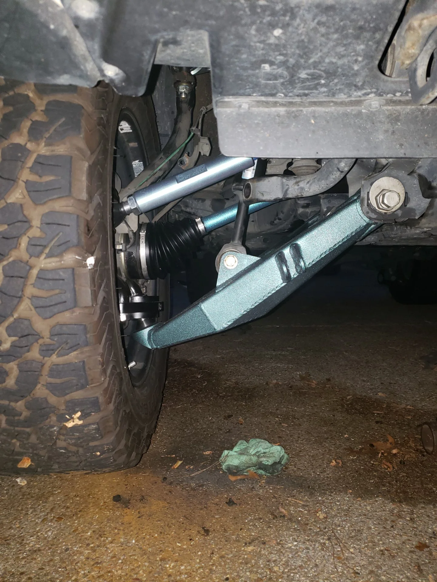

Is it just me or does the CV angles look extreme?
Its tolerable....
Your seeing full droop maybe.... yes thats extreme...I have a 1in diff drop to install when I find time... but am considering the 1.5 from aus cause my droop is crazy. Rcv's being ordered soon.... they'll handle whatever i can throw at it... and I'll carry stocks as a spare on the trail.
Thanks in advanced

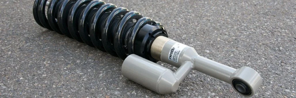

Linky:
Art.-Nr.: NSAHCTOYLCV8
Those are for extra weight, don't think they offer longer travel.
Haven't installed them yet, so can't give you an opinion.
Am out of town, but when I'm home I can measure them for you if that helps. Also, maybe talking to Patrick at Toyota Nestle is safer, if what you're after is travel.
Nice work by the way, respect. I've replaced the rear coils with the stock LC100 ones, front is stock.
Linky:
A fully extended measurement would be greatly appreciated. Yes considering calling over there but wasn't sure if they spoke English or how international calls work. I appreciate the kind words.... its been a bear but finally seeing the light at the end of the tunnel
