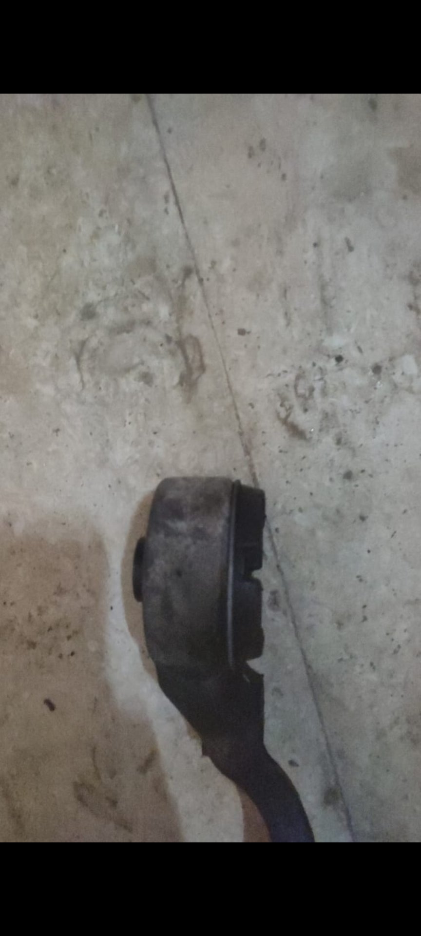

Febest part # TAB 332 is the replacement rear bushing.
Link to Amazon here.
The rear bushing and front bushing is the cover are different.
