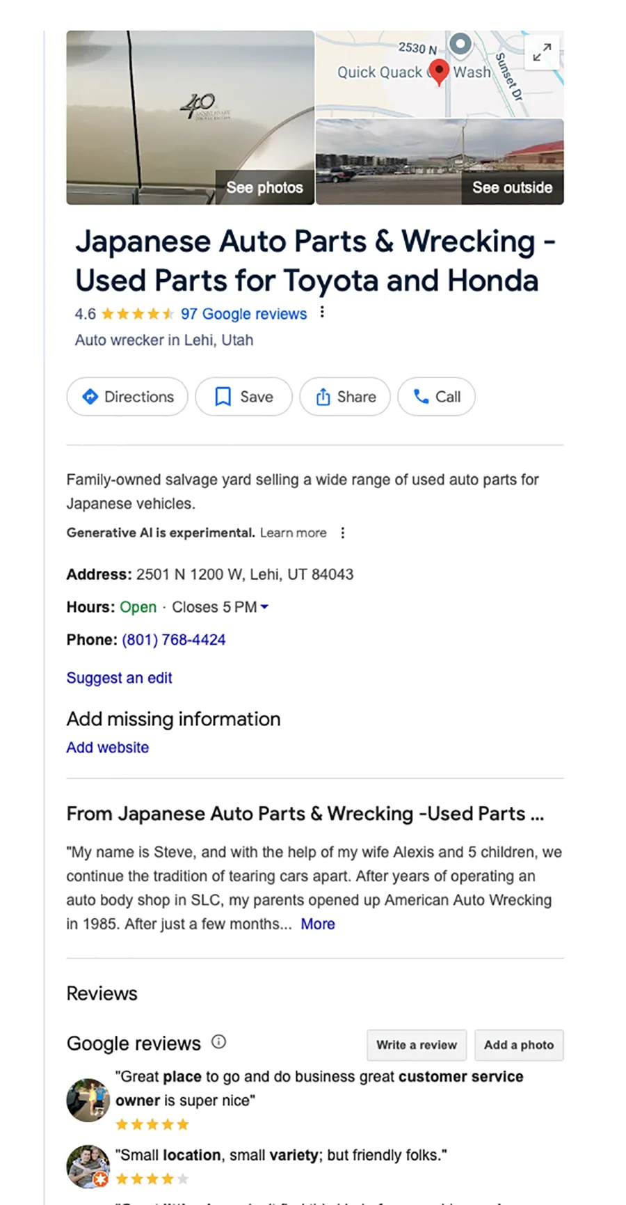

So there's used and new options, obviously.
Cruiseryard might have a used/known good one available
Or this guy:
