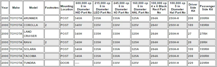

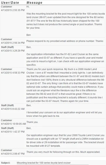

Just updating this for anyone who might be interested in a Unity spotlight for a 100 in the future. I got in touch with Unity, they were actually very helpful and quick to respond. UnityConvo.webp They didn't update the specs for the 100 series from the 80 series until 2003. UnityChart.webpSo if you order a light and installation kit for a hundy make sure it's one for an 03-07 without side-curtain airbags.
If the pics don't work: Application engineer at Unity said for my 2000 TLC a light with an O length shaft and 29RH (driver side) installation kit will work. So the common halogen would be 330O. He also said template 8127 for placement (included with install kit).
