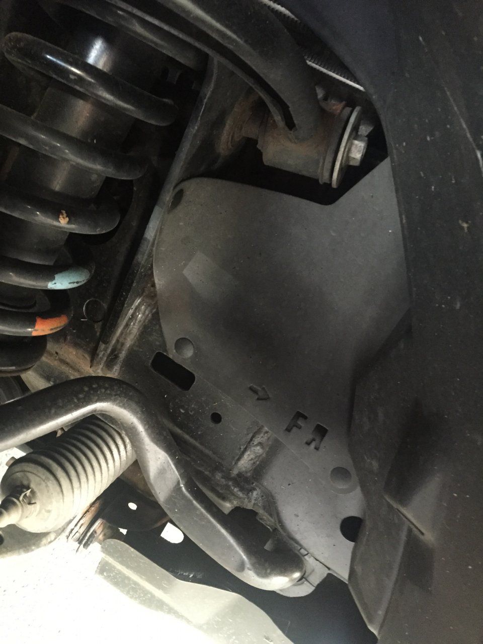

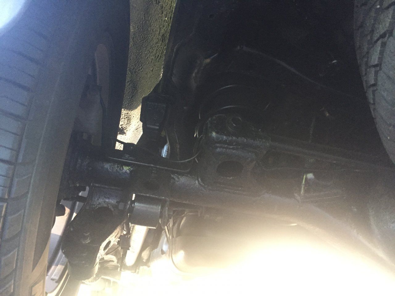

So been a few questions on this and I figured I would share. I took some after pictures of my wife's 2007 4Runner. Came out great. Used rustoleam rust solver and chassis saver after some wire brushing. Did about 4 months ago. Did notice some spots that need to be touched up but very easy and cheap

I agree but the paint I used was rust resolver that is supposed to stop rust and convert it to a paintable surface. I then used chassis saver over it.
Plus now the truck is ten years old. So if I get another ten years out of her I will be very excited.
I will keep an eye out on the truck and keep after her. I did clean it before with a wire brush and all purpose cleaner before using any coating.
