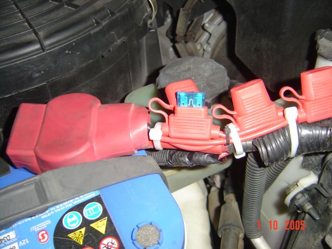

I can't get why Toyota didn't have such a simple thing.. I've contemplated installing one for a while but didn't actually decide to do so until recently..
the mod is quite simple and cheap.. all parts can be easily found in any junk yard.. the light bulb and holder came from an old dodge.. no drilling was necessary in my case :)
light is fused and connected directly to the aux battery.. it will light up without the need to have the key in the ignition..
Momentary push switch is used to turn of the light once the hood is closed..
the light is installed on the same screw securing the bug deflector.. I can't remember if a hole was there or it was drilled for the deflector..
the light from this bulb is sufficient to lighten up the whole engine compartment.. I don't know what kind of bulb it is as it came with the holder..
cable is passed under the the hood insulation..
the light bulb comes down into the space behind the grill when the hood is closed..

Siglo, you seem to have a lot of inline fuse setups in the engine compartment. Have you thought about putting in a fuse block instead?
John
@97 FZJ80
I thought about getting a fuse block.. but haven't been able to find one locally to my liking.. Stopped by the electrician the other day and he showed me a fuse block that came off an old corolla.. it was slim and would fit easily under the hood.. but I didn't take it cause it was missing the cover.. Buying it new would be costly cause the dealer would only sell it with all the wirings etc..
if you know of any place online that sells small fuse blocks online I'd appreciate it.. I seem to be running out of good space under the hood lately..
http://www.waytekwire.com/ is a good place to find all sorts of decent quality electrical cables, connectors, fuse blocks, etc etc. They do have minimum qty on some items...
george.
thanks george.. I've looked at that site and I'm already considering a couple of options :)
