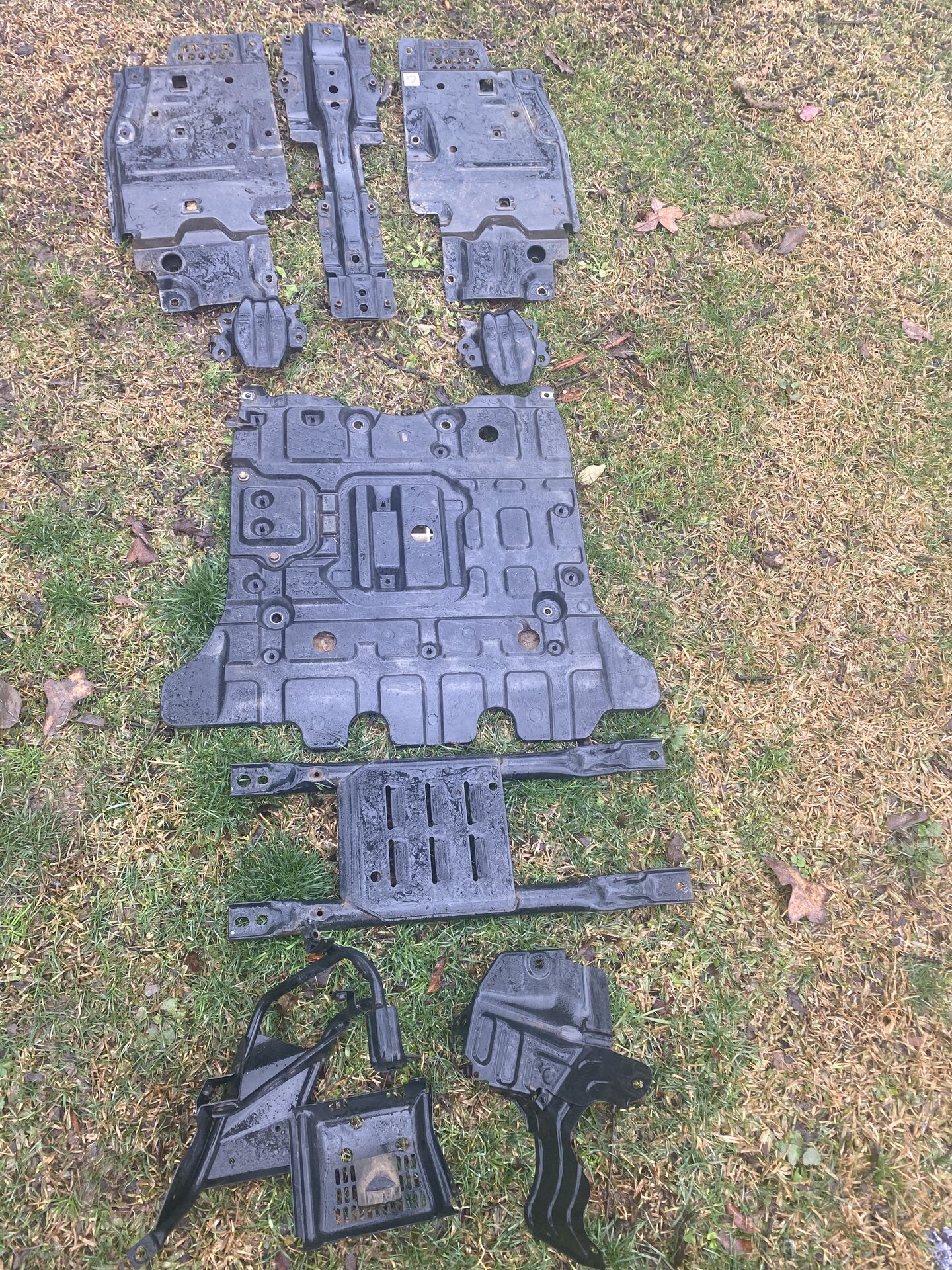

Here's a pic of all the OEM pieces, just to give you an idea. This is what I removed when I installed my skids. Depending on how much they are wanting to replace, there are quite a few pieces. But you can see how the price could add up. I wouldn't be surprised if their quote is just for those top 3 pieces. I shipped these all to a forum member for the cost of shipping. You might throw a "wanted" add up in the classifieds. It's also a lot of bolts to deal with depending on how many are rusted in place.
Although, as said above, I wouldn't bother replacing any of this stuff unless I got it free. I'd buy something light and that still allows easy servicing.
Any idea what the total weight of those pieces are?
In the box I shipped them in it was 42.4 lbs. That included an incomplete set of bolts. So probably have to take a few lbs off for packing and bolts.
