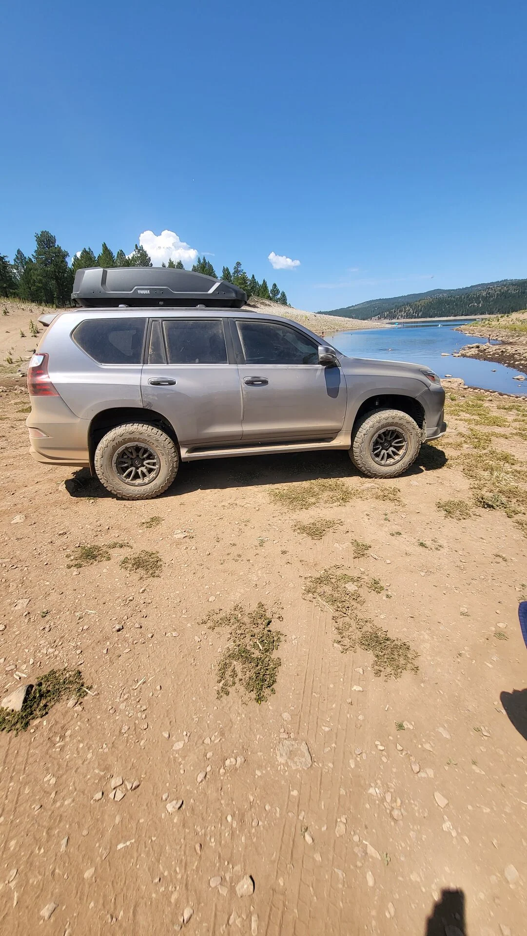

Hey everyone! I have an upper control arm question. About 10 months ago I put on a stage one icon lift and it's been great. No issues thus far and I am loving the ride and look. However, I feel like I'm regretting not going with new upper control arms. I went with 285/70/17 KO2s and new fuel wheels.
My lovely wife gets an nice bonus every year and this is where I make a play for some new adjustments to the GX. There are of course alot of things I would like to do but something makes me feel like I should upgrade the UCAs. Ivetbeen a part of these forlusm for some time but still learning. Am I gaining anything by upgrading the UCAs or should I try and spend my money elsewhere?
I do not offroad often. I take it to Idaho twice a year and hit some trails and BLM land and ride fire trails and such in Tahoe at times.
Thanks in advance for any feedback! Here is how my GX currently sits.

FYI my 460 is +1.7" and was easily able to achieve stock caster specs during alignment. Yours looks lifted more than that. What is your current caster spec?

But yes, my rig is substantially more lifted, albeit, it may not show because of all the gear I have on it and I'm running 35" tires which will make a lift look not as high.
