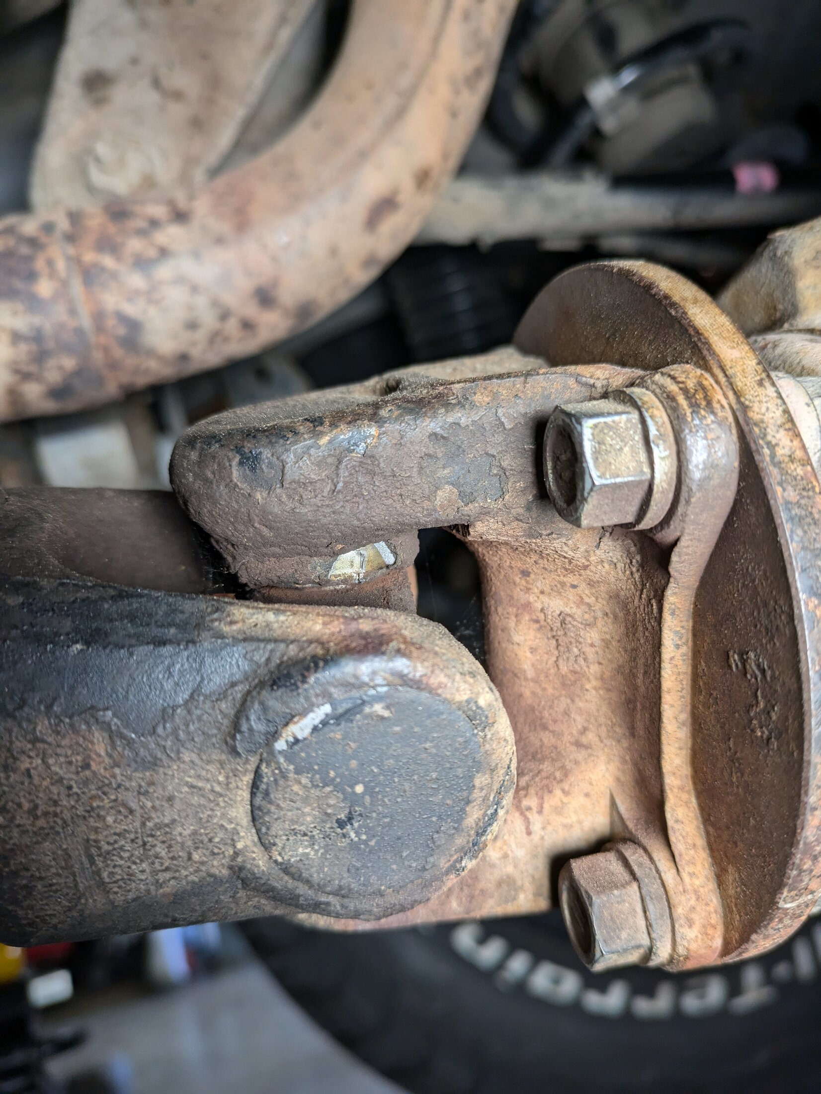

While replacing my shocks I noticed something off...
The truck is at 270k and I'm trying to decide what makes the most sense. U joints and replace the flange? Or just replace the whole driveline?
That crack is on the U-joint cup and not on the flange. Stay with OEM U-joints and never anything else. GMB and all others are junk.
Buy a new drive shaft-
By the time you buy new Toyota ujoints (don’t use aftermarket here) , have them installed ( which often times is poorly done) , then have the drive shaft balanced youre not far from cost of new ( from one of the online dealer sites).

Do you need to rebalance if just replacing the ujoints? I would have thought they are inherently balanced on the center of rotation, but I’ve never changed them. On my short list.
One shouldn't need to rebalance if the u joints are property installed per FSM. For the OP, there's also the slip yoke for consideration. If that has excessive slop/wear I'd get a new driveshaft. Otherwise new Toyota u joints and keep on trucking.

No, you don't have to balance the drive shaft if you are installing OEM U-joints. I have changed U-joints on our hilux, 4runner and few other cars and no vibrational issues.
As other said no need to rebalance. But in case you do replace them: mark very clearly the positions so you put everything back in the same place.

I was chasing a vibration on the rear driveshaft and changed the u-joints. The vibration worsened! It went from vibration sometimes to vibration all the time. Had it rebalanced and all was fine. Perhaps the loose joints were masking the vibrations! Ha.
