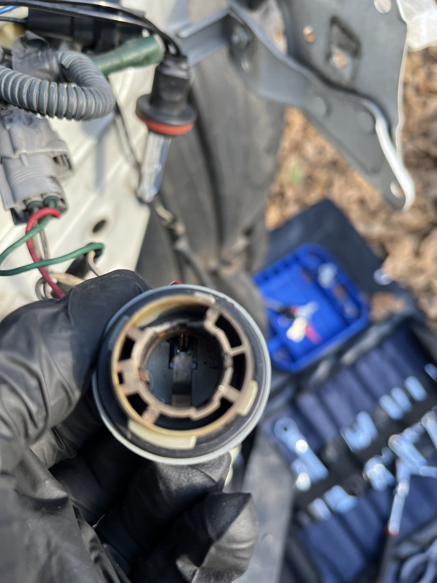

Found what I think is the culprit.
Hard to tell from the picture but the inside is super corroded. The bulb wasn’t shot, but it was burned to hell and stuck in the socket.

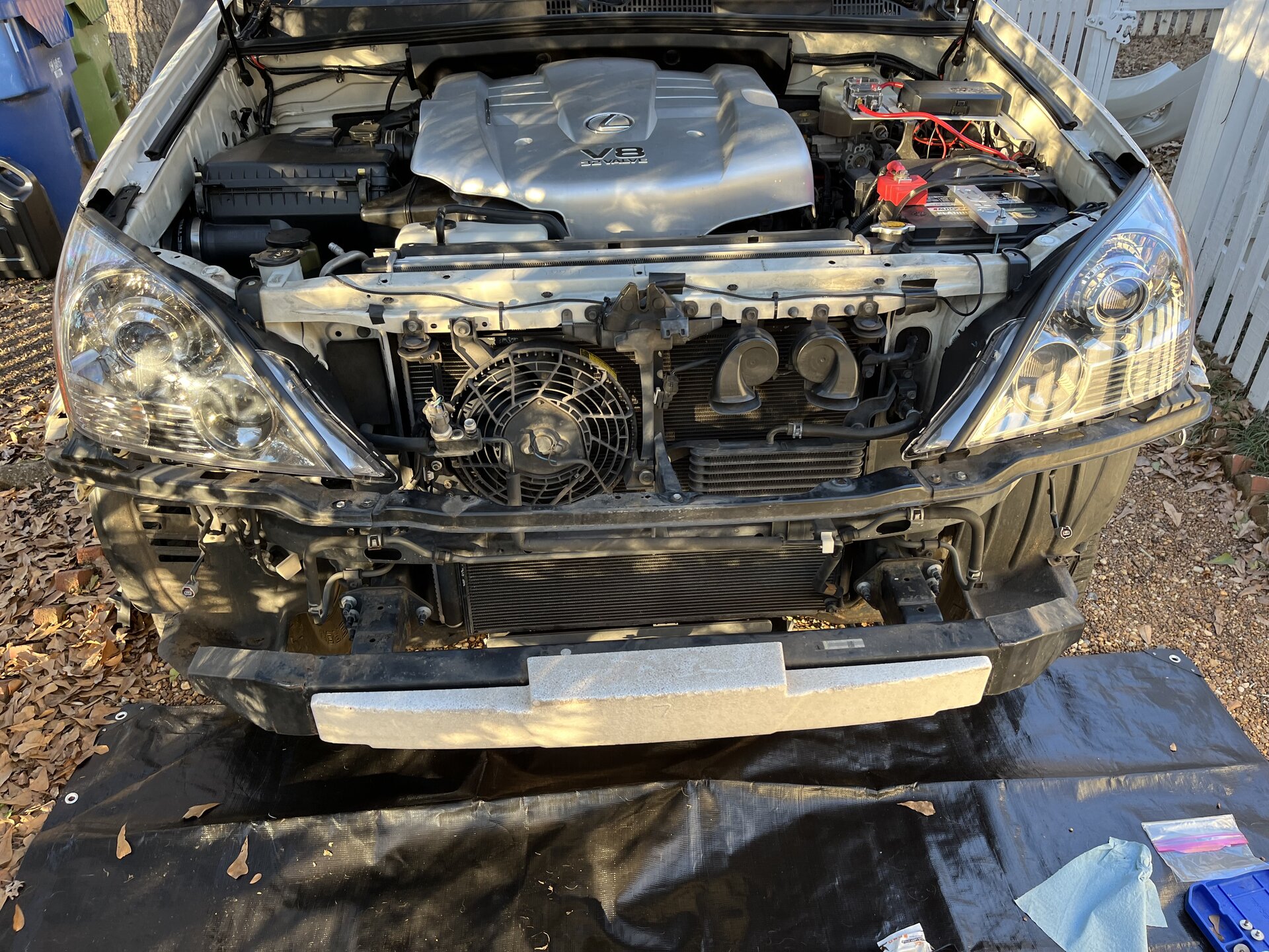

Found 2 new harnesses at a local Lexus dealer. Got the bumper and headlights off. So I’m just gonna replace the harnesses and all the bulbs.
Knocked it out today.
Spent more time in Atlanta traffic hitting 2 dealerships than I did on the replacement!
I replaced bulbs way back when I first bought the GX, and, honestly, I wish I’d just pulled the bumper and headlights that time. So much easier than trying to wriggle my hands up from underneath the truck to get the side marker bulbs. Figure I can pull the bumper and headlights in about 15 minutes at this point.
