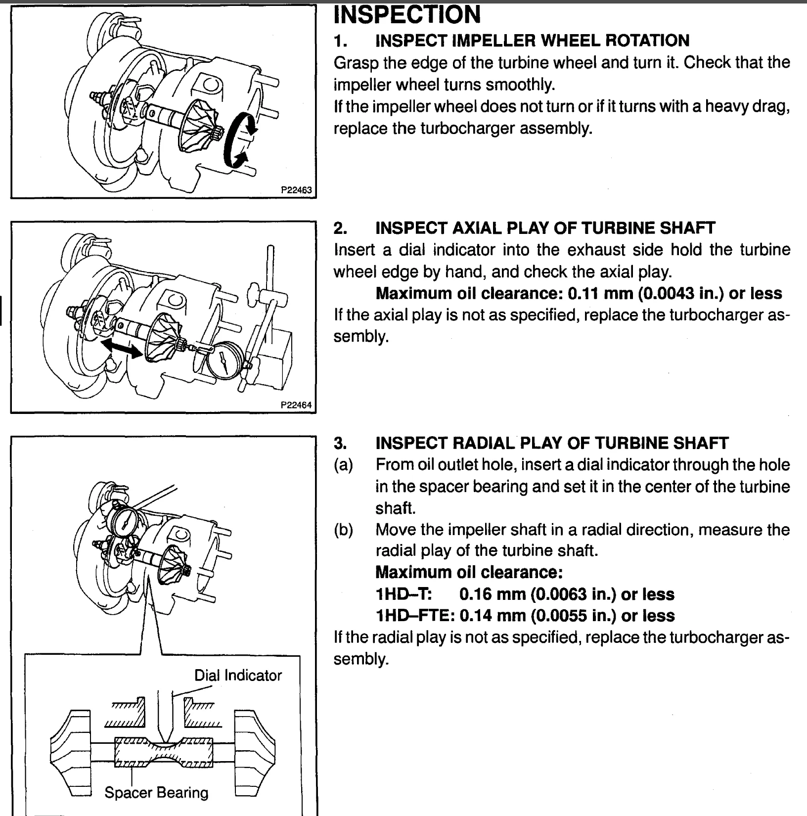

The Toyota FSM for 1hdt shows how to measure radial play. You measure it at the centre of the CHRA, not at the compressor wheel.

Better measure by Toyota guidlines

Incorrect, up and down will always have some movement due to how the bearing works. There's an allowable tolerance for both axial and radial play as specified by Toyota in FSM. The specs for the CT26 allowable play is 0.13mm axial and 0.18mm radial or less.
Hmm... ok thank you. How does one go about measuring this?
