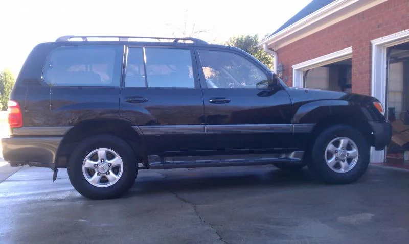

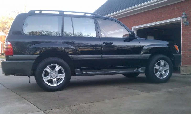

It was time for new tires and I went ahead with new wheels as well. I was looking for 18" wheels off a 2006-2007 but couldn't find any. The new wheels are Tundra 18" wheels and the tires are 275/65/18, which makes them 32.1". The old tires are 275/70/16, which makes them 31.2". They fit without any modifications or rubbing. I did use my old center caps as the new ones won't clear the front axel. Caps fit perfectly without any trimming required.
Within about a minute of posting I had some pm me about the old wheels. I mentioned them here but I guess that's not allowed. So, I have a post in the classifieds for the wheels if interested.
How's the ride? Some say they can tell a difference with 18s some can't. You?
The ride is a lot better, but I think that may have more to do with the tires. I went up 1" in tire size with no noticeable change in power. I wasn't sure they would fit until I actually put them on. I was surprised to find out that the center caps work without any modifications at all.

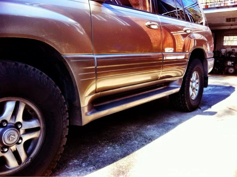

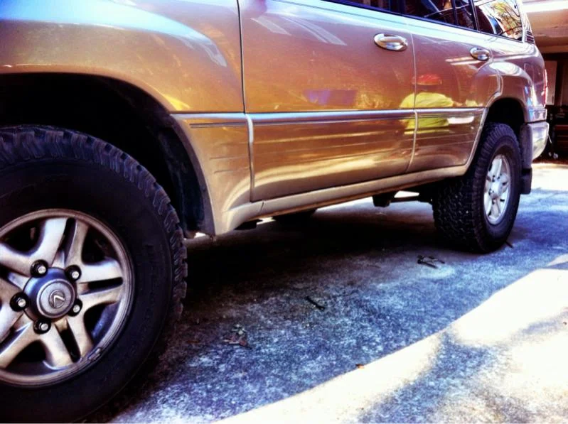

See photos. Had 8 bolt/screws on each board.

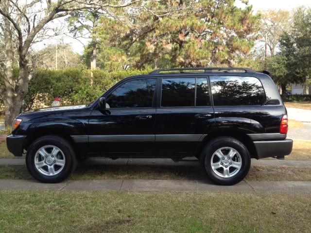

Here is what mine looks like.......
What percent tint is on your windows? Does the front match the back or does it look different in person? Mine has a bronze color and I've seen pics with tint that makes the rear windows look like mirrors. Was yours untinted or did you tint over the factory bronze tint?
