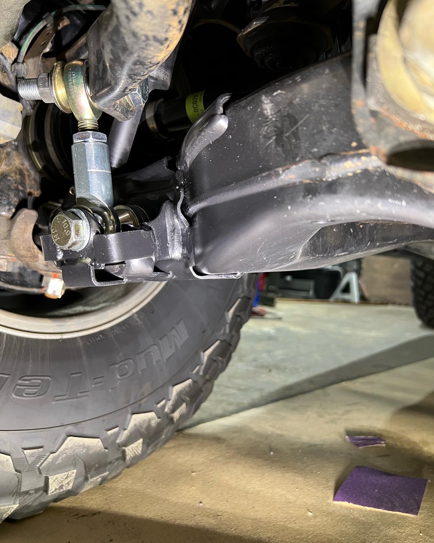

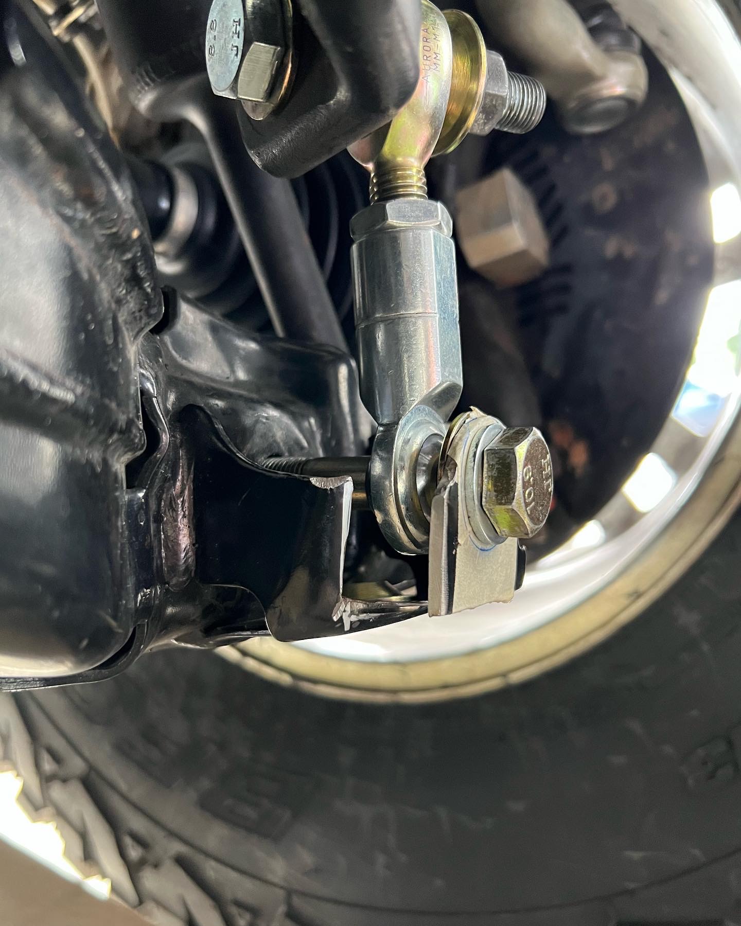

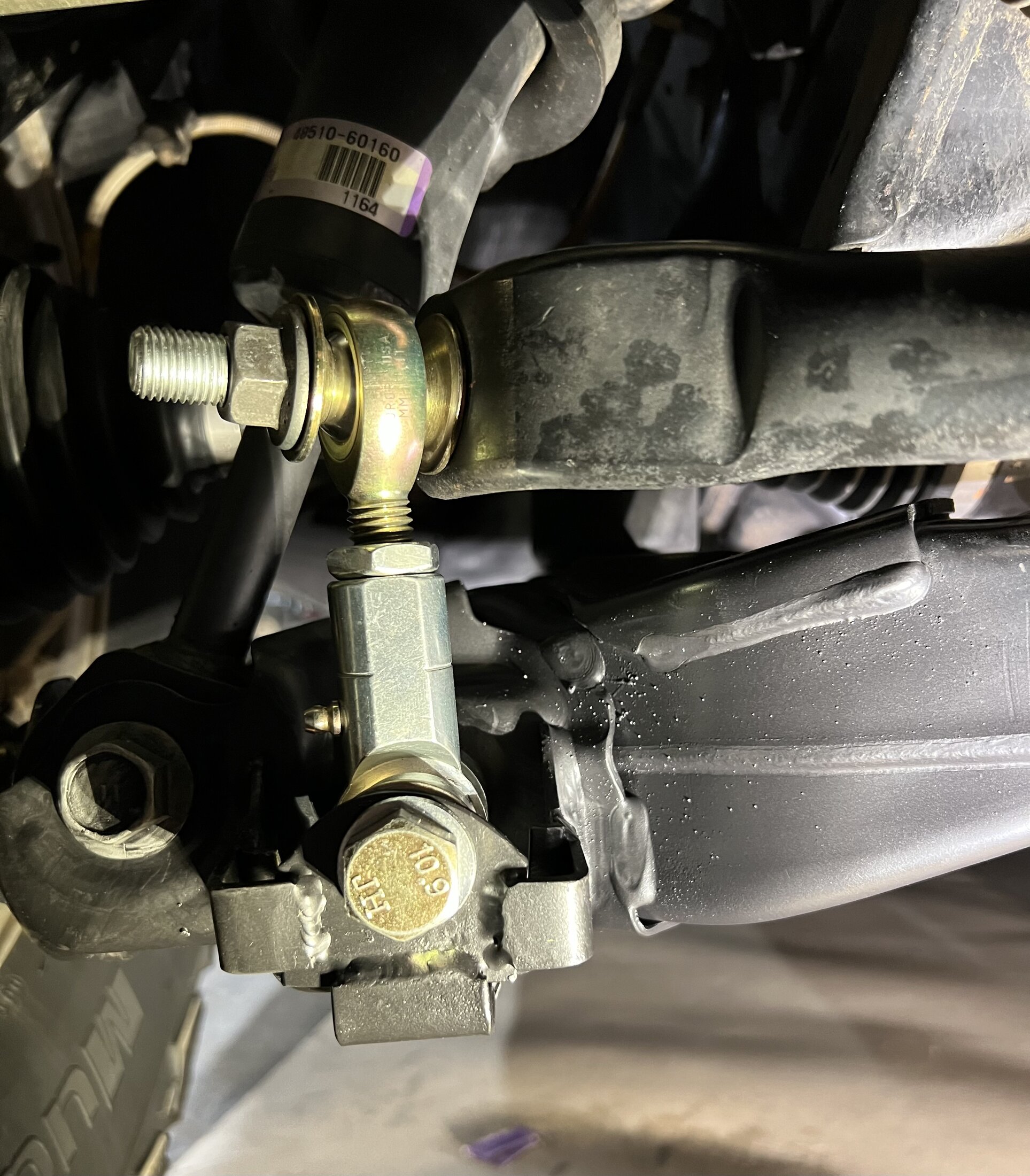

On my LX, I ended up running my endlinks outside the swaybar due to the bucket being moved out towards the wheel. By swapping sides on the bar, then cutting and moving the bucket outwards, I was able to have the links vertical at ride height.

here’s the ugliness. I did it wheels on the ground. When it comes time to do it fresh, I’ll cut the bucket and weld a full bracket on the arms before installing. Some 1/8” steel and a solid tig weld on both sides and below, and it’s held up

Thank you, yea definately going to take your advice to do that before installing? Thats roughly an inch out? And did you make your endlinks or is there a kit you ordered for that.
Thanks
Thanks
I think you're right that it's about an inch. I got all the heim parts here, including safety washers. I used a variety of high offset heim spacers as well on the lower arm to give the greatest articulation I could.
