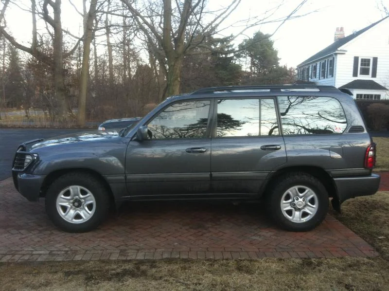

I know that some folks have installed Tundra steel wheels on their 100s. Can anyone give me a summary of which ones fit and which ones don't. Here is a source for 2 different styles:
Tundra Steel Take-offs
Well I can tell you the five spoke steelies work quite well. Considering they are currently on my truck. Stock tire on those are 255, but I still run my 285s on em.
You will have to modify the stock center caps (or use LC stock ones) which I never bothered to do.
I have a set of the second ones pictured. They fit just fine. Keep in mind they're heavy. Unless you're close to Onur, you might do better on CL since shipping these would add some coin. They also don't help your MPG at all., even with street tires. Oh you should get new lug nuts for them as well as they are lug-centric, not hub-centric like the alloys.
Typos sent from my HTC EVO using the IH8MUD app...
Anyone have a recommendation for new lug-centric lugnuts that fit the posts with these wheels?
