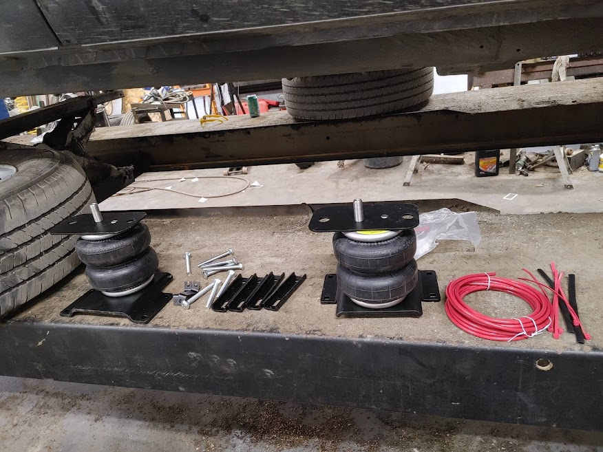

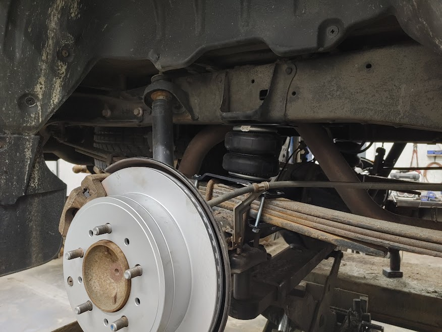

Put bags on my Tundra a while ago, just getting around to posting it here
Went with the firestones with just a simple air line out the back. No onboard pump at this time. f2445 kit. Install was easy peasy. I did have to cut off the factory bumpstop. I run 8 lbs empty and 25 towing my trailer.

I have the same setup on mine. Works great. I don't find the need for onboard air. I have a leftover new in box arb small compressor that came with a kit I've thought about installing and wiring up. But it's pretty fast and easy to just use a bike pump or shop air.
It does make it a bit tricky to estimate the load though. I pulled my enclosed trailer and had the bed full of stuff last summer and it felt kinda heavy. I think I was really front heavy on the trailer too. So I ran through a cat scale. Iirc I was at 4,850 lbs on the rear axle of the tundra. Without the bags I probably would be on the bump stops. It handled it great for 500 miles in the mountains.
I find that my little oem Bilstein rear shocks are not enough though for the weight it'll handle with the airbags on three really rough highways with things like frost heaves.

I had the same bags on my 2014 DC.
Keep a close eye on them... Yours appear to be the offset ones
Look at them from the back and see if they are sitting square to the spring, or offset a couple inches.
Mine were offset and i bent the hell out of both brackets and had to custom fab a fix.
Just an FYI
