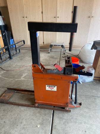

Not sure what the pieces are that are missing or if available at a decent price. But not being able to dismount the tire is huge. If it was complete would probably buy it just to dismount tires. Being able to dismount is a must. Would be nice to mount them and then has a shop balance.
This should work for dismount.
Huge difference between $60 and $300. Lot of money to spend to dismount tires. Bought the HF tire changer mainly to dismount old tires off of rims I want to keep. Did Google the Coats 220 tire changer and see it's for motorcycles. Add mentions missing clamps for car and utility wheel. Doesn't sound like it was meant for cars much less SUVs. Switching around tires on vehicles. Putting usable rims tires on my rollers. That will give me at least a dozen tires to dismount. Have a few other very old cruisers I may part out. That probably another dozen tires.
