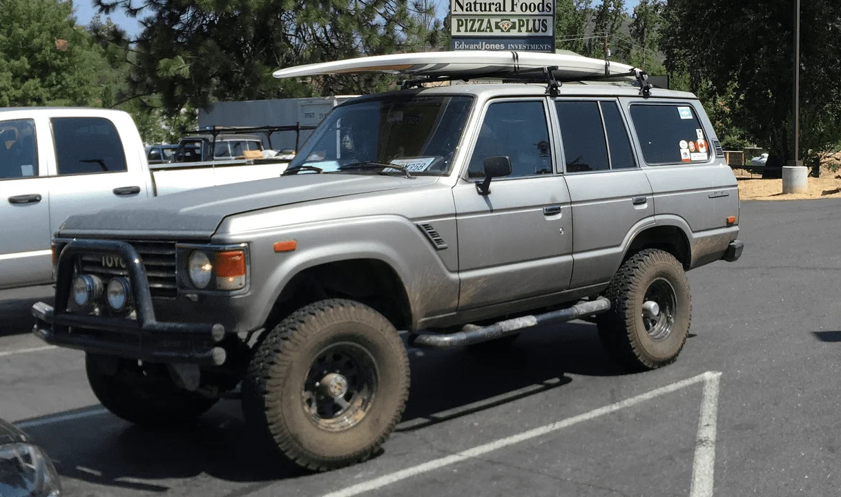

Didn't do a ton of mods since it was in good shape but we took it camping and skiing a ton. Lo and behold, Truck2 got stolen from the same spot as my pickup! In my mourning and slightly irrational mindset I decided I needed to replace it ASAP. Had to be a V8 and had to be rust free. After a short while I found Truck3 in Bakersfield. 1986 fj60 with a 350 in it. Had it inspected and drove down to check it out. Hardly any rust, 4wd worked, drove ok and I bought it. Truck2 was found about a week after I bought Truck3. Ugh. My insurance company was no help either, but eventually we worked it out. I wish I had known what I know now though.... Here she is:
Minimal rust, Chevy 350, lifted, bedliner on the inside, stock 4speed mated to an overdrive, baked in the Bakersfield sun it's entire life.
