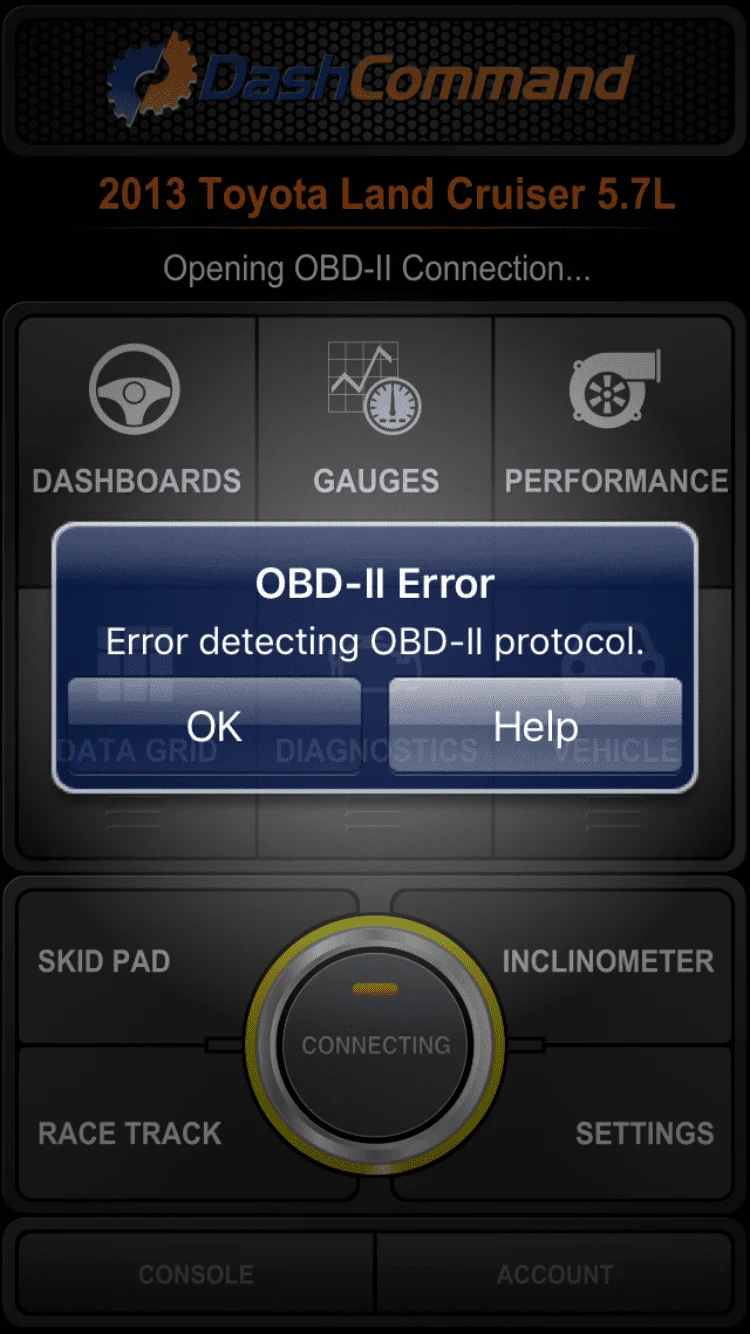

I have pulled codes several times when the 2013 would start without problems. I have tried to connect with 2 different OBD II scanners without success.
If the vehicle won’t start, what magic combination of button presses that gets to “on” if the engine won’t turn over.

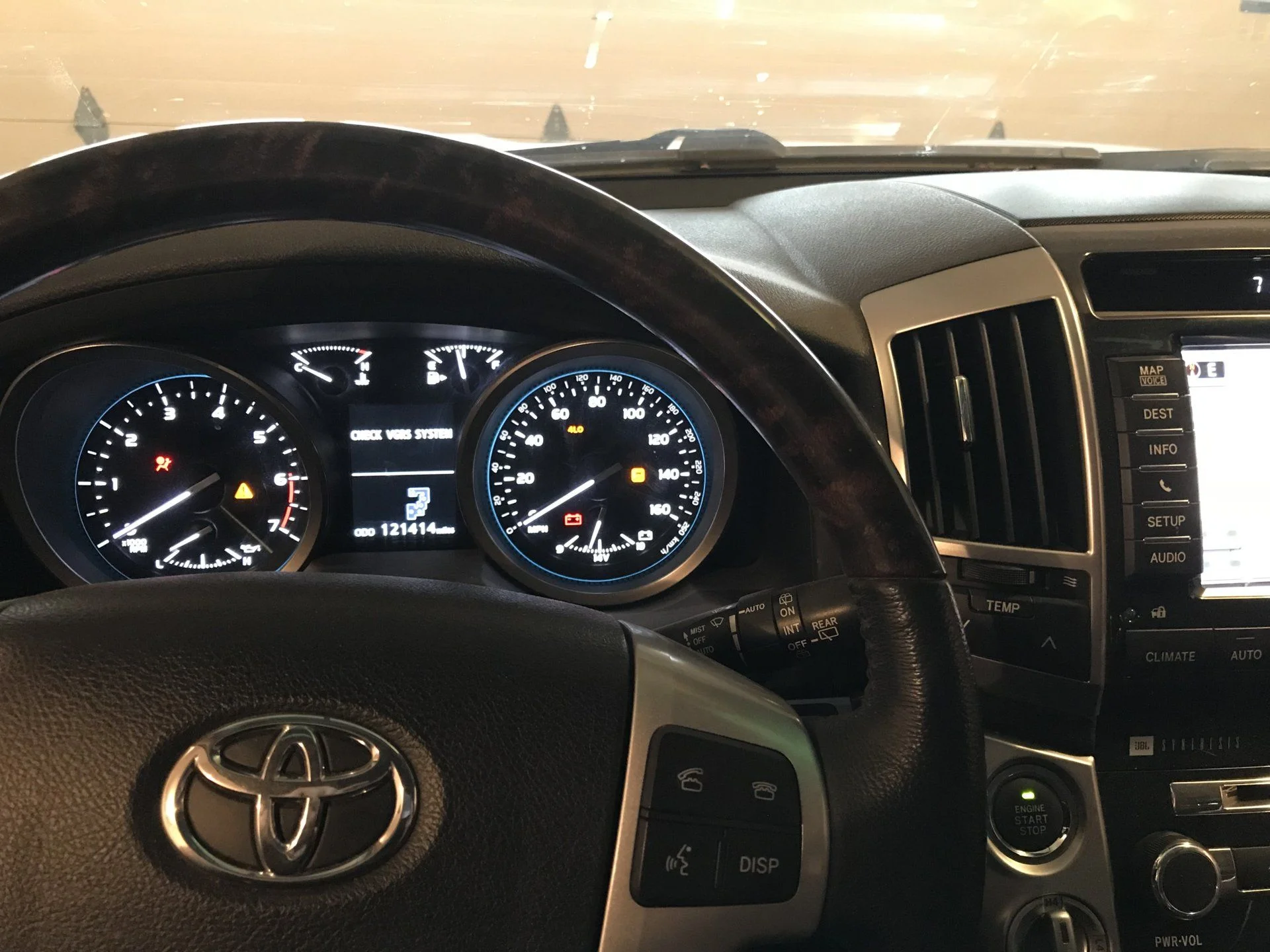

I have attached a picture of my dash when I tried pulling codes, it “looks” like it’s on.
Also a picture of one of my scanners, it recognizes the vehicle, but can’t pull codes. (UPDATE - it doesn’t recognize the vehicle, it just a showing the info for a previously saved vehicle in the app)

Seems like from the images that the reader is physically recognized, the ignition is clearly on, but the ECU might not handshaking. If you have not already, I think I would disconnect all battery power for at least 30 minutes to try to reboot things. Might even uninstall and reinstall the reader program which I presume is in a phone or something. Just curious, does displayed voltage jump when you go from ignition on, foot on brake and push once more to start?

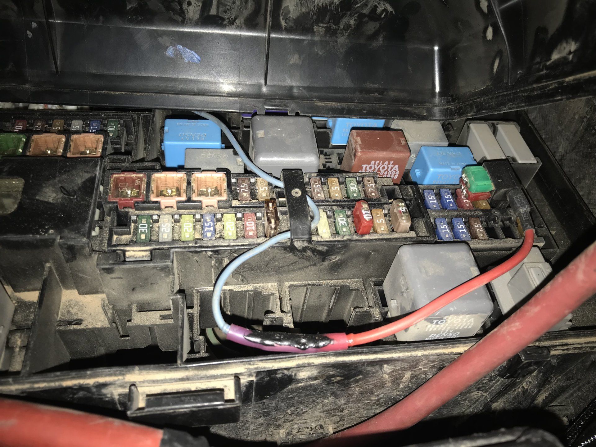

A 10 amp fuse!
The SwitchPro has a fuse tap to the ignition, I rerouted the wire between the fuse box and the SwitchPro and plugged it into the wrong slot. (In my defense I didn’t install the SwitchPro and it was surrounded by 3 blank slots)
