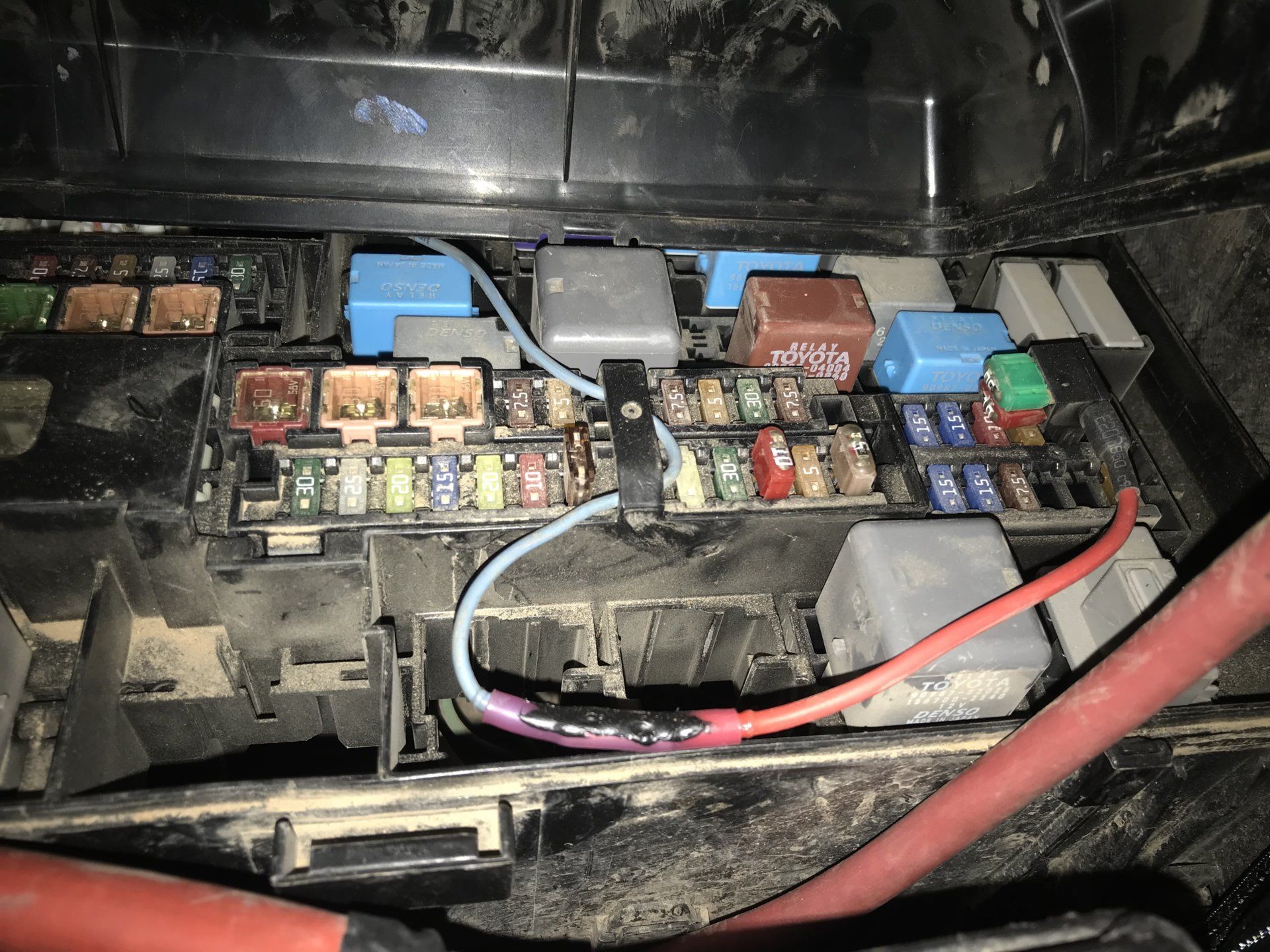

Solved!
A 10 amp fuse!
The SwitchPro has a fuse tap to the ignition, I rerouted the wire between the fuse box and the SwitchPro and plugged it into the wrong slot. (In my defense I didn’t install the SwitchPro and it was surrounded by 3 blank slots)
