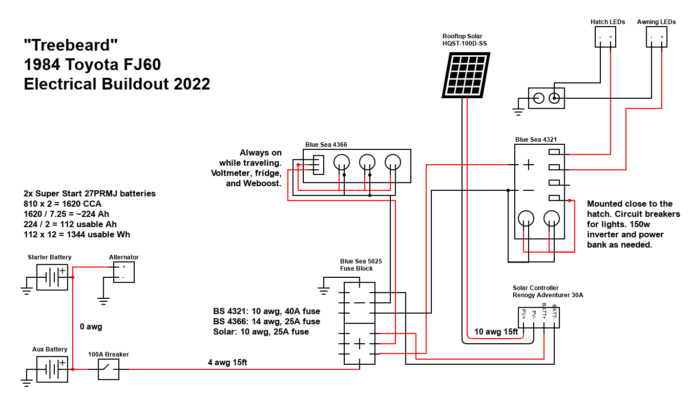

I'm planning to work from the road and that means I need power. I'm a web developer by day so I need cell service and my laptop. A GoalZero Yeti 500 would probably do everything I need... but I can actually build a dual battery system for about the same price. I replaced my starter battery last week so now is the perfect time to buy a second one and tie them together. I'm going pretty simple but leaving the door open to future improvements. I gotta say that I have learned a LOT over the last couple of weeks and I owe much of it to the PO of my tent (thanks Luke!) and to @Bullzi. Thanks for answering a bunch of noob questions and for all the photos of your setup.🙏 Another shoutout goes to faroutride.com... this is an amazing site for learning about electrical builds (among other things). I have used this wire size calculator extensively while planning the build.
The idea is to tie the batteries together with a 0 awg cable, rely on low power needs and solar to keep them topped off, and carry a battery jumper just in case (I have a Noco GB45X which works great). If, somehow, I manage to use enough power to need to jump the batteries then I'll consider another solution (Blue Sea ACR, Renogy DCC30S, or maybe a Redarc unit).
I ordered another Blue Sea panel (I already have one and I like the fit and finish), a couple of fuse blocks (one for the front eventually), a big circuit breaker for the front, and stuff for the new battery cables I need to make. I also spent way too long mapping all of this out using digikey.com. I found it really helpful for thinking through all of the possibilities and keeping track of my notes.

I’m not really and electrical guy but the notes you made really helped to understand the schematic. Thanks for that!

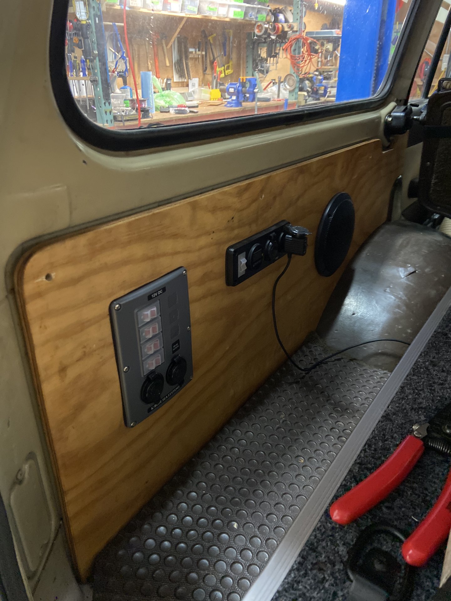

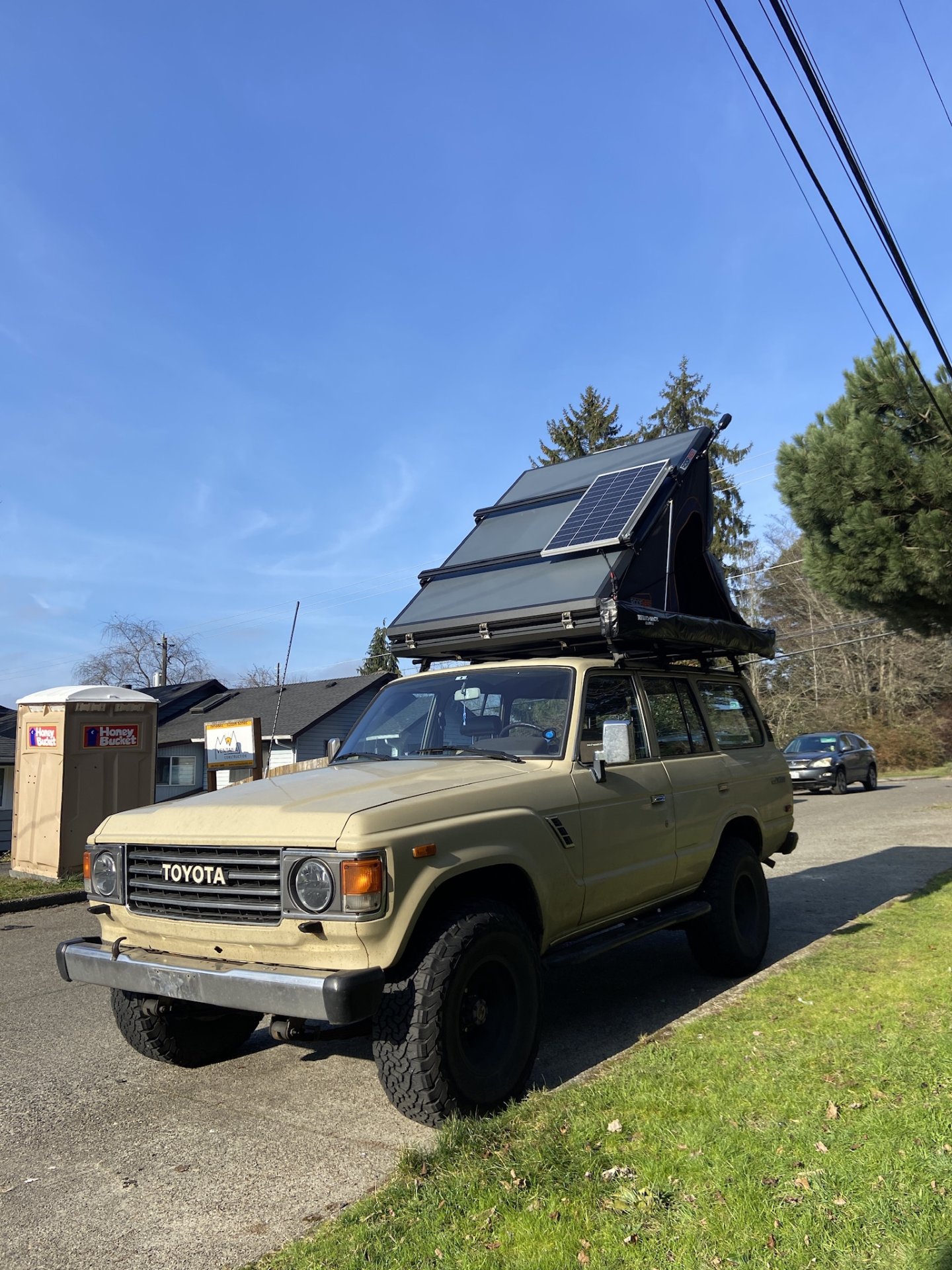

Good stuff over the last couple of days. The solar panel and rear power are all wired up! It went mostly according to plan although some of the terminals I used aren’t exactly the right size. I’m eager to test out the solar panel tomorrow (if the sun comes out). I found a piece of painted metal in the shop that I cut and drilled for a minimal electrical bracket next to the battery. There should also be space on it for one of Blue Sea’s more minimal fuse blocks. The second battery is installed but not yet wired up. The wire is on order and should be here later this week. Im going to use the KISS method found in the 200 series forum and run the batteries in parallel.

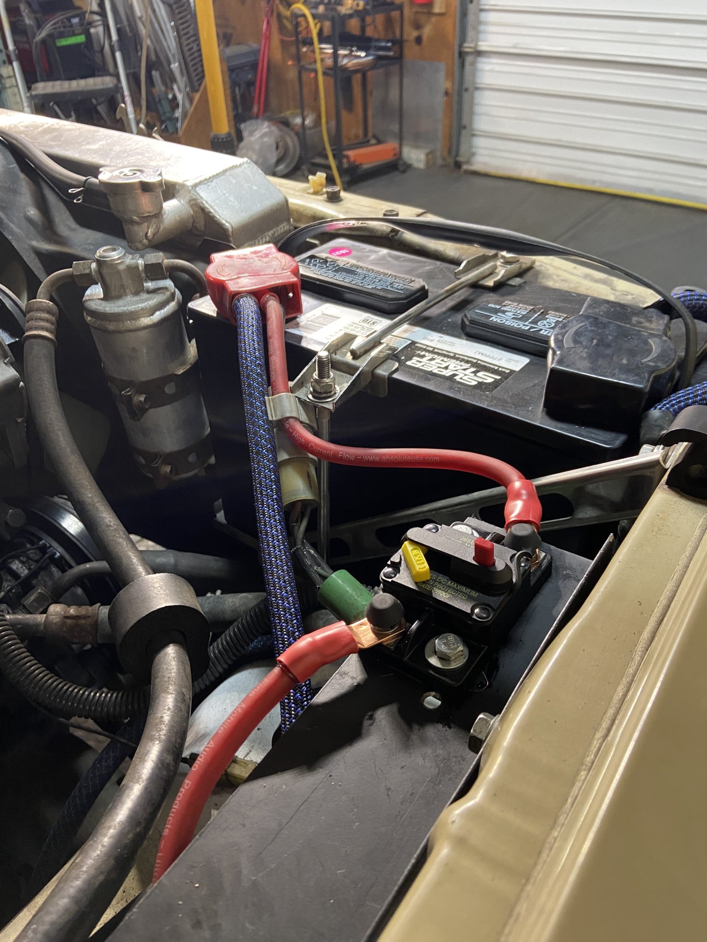

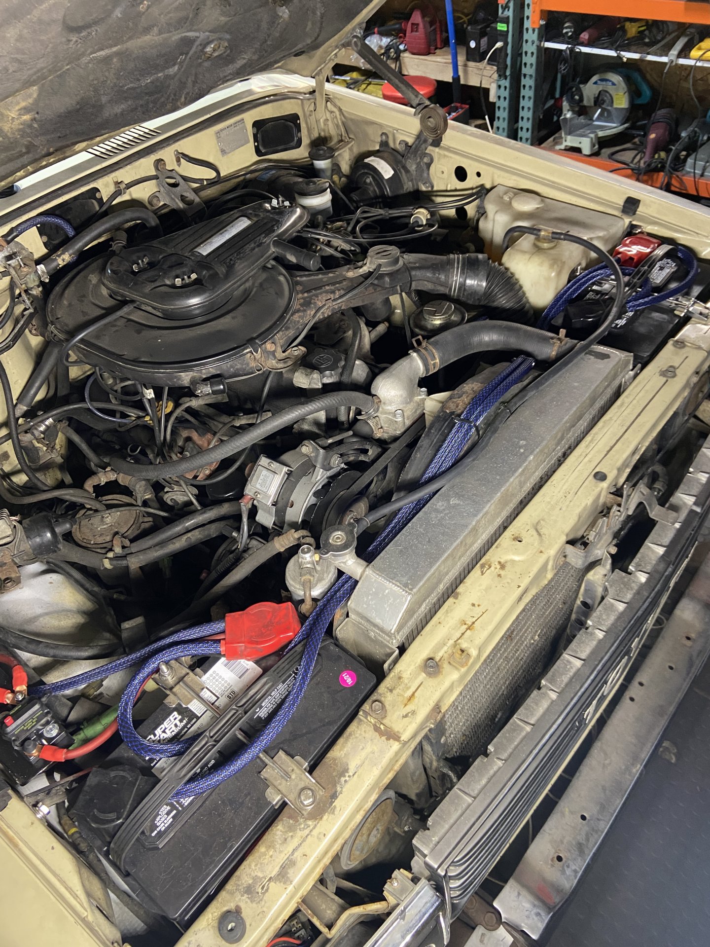

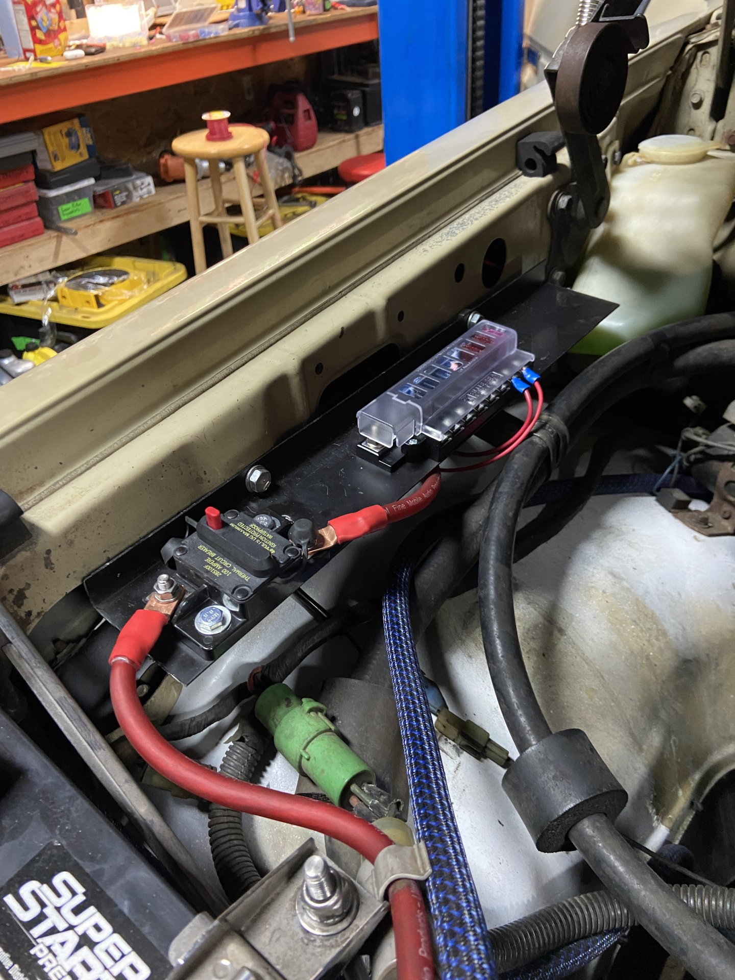

Let’s start with the electrical parts of my build. The solar panel works great, the dual batteries are installed, and I have a fuse block from Blue Sea under the hood powering my CB radio and seat hater. I have an updated wiring diagram to share later, I just don’t have it handy.
The dual battery buildout was time-consuming but ultimately pretty simple with the right supplies, a hydraulic crimper, and a stainless battery tray. I opted to route battery cables over the fan shroud for a couple of reasons. First, this is the shortest route between the batteries. Second, this pretty closely mimics the setup that Toyota used from the factory on HJ trucks. Third, this is less likely than other setups to result in a massive short circuit in the event of a head-on collision. The “other setups” I’m referring to include running both cables in front of the radiator, either on top of the radiator support or between the support and the radiator. These would seem to be fine to me if I had chosen to only run a positive cable between the batteries but running 1/0 + and - cables there seemed like a bad idea.

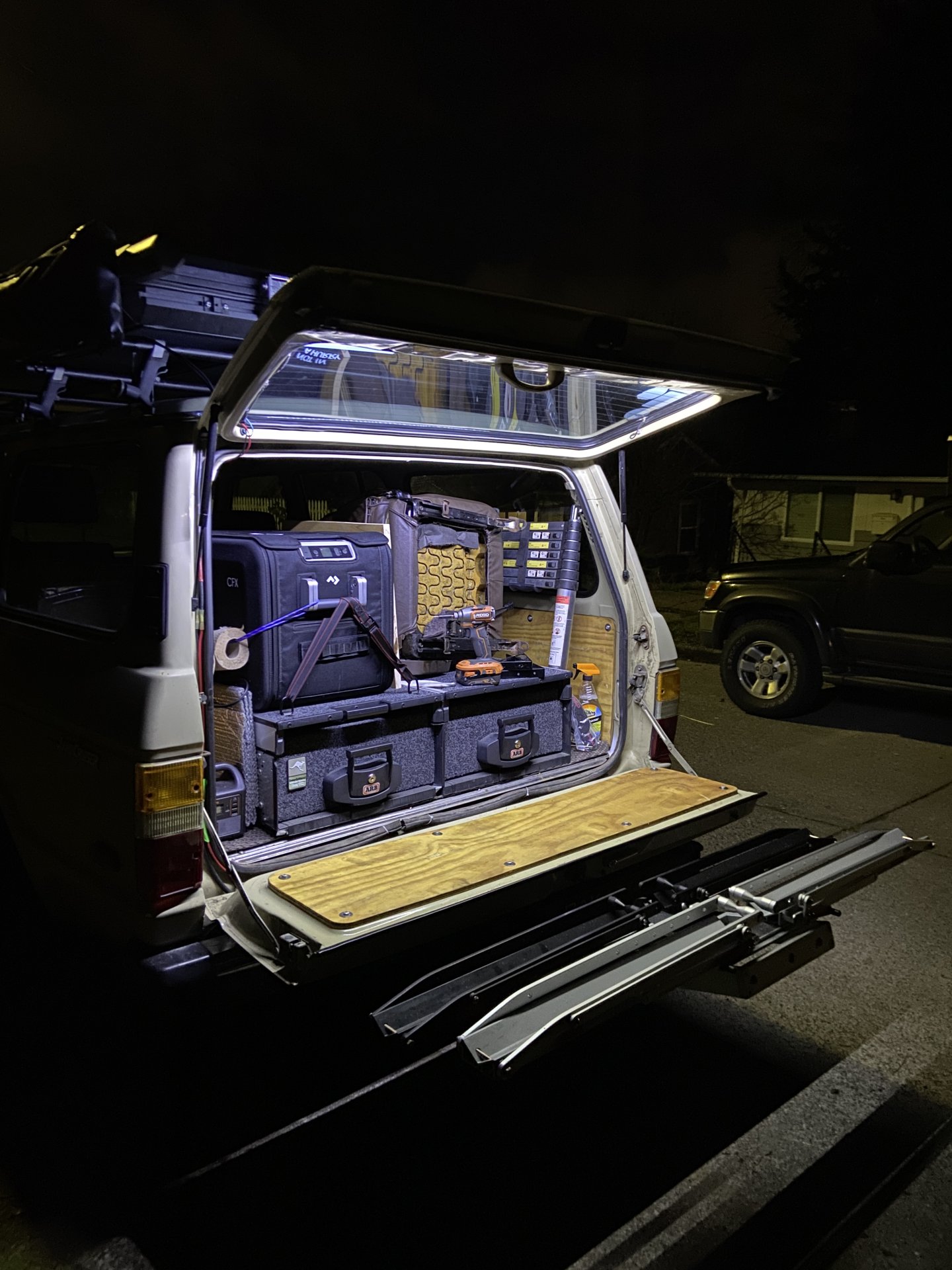

I wired up an LED light strip on my rear hatch, mostly following @blbuck12’s guide. I took the lazy way out and didn’t properly route my wires but I did manage to include an inline dimmer and hooked them up to one of my new switches on the cargo panel. They’re a little blue for my tastes but super functional.

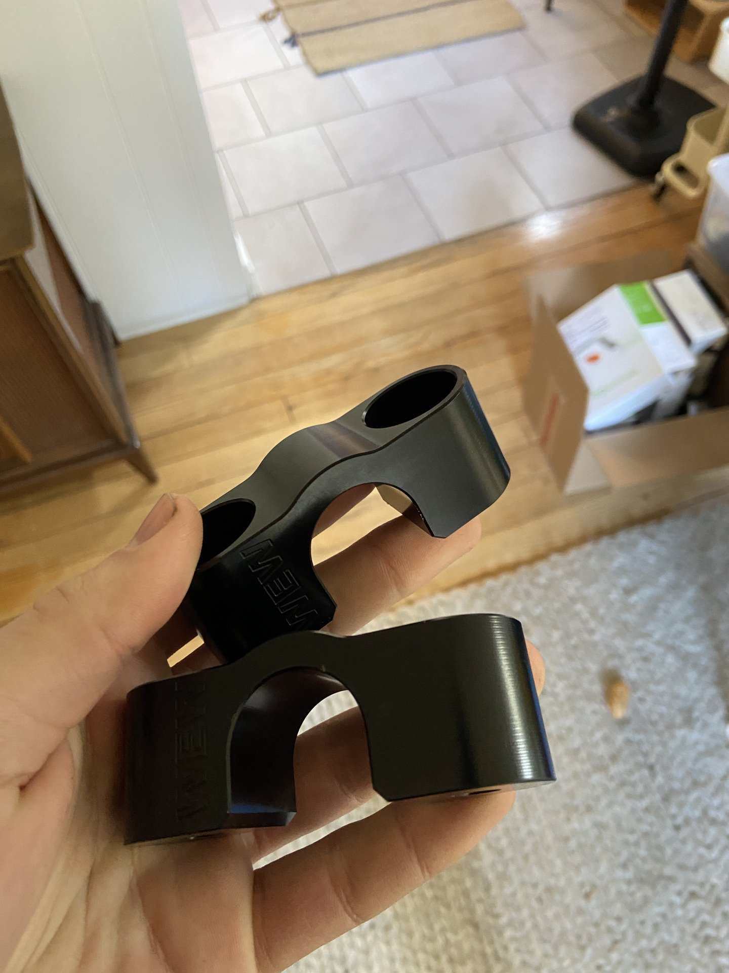

I decided to spring for some beefy, security-focused mounts for the rooftop tent. These mounts from Wheel Every Weekend use security nuts and are designed to thwart bolt cutters. I feel a lot better driving cross-country with an expensive RTT (and gear bolted to it) with these. I did notice one of them rattled loose after a few hundred miles but that’s on me. It was easy to snug up.

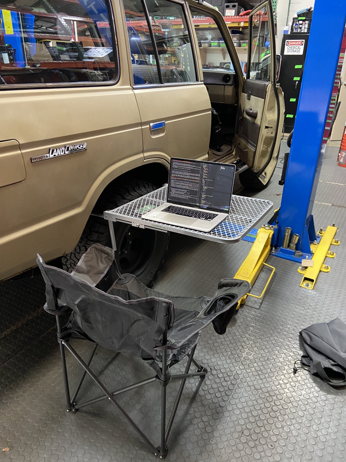

My job is 100% remote now so I’m aiming to be able to work from anywhere. This “Trailgater” tire table is a spendy addition to the kit but I love that it’s lightweight, easy to set up, and is always level. There’s plenty of room for a laptop and other gear, doubles as a dinner table under the awning, and it’s the right height for camp chairs.

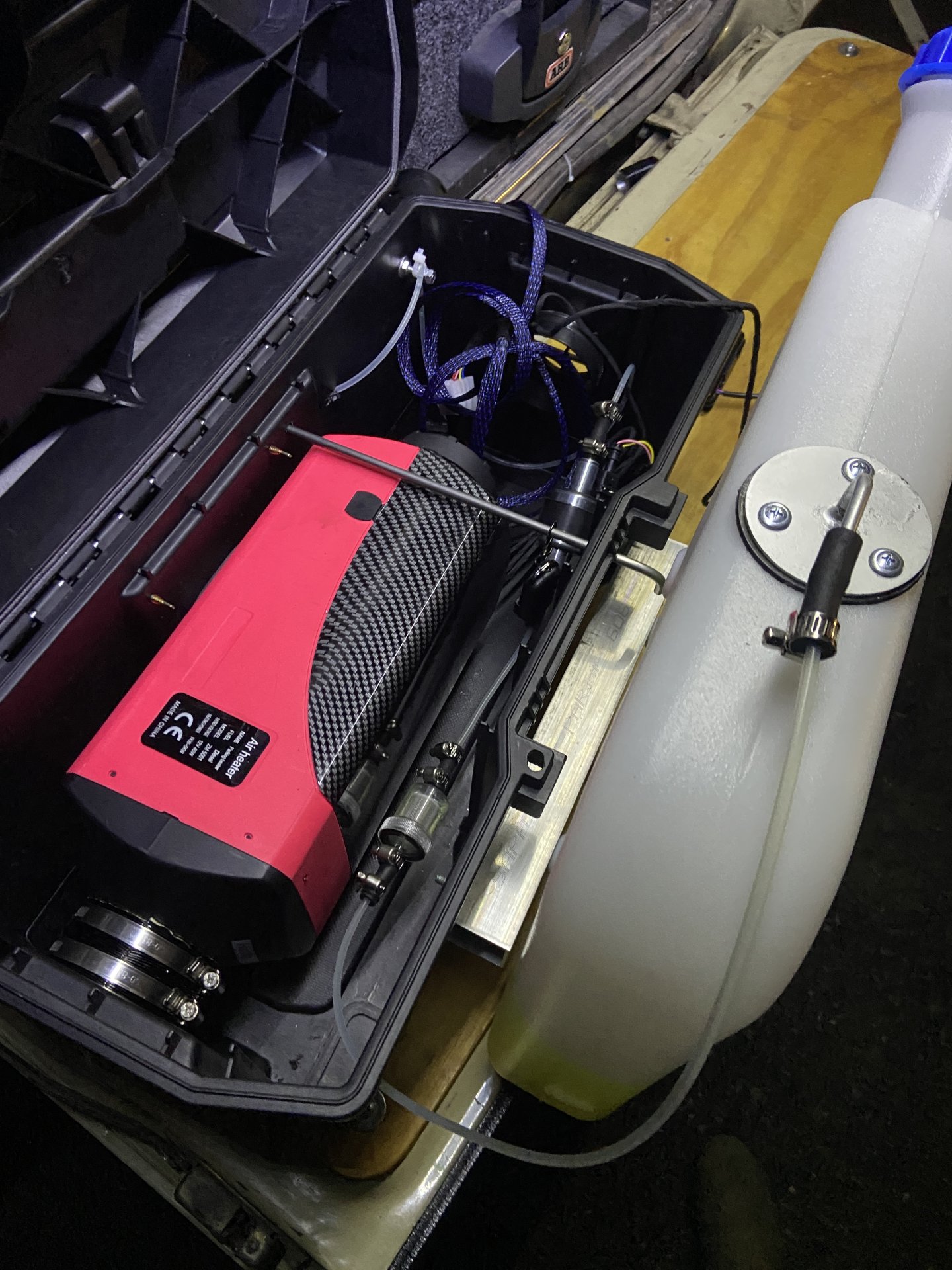

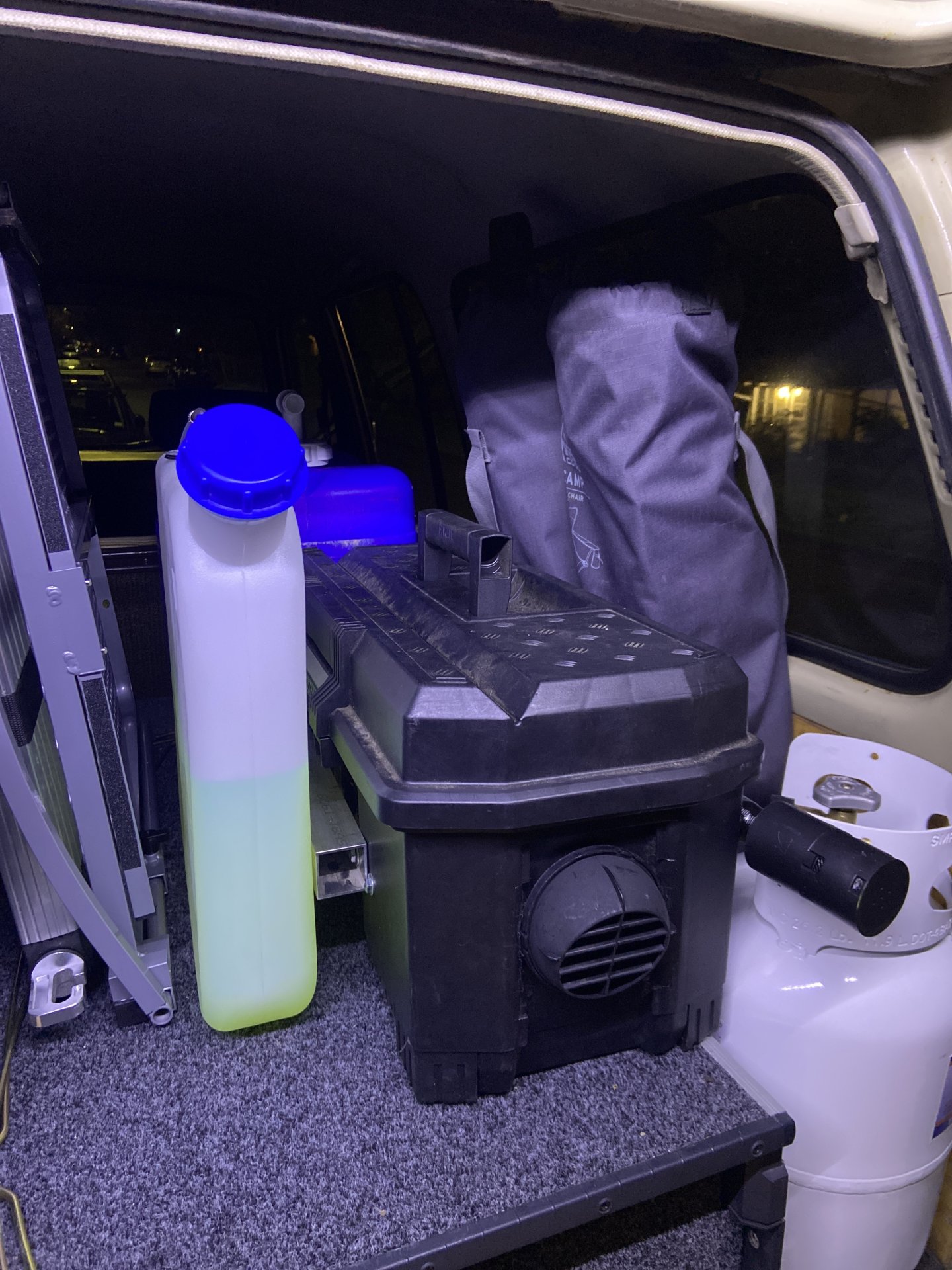

Finally… the heater. The Roofnest Flock facebook group is obsessed with portable diesel heaters and I’m a believer. The patent on the Webasto design expired a few years ago and now cheap Chinese knock-offs are all over Amazon. I’m not usually a fan of cheap Chinese gear but these seem to work very well despite the relatively poor build quality. With a bit of power and a bit of diesel fuel these can put out clean, dry, hot air that’s perfect for keeping a vehicle or tent warm and dry. I ordered one for about $140 off of Amazon and stayed up late last week building it into an old toolbox I had laying around. The night before we were scheduled to leave on the trip I finished it and tested it on the tailgate in front of my house. It works super well!
Unfortunately someone must have seem me testing it because it was stolen out of my rig that night. There are a number of homeless folks living in RVs near my house and I can only imagine how enticing one of these things would be. I just hope they don’t try to use it inside one of the RVs. I’ll build another one before long.

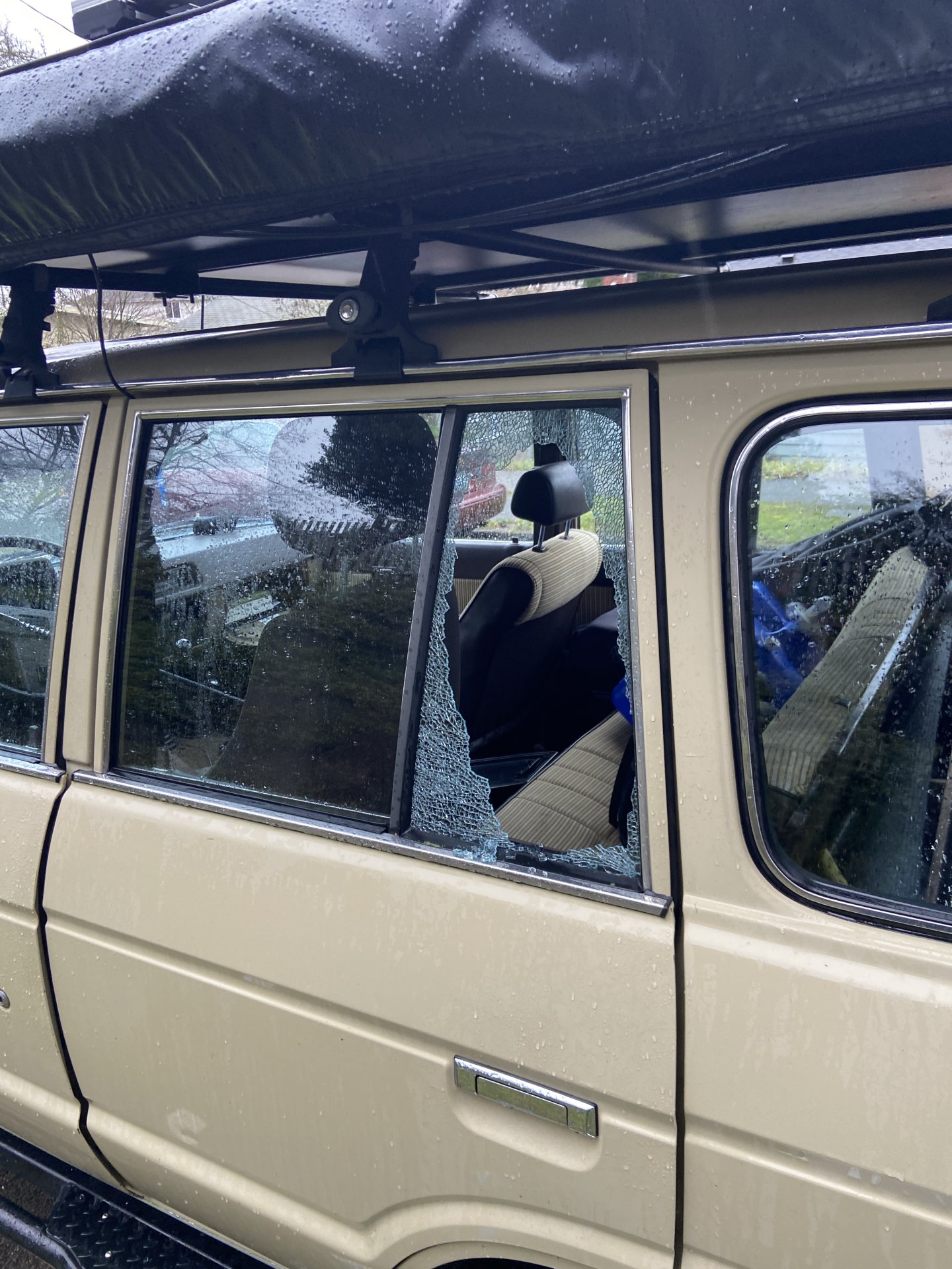

Cruiser people are the best people. I posted on local channels about the broken window and received several offers of help including multiple folks who were willing to remove the glass from their own truck in order to get me on the road. I accepted that offer from @red66toy and he helped me get it installed that same day. He’ll receive another piece in the mail this week from Cruiser Corps. :)
I just can’t believe that we fixed a broken window from a 40-year-old car in less than 7 hours. Legendary.
