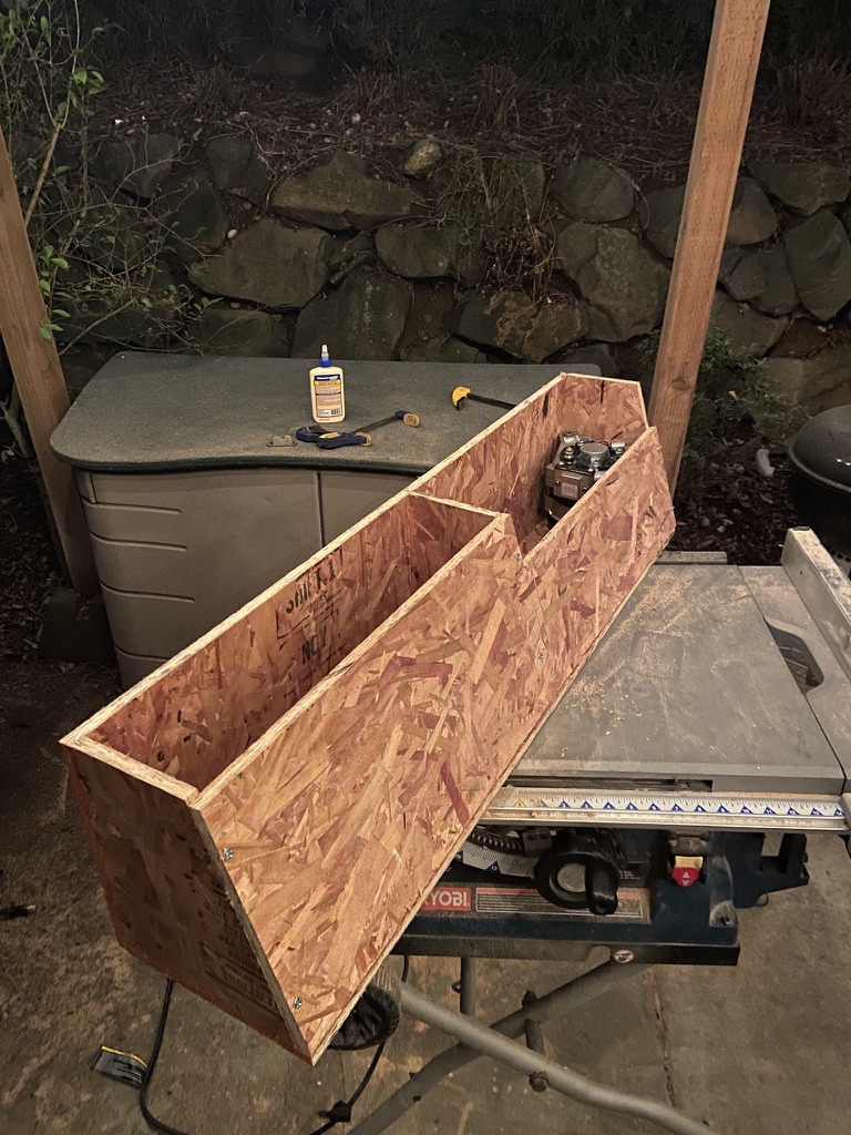

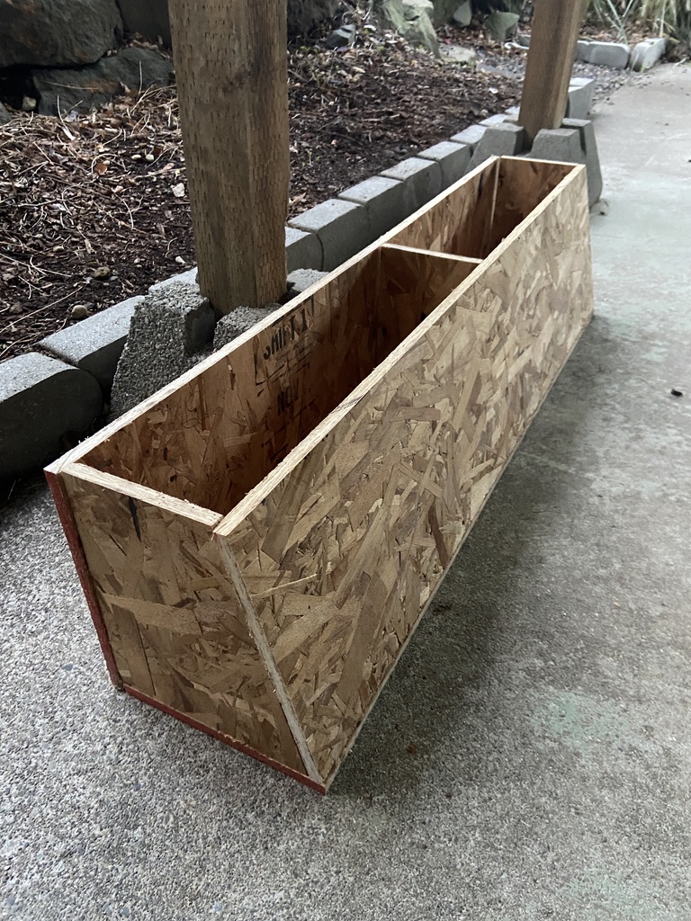

I was gifted some 1/2" plywood and started working on a box to fit between the drawers and the rear seat. Currently I'm losing a lot of drawer space to spare parts and rarely-used tools and this box will make a much better home for them. There's a top piece that fits flush with the top of the drawers and I'm hoping to finish it in gray carpet to match. Unfortunately I measured wrong at some point so I'll need to do some tweaking.

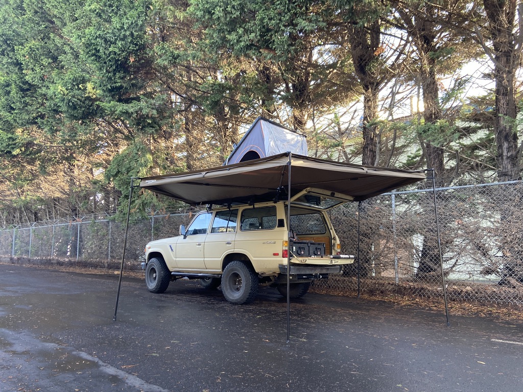

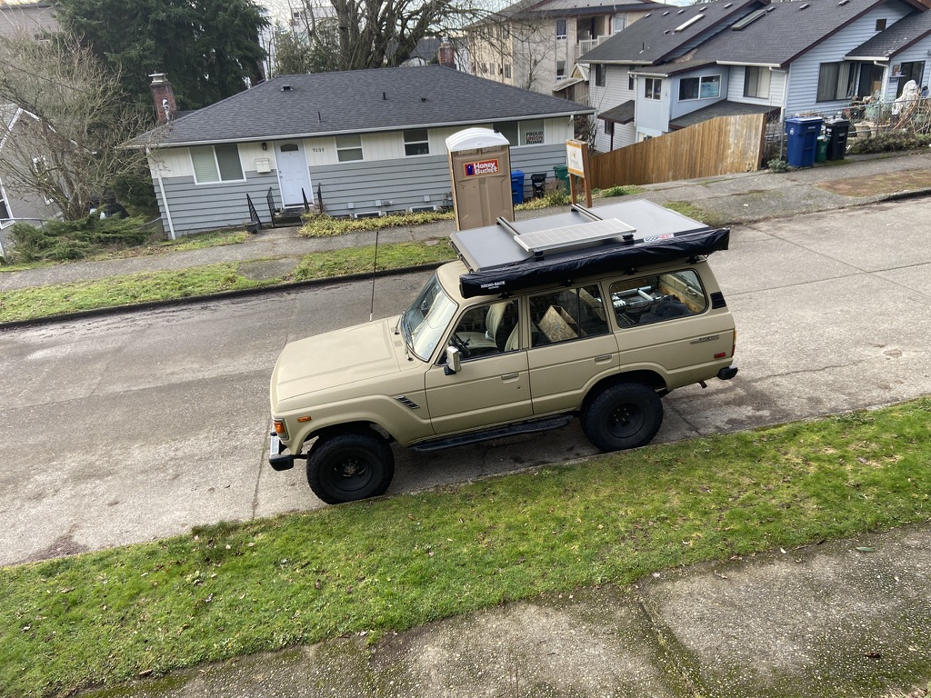

First of all I bought another rooftop tent. I am EXCITED about this thing! It's a Roofnest Falcon XL. I was worried it would be too wide on the 60 (it's 60" x 90") but @Rockymtnreaper reassured me that 60" is a good fit and it definitely is. There's some overhang on the sides but I don't think it looks awkward at all. I got a good deal on a used unit and the PO threw in lots of goodies including the crossbars, a HQST 100w solar panel, a Renogy solar charge controller, and some tent accessories.
The first order of business was to get my recently-acquired Batwing awning mounted to the tent. The PO included a pair of Roofnest's beefy awning brackets. They're designed for smaller awnings so I cut and drilled some aluminum angle extensions to fit the Batwing (I have more hardware on order). As a result the awning sits about 2" away from the tent and looks amazing.

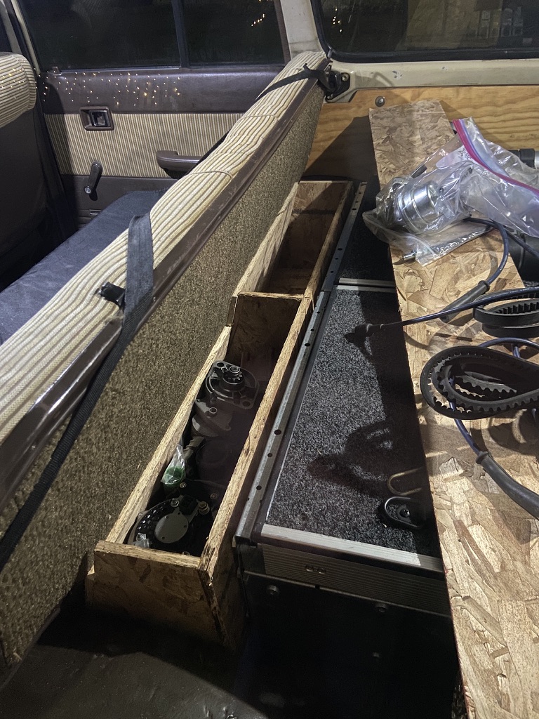

I have nearly finished up the box for spares and tools. I ended up cutting the back down on one side so that my spare alternator would fit. I may have to fold the seat forward to get at it when needed but hopefully that never happens. The top piece fits flush with the top of the drawers. I'll finish it with gray carpet and call this good for now. I really should have painted it and at some point I will, ain't got time for that now. This is carrying a spare alternator, starter, coil, distributor, fuel pump, fusible link, fuel filter, brake line, belts, spark plug cables, bottle jack, air compressor, battery jumper, and probably something else I'm forgetting right now. That's a lot of extra weight but it's peace of mind.

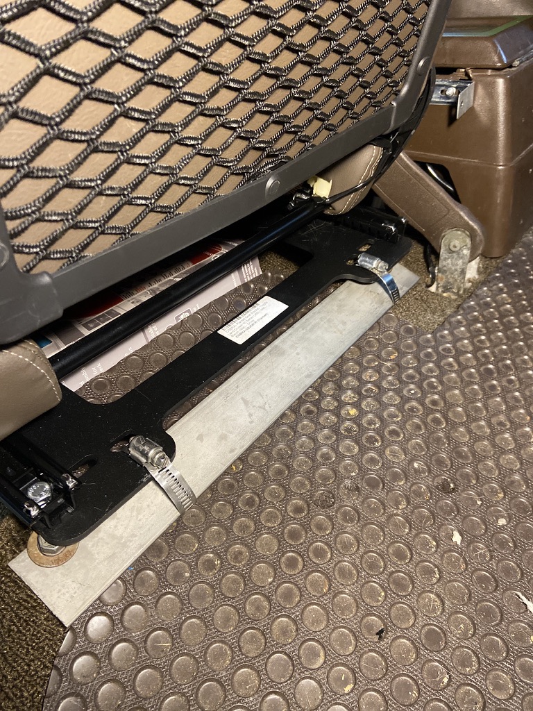

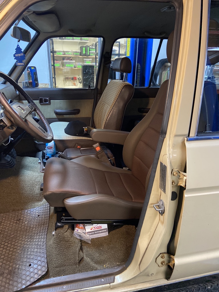

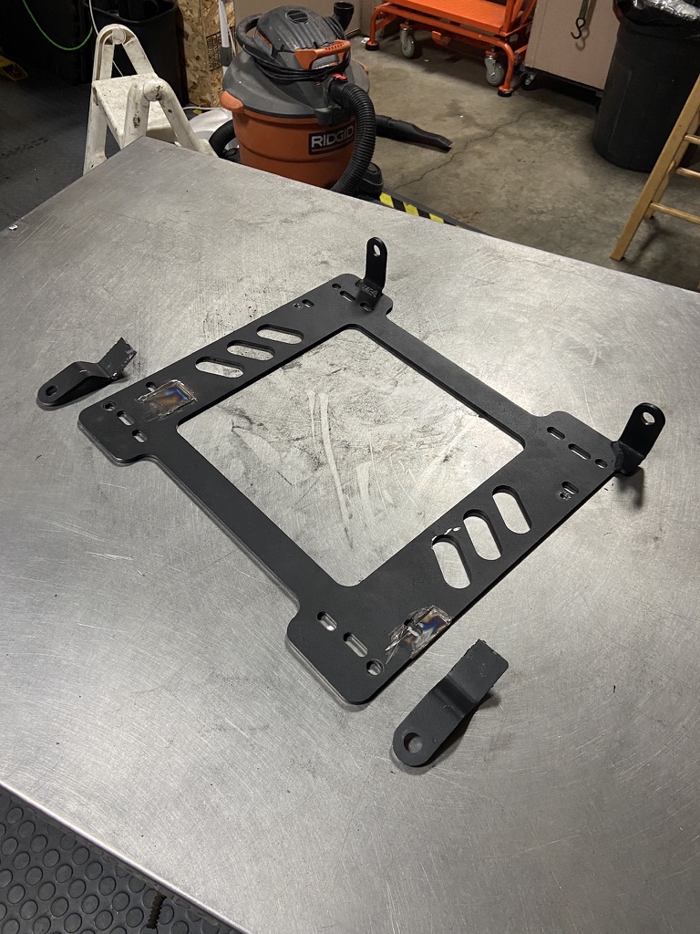

I finally worked up the guts to chop my Planted seat bracket for more headroom. I cut off the rear legs and installed the seat with only the front bolts. The weight of the seat bends the front legs enough so that the rear of the bracket sits on the seat mounts. Note that one of the sliders overlaps with the outside mount bolt, otherwise I'd bend the back of the bracket and drill holes for the mounts. Instead, I bolted down a metal plate and (I know, I know) clamped the bracket to the plate. The bolts for the sliders are right up against the plate, otherwise I would have flipped it. Eventually I'll cut some tabs for the slider bolts, flip the plate around, drill holes in the bracket and plate, and bolt them together.
I think this FINALLY feels the way I always expected the Scheel-Mann to feel. I have the bottom fully extended for thigh support, the side bolsters hug my butt in a way that feels secure but not painful, and my back is happy. A telescoping steering wheel is the only thing I'm lacking but with the sliders back in place I can easily make adjustments during long driving days. If I spike my hair it'll still brush the headliner but that's just Treebeard telling me to make better fashion choices.
