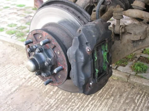

Regarding: lug centric vs hub centric... The LC100 seems to be a bit of a combination. For OE alloy wheels, it has shank style lug nuts and the wheel, will be centered on the lug nuts no matter if there is a center hub or not.
For steel wheels, the lug nuts are tapered and without a centering hub, I can see how one could mount the wheel off center.
With 1" wheel adapters, the wheel adapter will be hub centric to the vehicle's hub and uses tapered lug nuts. Then the alloy wheel will be lug centric to the wheel adapters with shank style nuts.
Edited for accuracy and visual from wanderingwilly's brakes...
