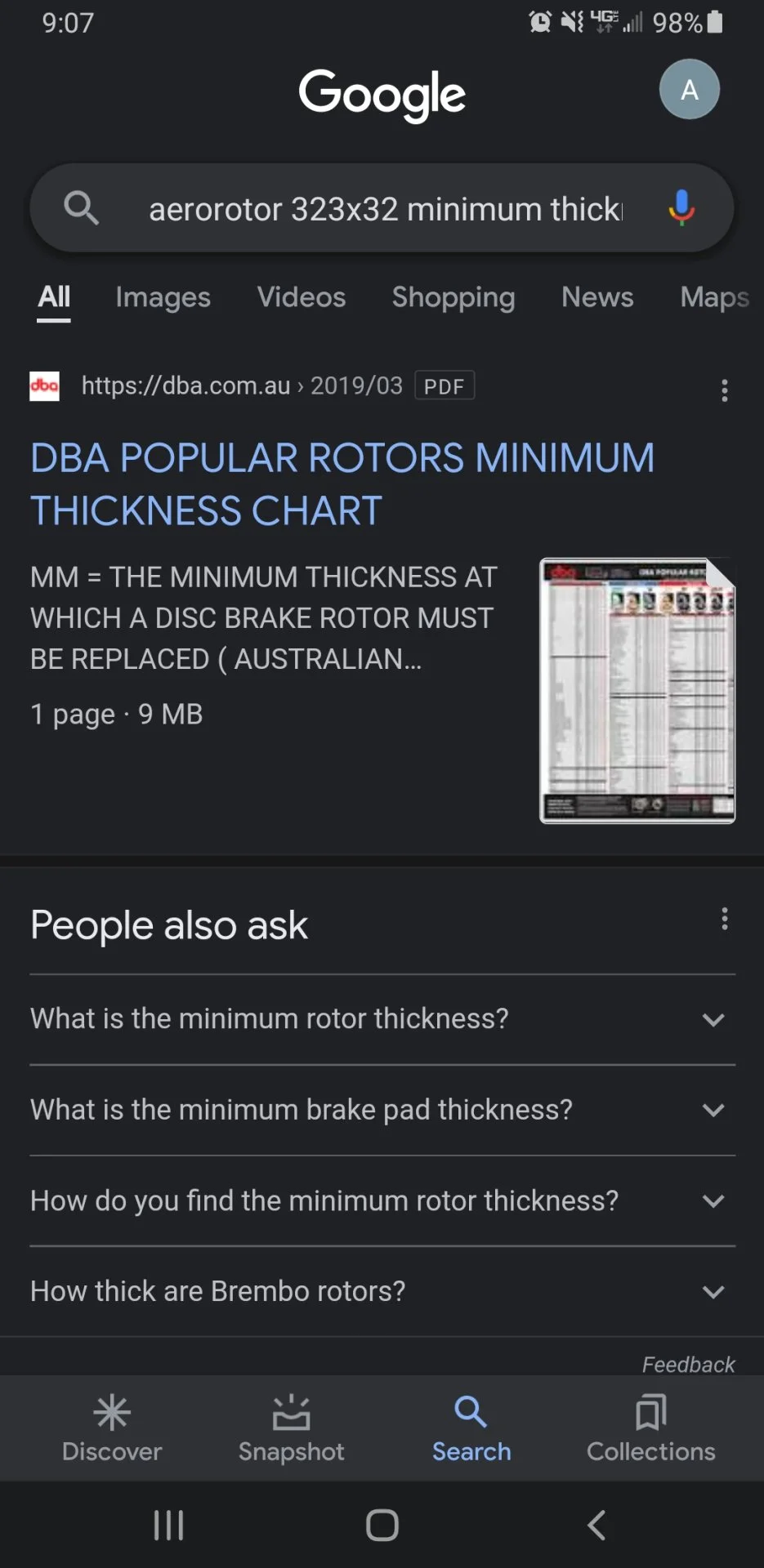

I found a chart online that says min thickness for a rotor that started at 32mm, is 30mm
Sorry couldn't link it
Thank you! Very good info to help estimate it.
The link is https://dba.com.au/wp-content/uploads/2019/03/DBA-WALL-CHART-2019-FINAL-PRINT.pdf
