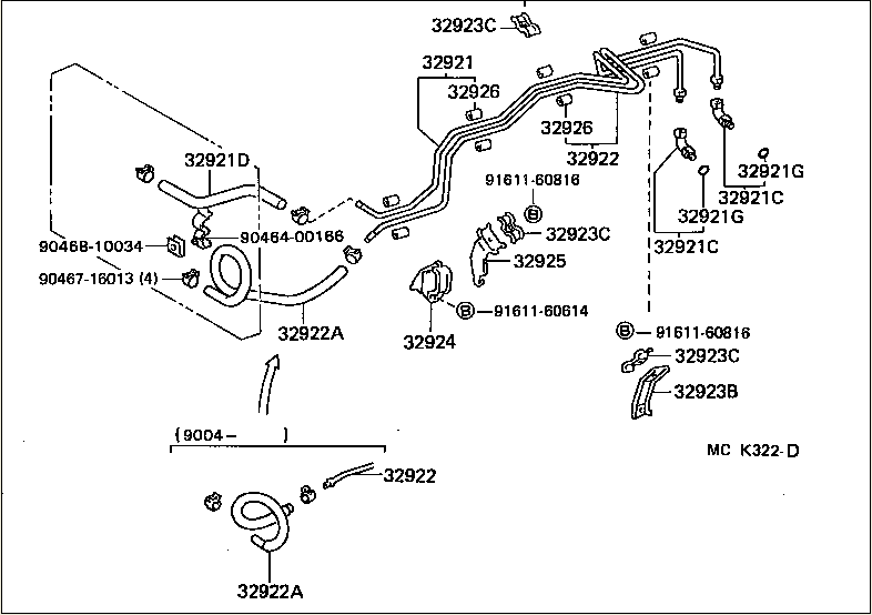

diagram 3514 from the EPC for a 1990 HDJ81
32921: TUBE, OIL COOLER INLET, NO. 1
32922: TUBE, OIL COOLER OUTLET, NO. 1
I just recieved the tru-cool max (the same model as you got) and I'm wondering how to install it. The way it's installed now, the parts 32921D and 32922A are removed and replaced with flexible lines that go trough the lousy tube and fin cooler I have now, without going trough the original radiator.
Would it be better to run the oil first to the original radiator and then trough the tru cool max or better the other way?
I guess it'd be better to run it trough the original first, but I'm not sure.
If I do it this way, I think I just have to order part 32921D from Toyota, then run a flexible line from the connection 90467-16013 (4) to the inlet of the tru-cool max, and then use the existing flexible line that is connected with the present radiator to connect the tru-cool max outlet back to the transmission trough the 32922 line.
Does that sound ok for you?
Thanks a lot.
