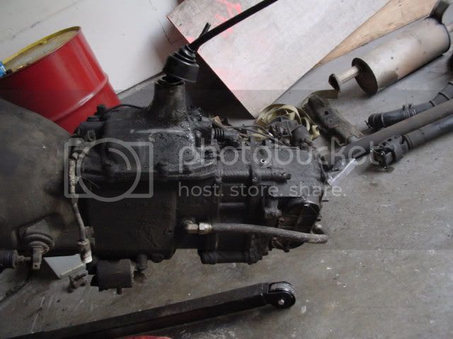

Maybe this will help...
What you have is an H55F five speed... the x-member for it it the same as the x-member for any 4 speed FJ60 gas model... fairly easy to find... that seems like a lot cheaper way than having one shipped from Australia... I shipped one from Seattle to San Diego and it cost $15... anyway, it's an H55F. Like this one:
:cheers:
you can see the mount to the upper right of the transmission.

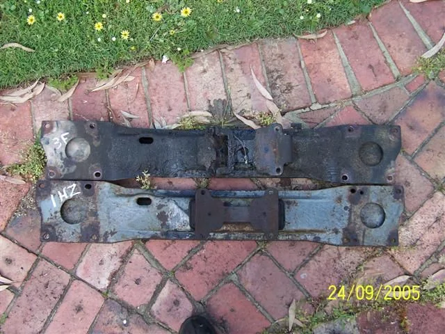

This what the it says but are from a 73/75 series and thus ,the crossmemeber is shorter.
The 3F mount is partly camoflaged and looks the same as the 1HZ.
For future reference BJ60 dont exist in oz but we have plent of BJ70/73/74

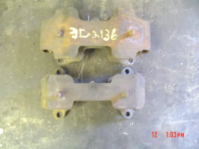

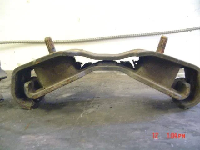

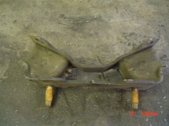

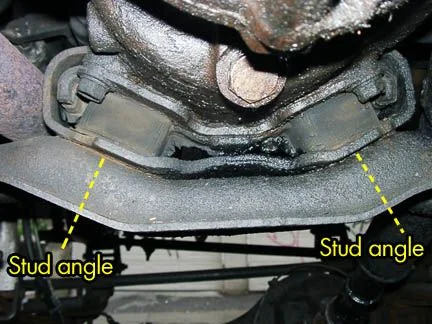

I have the rubber isloter .
Also have a HJ60 cross memeber and mount shown.
Assuming you need just the isolator?
Rob
The crossmember changed in 1985. The correct one for an '83 is on the floor behind the tranny in fe sus's post. The correct mount its the second one in Rob's picture. The crossmember hangs on two removable "L" brakets bolted to the inner framerails rather than bolting across the bottom of the frame to two welded mounts.

Mine are like the first one attached .. in my HJ-60 87 ..
