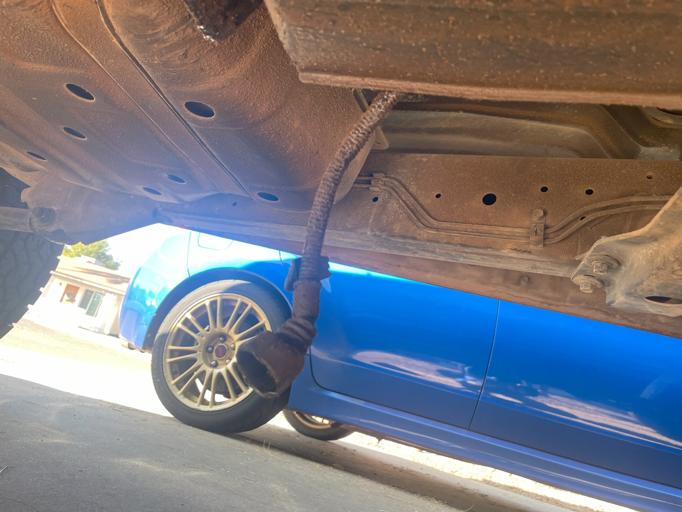

This morning I woke up and noticed a wire dangling underneath the vehicle and when I checked the connector - I noticed the pins were all destroyed. Seems like I can replace the wire. But I can seem to find the part number? Does anyone know the part number?

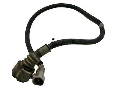

Looks like the Speed Sensor harness: 8225160050
That is almost definitely the speed sensor connector as mentioned. It is the only plug I can recall that has that specific boot.
