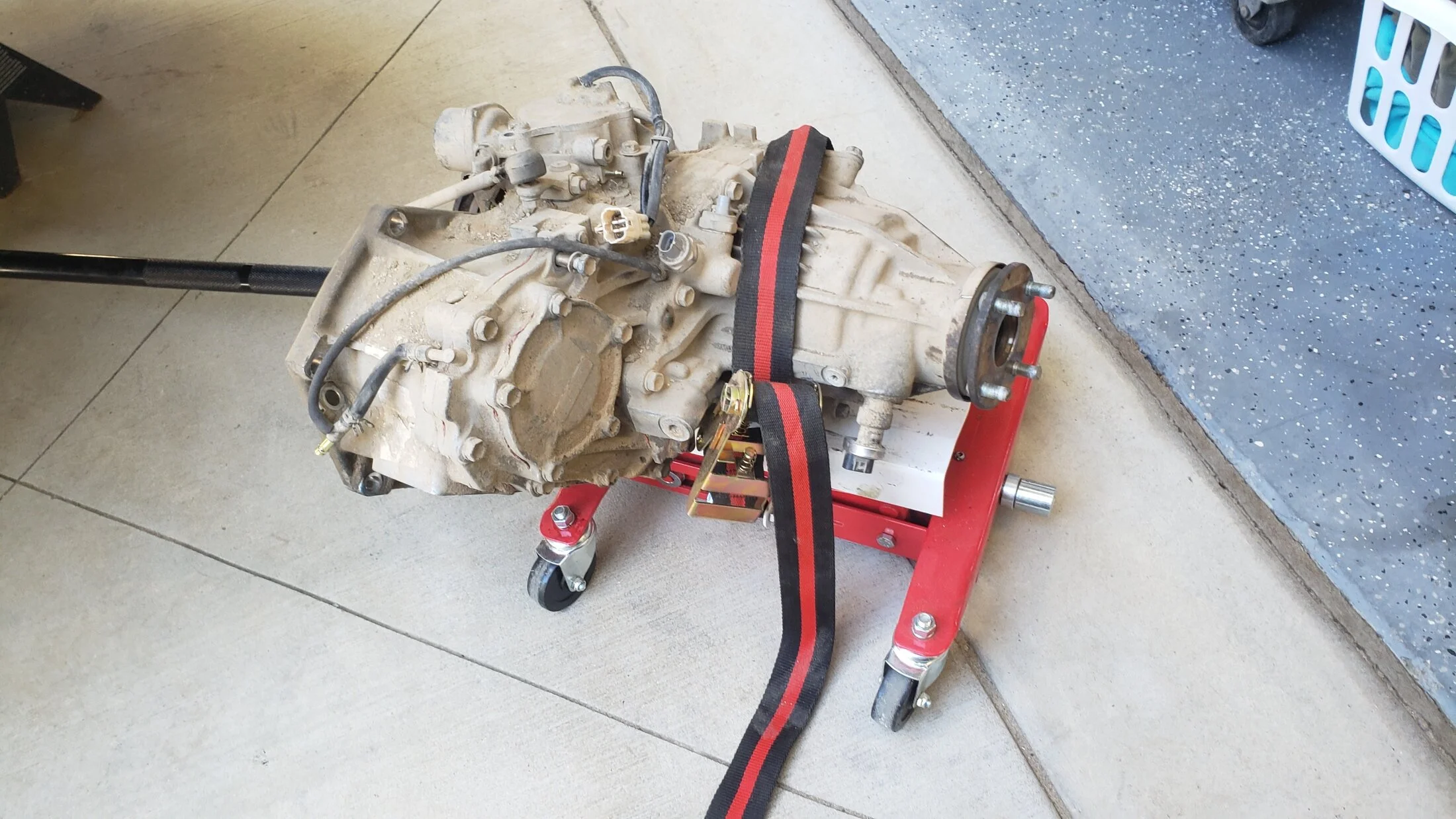

I found the cheap Harbor Freight transmission scissor jack to work well for this job. It isn't very well made, but I got a lot of use out of it before the cheap pot metal cage for the bearing exploded (part not available separately). It sure beats bench pressing the transfer case. The only trick is to make sure the vehicle is high enough to wheel the transfer out including the height of the lowered jack.
I looked at that really hard for a minute, then I decided to make a cradle for the transfer case from wood scraps, bolted in place of the spinner on the floor jack. And, since I don't have a lift, the frame was 3 inches higher off the ground to allow me to slide the transmission under it, bellhousing attached (because I really didn't want to torque those bolts lying on the ground). This made reaching the transmission with the transfer case more of a chore than it should have been, but it did provide needed extra work room to move around, so a mixed blessing/curse.
Truth be told, I did agonize over whether to install them separately, or assembled, and chose the wrong solution.
This job would not have been so frustrating if there was at least ONE FLAT SPOT on the bottom of the transfer case. I mean really, how hard would that have been?
A really decent transmission jack in on my Christmas list ;)

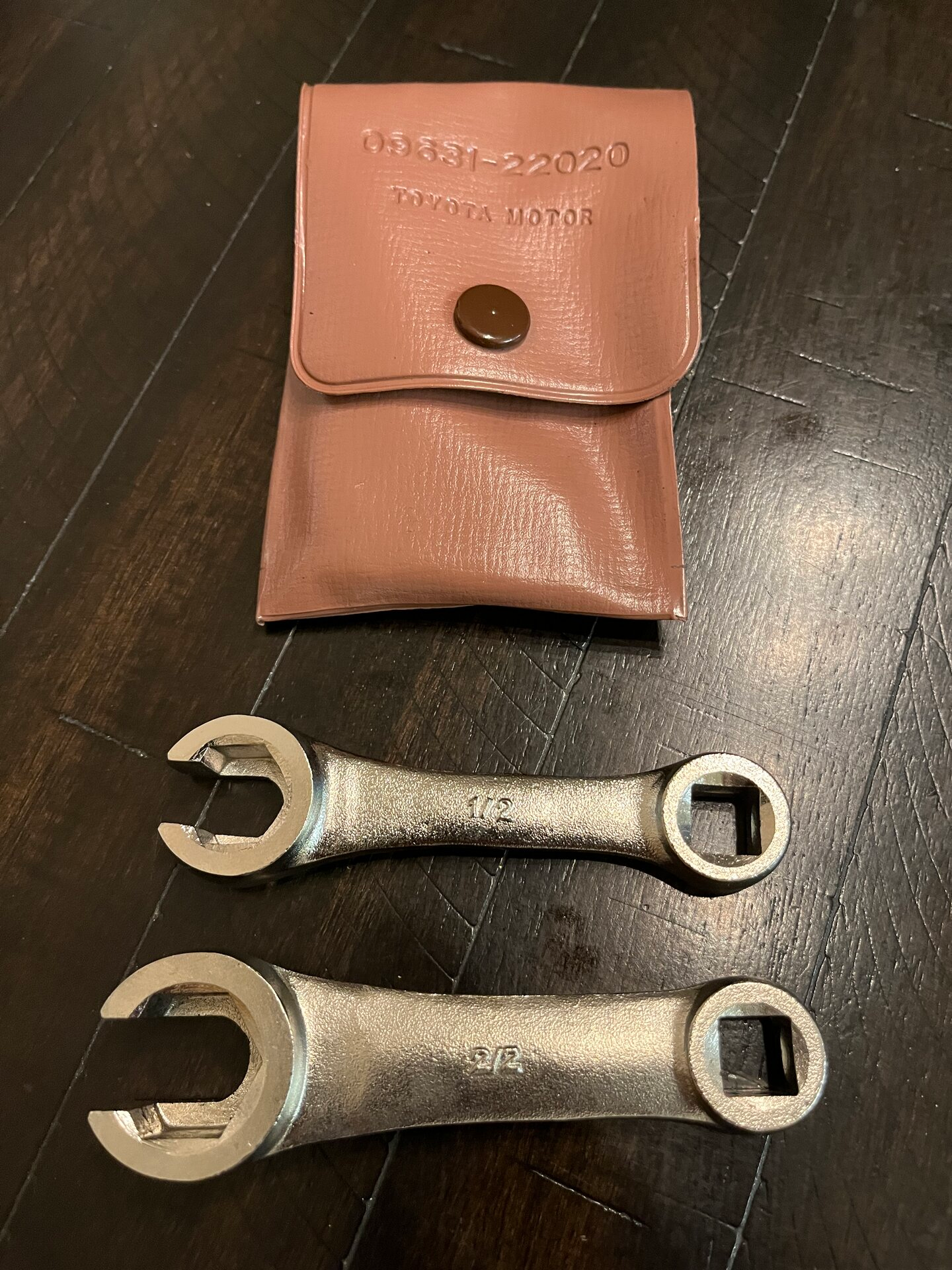

The only bugger was breaking the nut on the return line loose. Even with the exhaust out of the way, it's a PITA with common tools.
You really need the Toyota extended crow's foot; it's well worth the cost. 09630-22020 (17-mm crow's foot); note: you cannot use a generic crow's foot - they're too short. This one is specially designed for the cooler line fittings on the transmission and the power steering high pressure circuit lines. There is also a 14-mm version. Pieces 1 and 2 of a set of two.
They used to look like this:
special thanks to @dmamj for this and the other awesome tool porn.
Current versions are similar to conventional crow's foot adapters, but longer.
