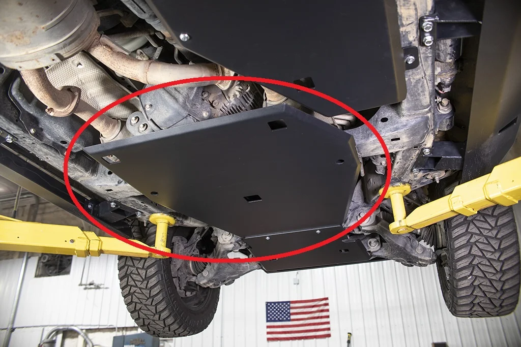

My choice would be the Bud Built or Victory 4x4 (if you have any other choices, then please share).

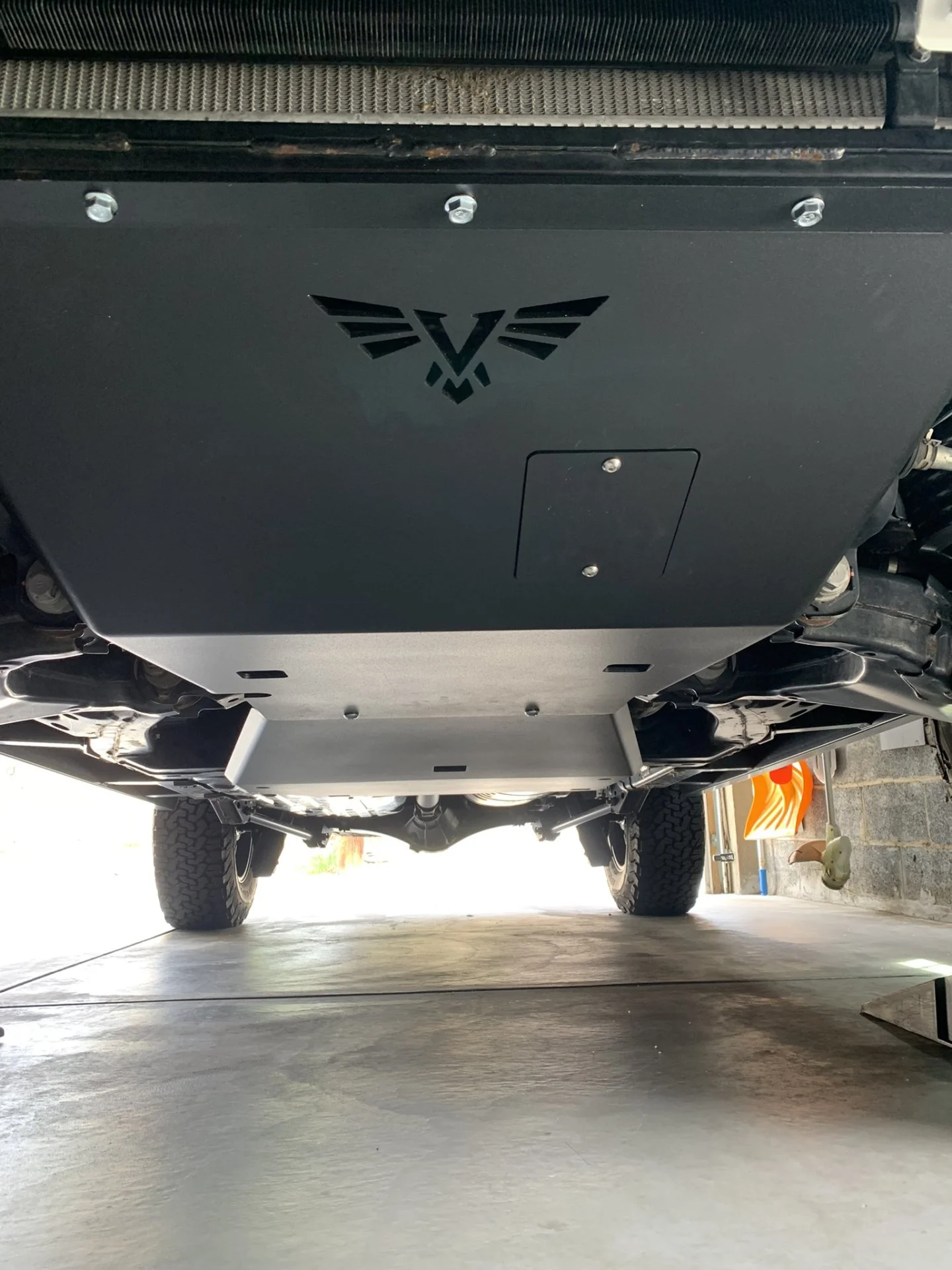

Victory 4x4 seems like providing more protection area compare to the Bud Built and somewhat cheaper with free shipping (especially with an Aluminum option).
Not sure you can still keep the factory front/mid covers w/ Victory 4x4 skid.

I'm a huge Budbuilt fan, and am very biased. I'd go Budbuilt on the skid (or skids)
I own the Budbuilt (actually two sets, one aluminum and one stainless) and the Budbuilt has the benefit of adding an additional strong steel crossmember, it is NOT mounted to the transfer case. Any strikes are transmitted to the steel ladder frame of the car, through both the factory crossmember and the new Budbuilt steel crossmember. ...not the fragile transfer case aluminum case.
I haven't seen the Victory mounting arrangement, so I don't have hands on knowledge. The photo you posted above of the Victory looks like it is just cantilevered out past the factory cross member, but again, I haven't had my hands on one.
I would look at any mounting carefully, to make sure it doesn't mount to the transfer case, and has a sturdy mounting option.

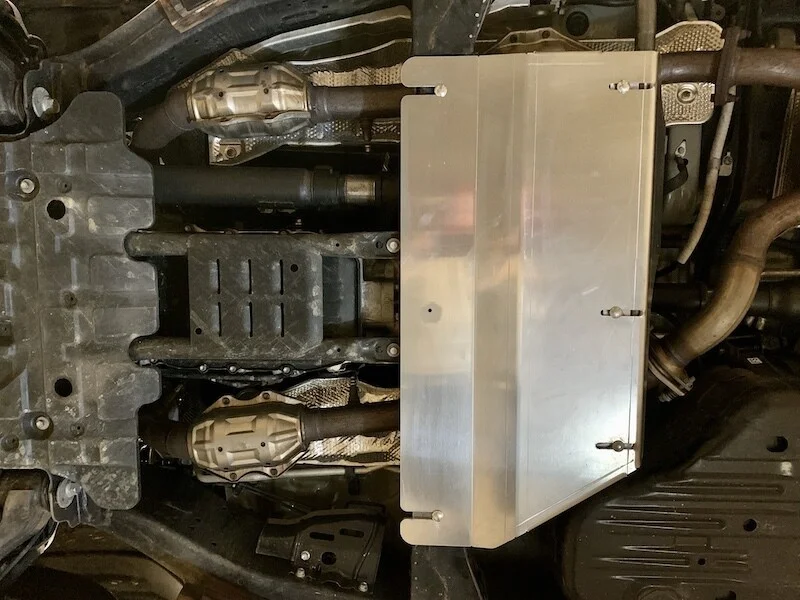

I’ll disclaim that I have these skids, but I’m not precious about them. They were the right price at the time.
A lot of noise is made about this design but I do think it’s over blown. Have you ever heard of anyone taking damage this way? ARB has sold a bazillion of these globally.
For OP, for a mostly highway cruiser, the factory transfer case skid is actually quite stout - And it’s also bolted directly to the transfer case.

I have the victory transfer skid and the mounting bolts go through the two circular holes in the picture. They do not mount to just the crossmember. I have the aluminum version and am happy with them but would agree the bud built are the more robust option. I think they also have more steps in installing and uninstalling vs the victory. I need basic lighter weight protection and don’t push my rig very hard for my use case.
Thanks for sharing... do you have to remove the factory skid in order to install Victory Transfer Case Skid?
