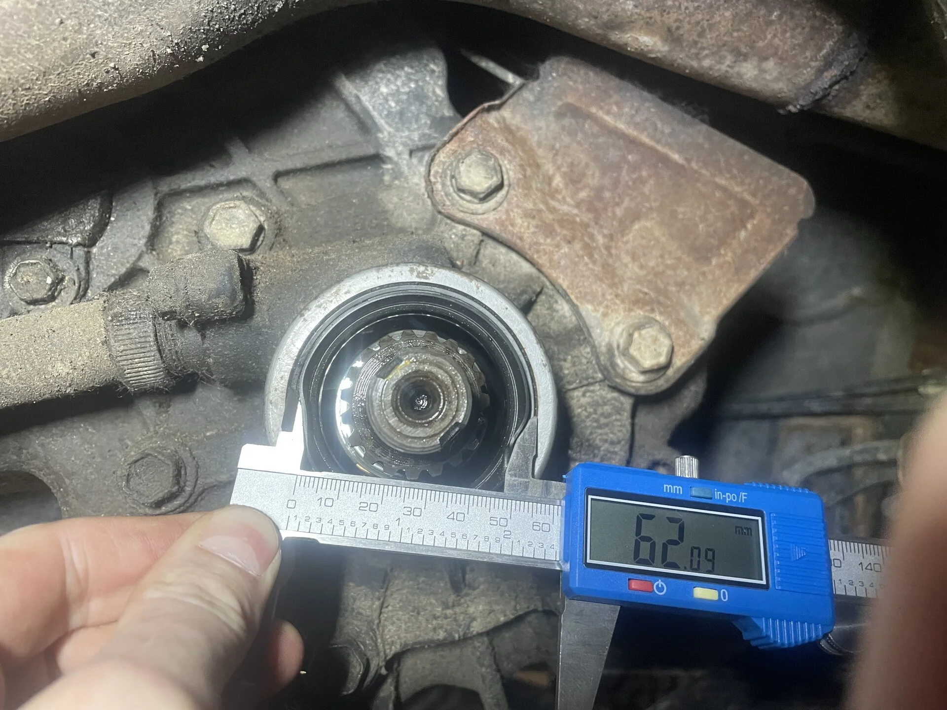

Is there any way to know whether I have a 62 mm (90311-48010) or a 65 mm (90311-48023) oil seal, without having to do a physical inspection or take the rear drive shaft off?
My truck is a 1992 HZJ73, manufactured in March 1992, and it's an automatic.

You need to remove the rear propeller shaft to measure the seal.
Mine is 62mm
Time to place the parts order.
