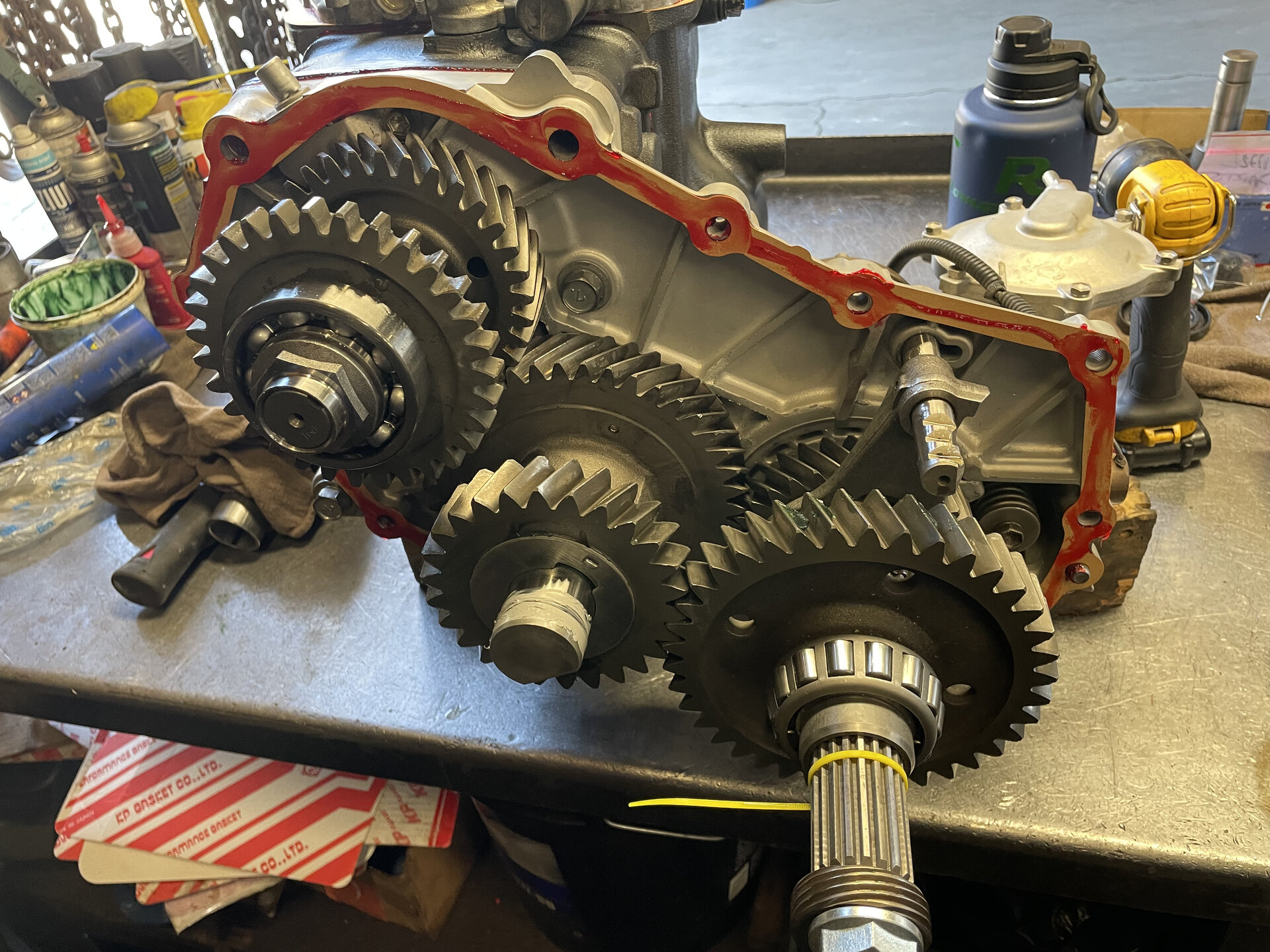

However, there are plenty of gearing options for your transfer case. You can run 3 to 1 low range gears that do not affect your high range, or you can run 4 to 1 low range gears that would also equate to a 10% under drive in high range.
Both of these car seats are made by sumo gear company and they’re made in Japan. Fantastic product. We’ve been running them for 15 years including the prototype set in one of my personal vehicles.
Both gear sets require machine work for the required added clearance. We can help with that as well.

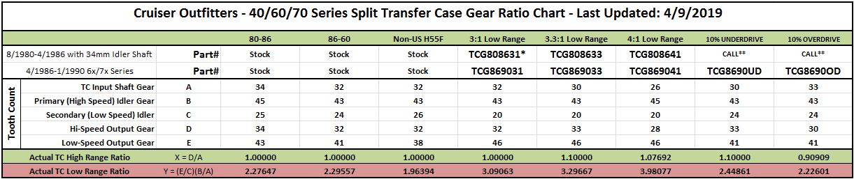

One thing to be aware of with the split case is that there were two different idler shaft diameters; 34mm and later 38mm. You need to know which size you have when ordering a new gearset.
Plenty of gearing options available for your current split t-case, both for the high-range and/or low-range
