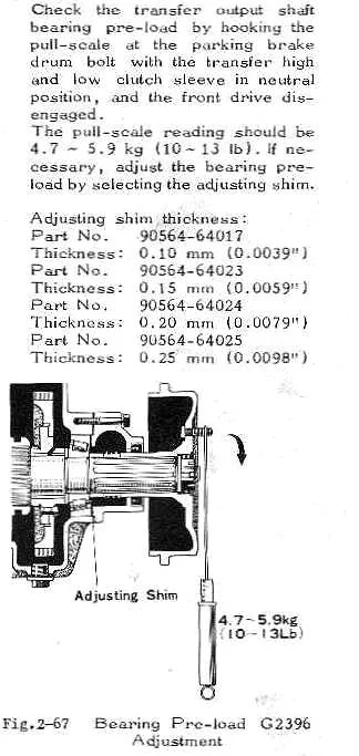

Does anyone know the pre-load specs for the rear out put shaft on a tranfer case 3-speed?
I was told the torque on the rear nut was to be 100 ft lbs. But I need to know what the pre-load should be.
Thanks :beer:
Welcome.
Here ya go:
attachment.php
