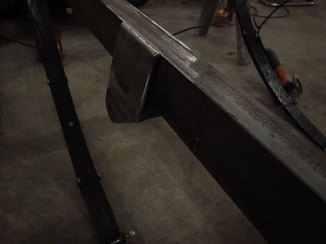

I'm with you there. 14ga is heavy s***, but I guess I put too much heat in the wrong place. I always pucker when welding sheetmetal....and usually, something bad happens:frown:
I think I can suck this down with bolts..........if necessary. Have to keep reminding myself.............."Its only a trailer"
Glad someone else feels my pain;)

A few pics of the welds.....

Looking great Ed, I can't even see where it is warped. Remember, you will be your own worst critic and see ALL the bad things but no one else will. On my trailer, I have things that I am bummed with (finish wise) and all my friends can't see it, and it seems to GLARE at me. I bet it is hardly noticeable!
Keep it up bud, looks killer!
If it's warping turn down the heat, take your time, and stitch weld it. Don't stress, have a beer, 14 Ga doesn't need a whole pile of hot.

BTW 73fj, I am going to use the 110 gas/mig with .023 wire to weld the inside when I flip it. I think you are right, I had the heat too high.:doh:
Ed
If you have some scrap from your project laying around do some practice beads. This will help you find a good heat range, plus it will give you some confidence with thinner metal. 0.23 is perfect for sheetmetal. :beer:

agrreed .23 is the way to go with sheet metal, also just jump around from place to place and i try to keep my beads on sheet metal to one inch or less, just helps with keeping the heat down.
