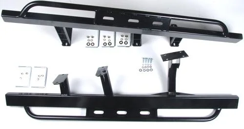

Looks like the plates could also bolt up to the frame if you don't want to weld them?
Sign me up for a set of 67' with the gusset set.

you guys are putting those on your hdj81s? I guess you have no cats to protect, but even so those plates don't look big enough for the frame and overall the arms and gussets look pretty borderline strength wise to me. i'm no expert so you guys might want to consider starting up a thread in the 80 section and get some input before you commit as there are some much more knowledgeable than me folks there. so far as i know nobody has succeeded so far in finding a super cheap slider solution for 80s. there is no substitute for heft. if anyone wants to see hanna 80- series sliders to compare I have a set here in vcr or take a look at www.hannaquality.com. a ton more money but i am guessing that if you don't need the cat protectors he could make them cheaper. they mount up on triangular angle iron arms to the frame.
if you look at the pic the legs arnt welded on yet. So the slider can be mounted at any angle. The material is 120 HREW . Strong enough for any of the guys in the club. As for paint, Im just gonna spray mine. The mounting kit may not work as they are for a mini truck frame. Measure you 80 series frame (hieght) and Ill tell you if it will work.
Dan
the 80 frame is roughly 6" x 2.5" and it's at least 9" out to the slider main support beam. if that is 1.75" tube for the arms/outriggers in the photos then those plates are clearly not big enough and it looks like they use 3/8" hardware from the holes where I would say even as a layperson that is clearly too skinny. i am worried about the 1/2" hardware on mine.
here is a recent thread showing trail damage to a slee slider with boxed and gusseted 3/16" outriggers. https://forum.ih8mud.com/showthread.php?t=90472&highlight=straighten+slider
for hanna sliders, the main slider beam is a 3"x4" 3/16" boxed beam, not a tube. slee uses a 2x4 3/16" box (see photo below) and the new metaltech sliders are even beefier. according to the hanna website the hanna outer tube is DOM 2" x .120 so that is beefier than your main support and slee uses dom tube for the outer tube too. The hanna outrigger arms are 1/4" triangles with 3/16" gussets.
I do not know anyone who has successfully used a tube for the main support for an 80 slider although I'm not saying it's impossible. just that a lot of fab people knowledgeable about these trucks have heard the requests for cheaper sliders and concluded it is not possible. having landed hard on my sliders i agree with them.
i don't want to sound like i know it all, just that i did a fair bit of research before buying sliders and everything I've heard suggests those you propose may be too light and so i respectfully suggest you go to the 80 board and ask for some advice before going this route. a number have made homemade sliders or adapted weldons so they can tell you if you are good to go or not. A loaded armoured 80 is 6,000 lbs+.
no wonder it broke, look at that crappy mounting hardware. weld it and be done with it

agreed. slee uses 7/16" u bolts. hanna uses 1/2" u bolts. I think that is a weak point but i am not willing to weld onto my frame and I don't think that is what buckled that outrigger. welding makes it stronger but can it compensate for the lack of bracing on those tube outriggers and can those tubes take a hard hit when 6000 lbs lands on a pointy rock? I'm no engineer so maybe they are good enough.

Mine will be welded on, big ass gussets added and spraypainted. All this for under $200, ya I think im on the right track. If you guys are worried Ill get the first set, beat the fxxx outa my truck anf you can be the judge.

I think for the $ they well do just fine and PS as DAN says weld the f*&^***^% and be dun! MY 2C... and hi ALL
semlin is right, the mounting kit will NOT work, but hey all it is, is a piece of 3/16 plate with a bend and 4 holes. easy stuff to make.
