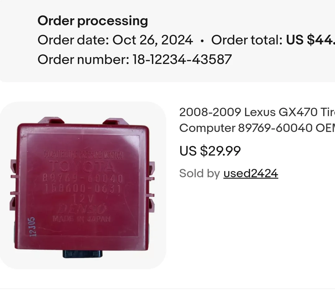

5 new sensors but tpms light is still on. For $30 im going to try replacing this next. I only need 1 of these right?
Anyone know where it lives on the car?
- apparently it is in the glovebox.

Got the car back. Holding this button for 30 seconds did nothing. Driving on the highway 5 miles with the button both in and out also did nothing.
Dropped the panel below the glovebox and a RED tpms computer box was staring back at me.
Parts cannon...FIRE!
