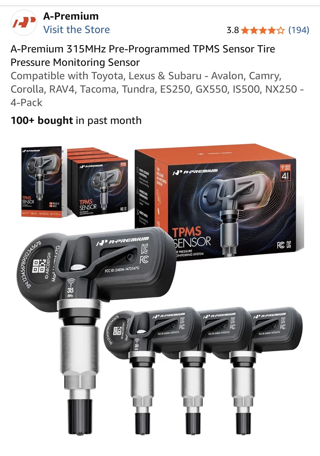

Running these with the OEM spare sensor using the change tire set setting.
One day I will swap the 19” Dunlops for Pilot Sport SUV tires and use the four OEM TPMS.
APTPMS262

I was going to buy these! However, as @Timujin says above, they don't sell 5. I bought the door handles from them and they were of good quality. A-Premium seems to do a good job.
I bought these as I could get 5 and they had good ratings:
https://www.amazon.com/dp/B0D6M95MJ7?tag=ihco-20
(If this link is dead, they are just cheap ones: Marsflex)
