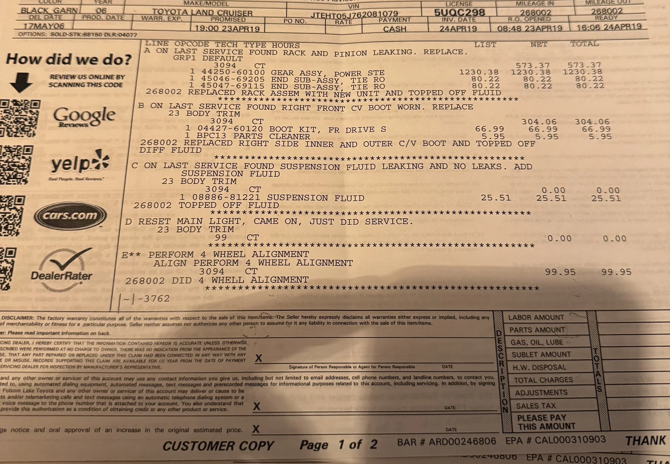

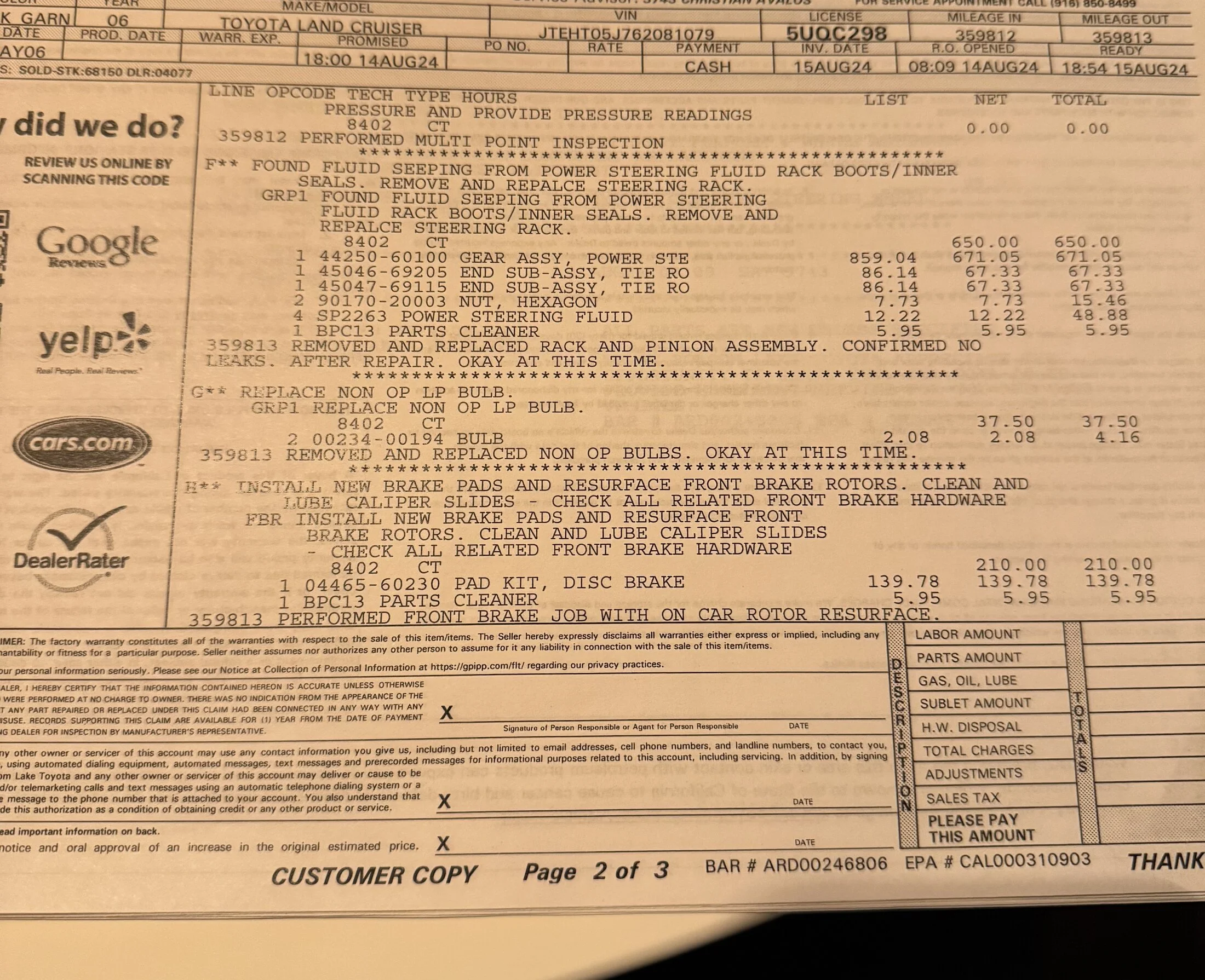

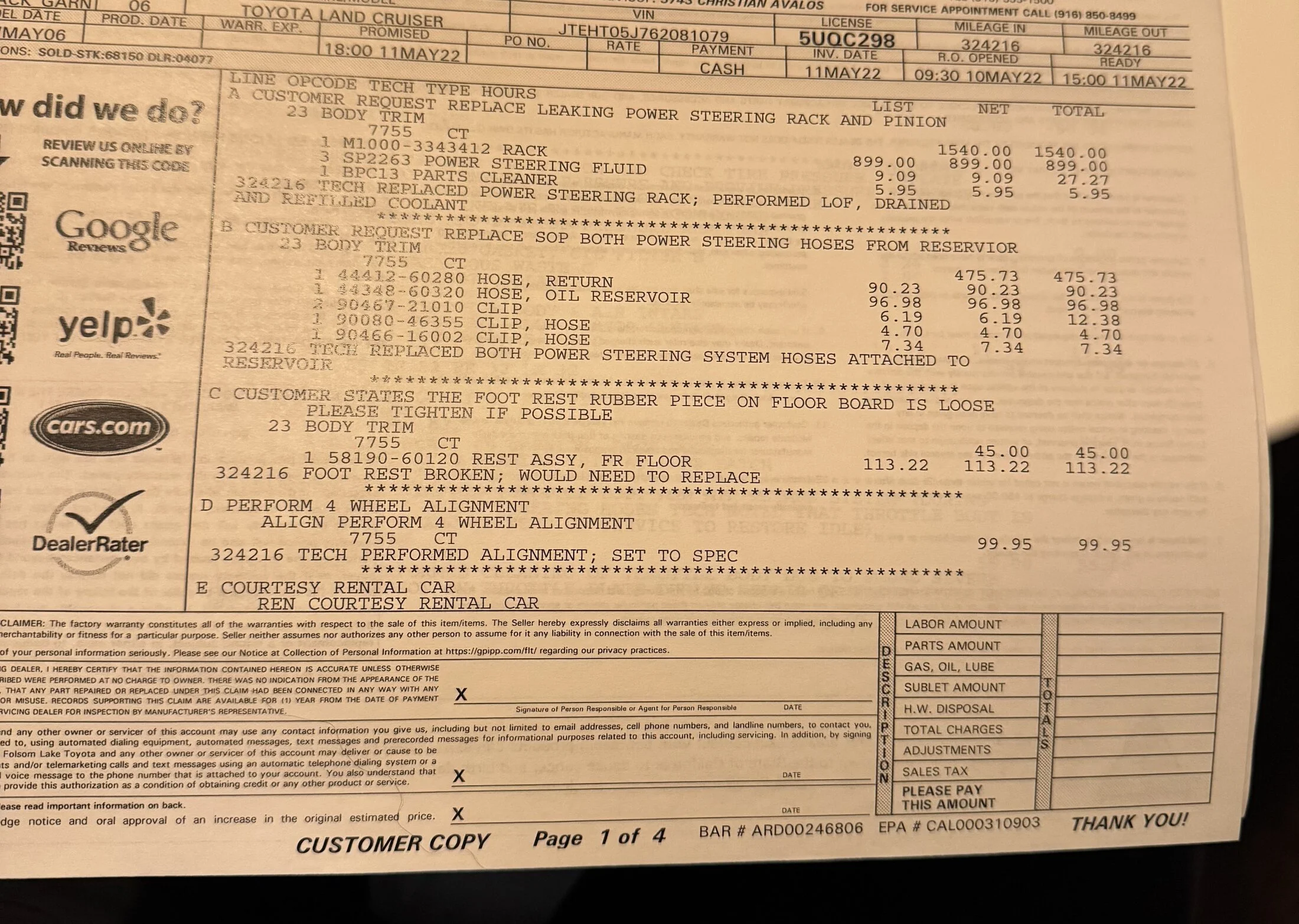

I have searched all over google, parts sites and Mud w/o any luck. Does anyone have an idea of what part could've been replaced costing almost $900 in 2022? I have the invoice below, it says rack and pinion but I believe that PN is actually 44250-60100 as shown in the second invoice picture below.
The odd thing (and concerning to me a little) is that 44250-60100 part was replaced at both 359k miles shown above and also at 268k miles (shown below). I wouldn't think it is normal to go after only 100k miles is it?
According to these invoices it is almost as if it was done 3 times between 268k and 359k miles but the PN in question isn't adding up to me.
