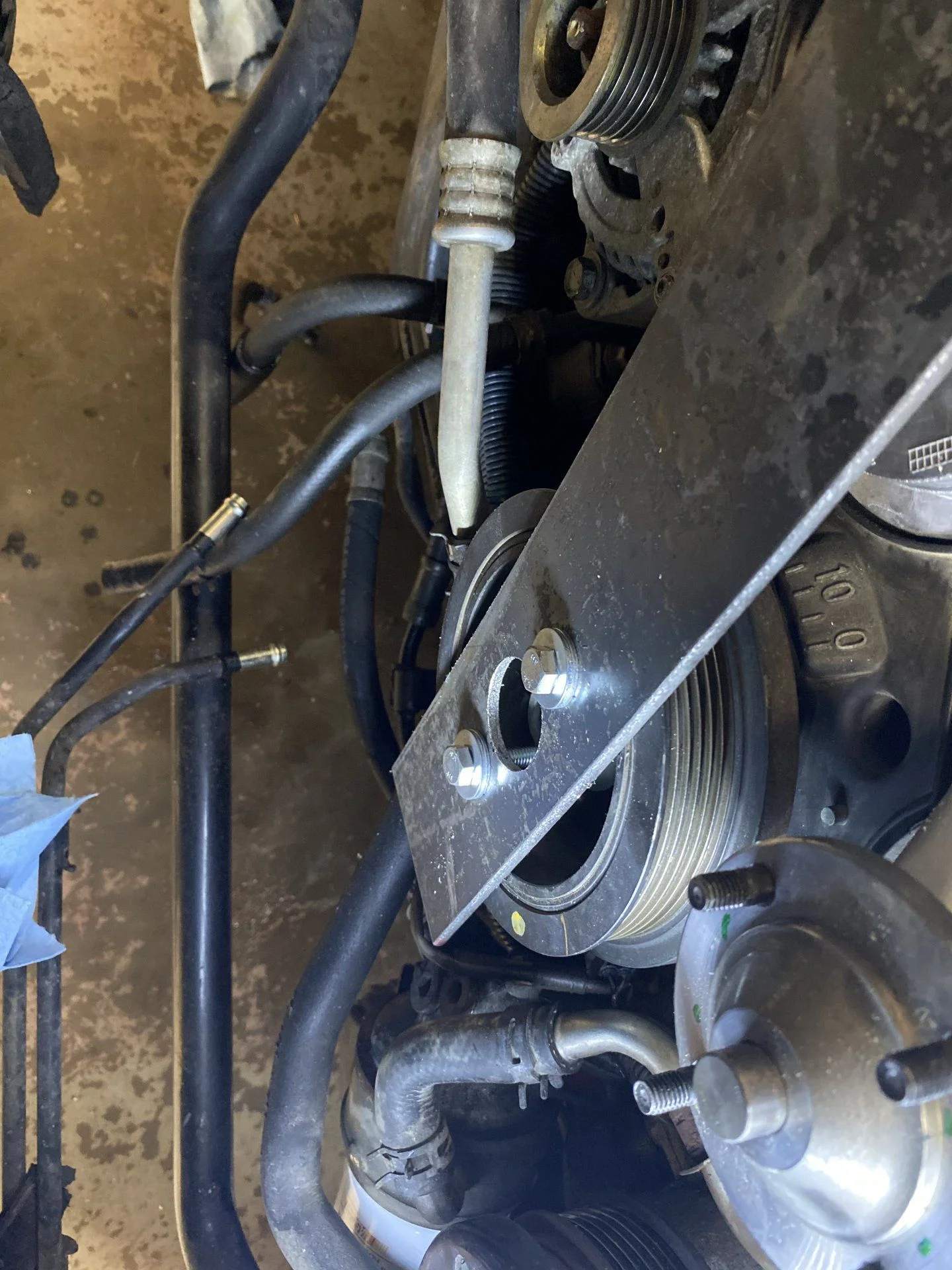

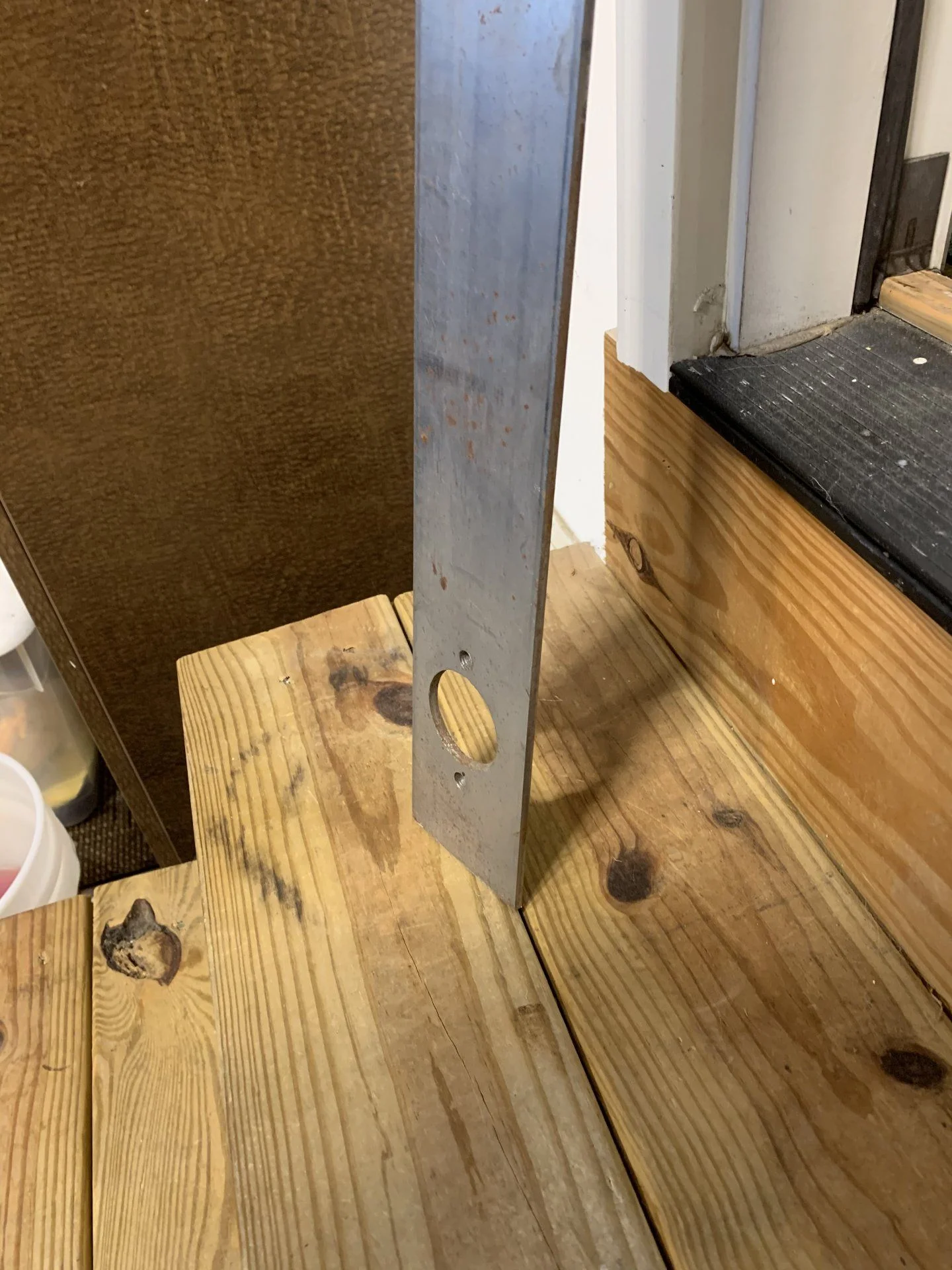

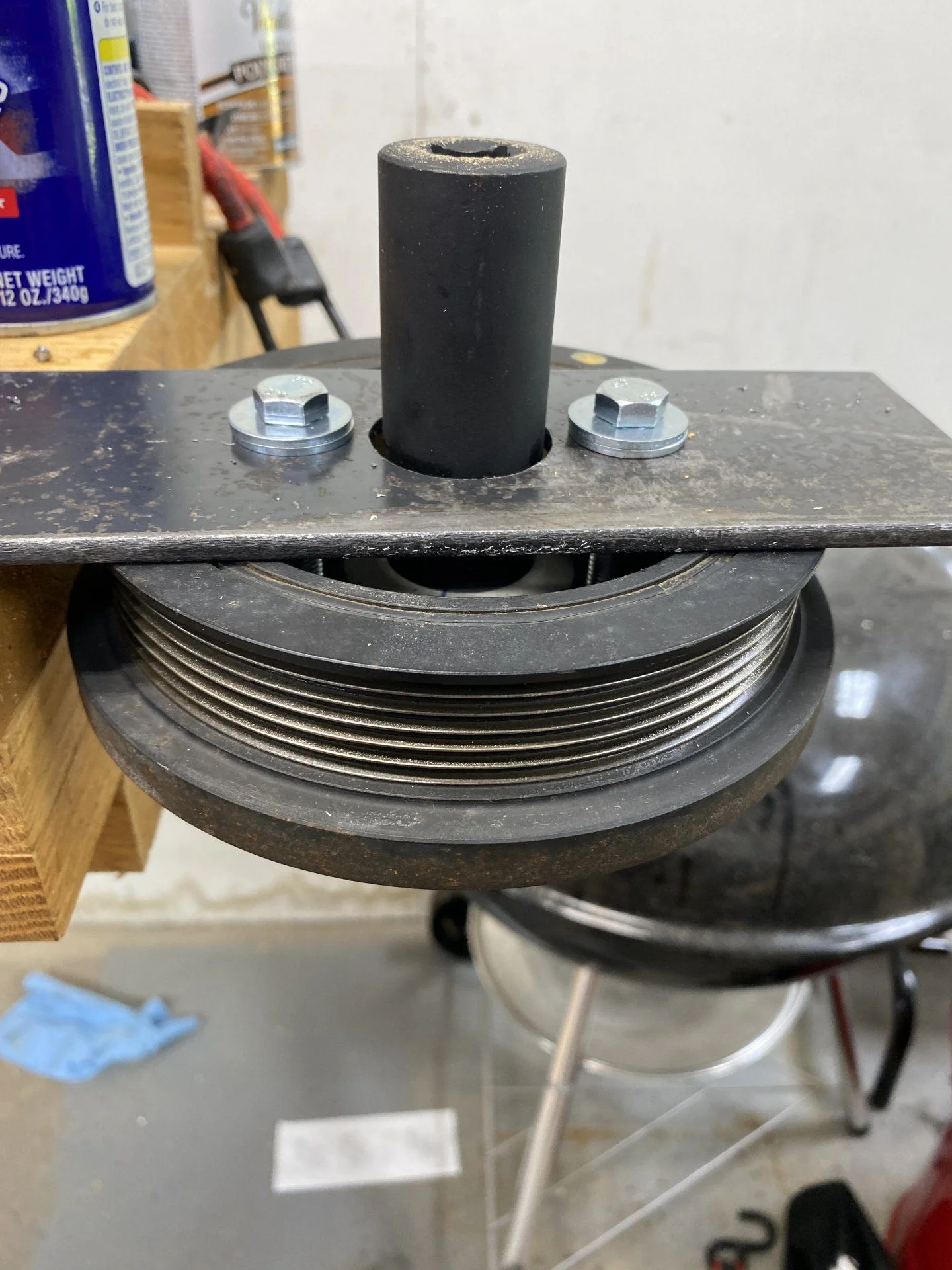

Here is the non-CNC version.
I made one with a ~3-4ft piece of steel from Lowes. Drilled a hole with a hole saw and 2 bolt holes with a drill bit. Worked great! I’m in Durham otherwise I'd lend it to you. It'll be cheaper to make one of these than the gas to get it to you

I can confirm dimensions in acouple weeks (leaving on a trip). The bolts are M8x1.25 (I used 3/8" for clearance) , I believe spaced at 65mm. The crank bolt takes a 22mm socket, I think I used a 1 3/8" hole saw. The material I used was 3" wide 3/16" steel flat bar.

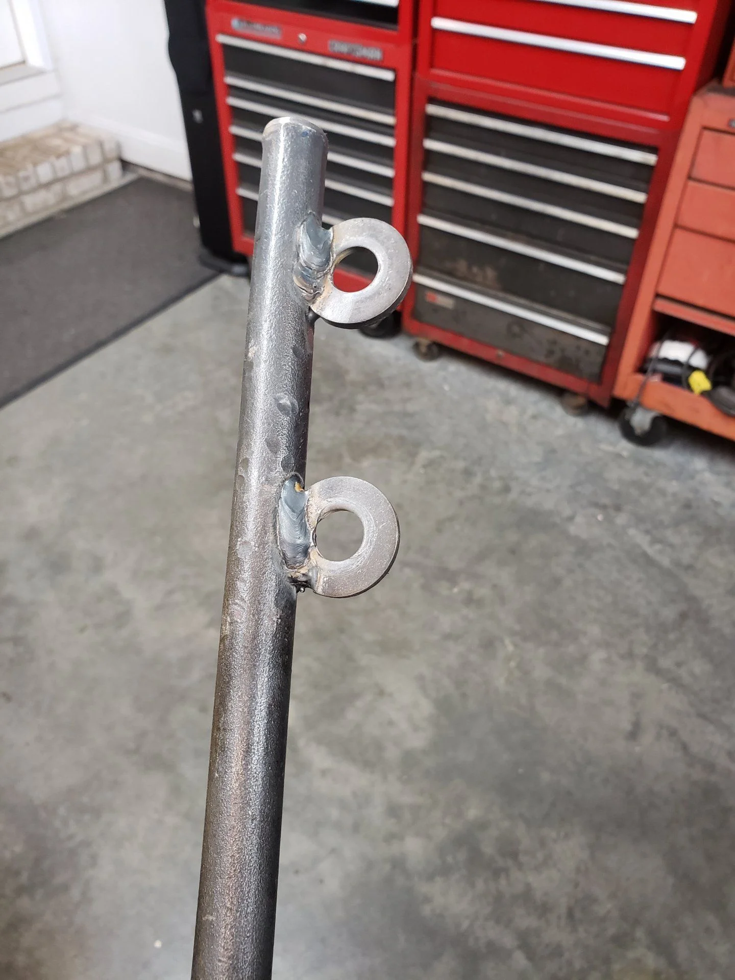

Nice work @rickycurrier !! I made something very similar for my 2nd gen 4runner (3VZ-E). I just did the timing belt on my LX470 and have a 1st gen Sequoia that will need it in a year or two so I bought a tool this time. I can HIGHLY recommend this...
