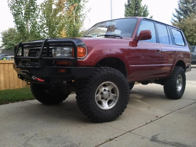

I have toyed with the idea of removing them since I bought it and bedlining the bottom half of the truck, colour matched of course.
I dont like any extra crap on the side of a truck as its just a damage multiplier, and causes dirt to hang and rust. The one plus is it covers the tires and keeps crap from flinging against the truck. I figure sliders, flaps and the bedliner will help with that though.
Has anyone had any experience with a bedline gun or any bedliner products? I have been looking at either Al's or Raptor Liner.

Are you going to fill all of the holes?
My worry is fender damage if I tear one off, I was lucky once already.
The holes I an still debating on the best method. Everyone says that aluminum tape works great and can be covered by the bedliner easily.
yeah welding is an option too but that has alot more potential to go sideways than tape.
I bet I could make tape go sideways.

My worry is simply fender damage. The flares use a mix of clips and these bolt style things that use a nut from the inside of the truck. You catch that the wrong way and crease an entire fender...
I do like to keep my stuff nice and clean, she isnt a trail donkey just yet haha.

Rust is a huge worry for sure. If I am going to go this route I will be using whatever high tech ant-rust fandangled coating I can find to apply to the inside of the hole and around it, then possibly the tape followed by the coating.
I honestly dont know if I have the balls to do it at this point though...
They have been temporarily removed. Holes are plugged with panel clips and excessive amounts of silicone. Will see if I can handle the mud flinging, etc and will look into a more permanent solution down the road.
Nice, better get some sliders made up before you crinkle your nice body up. I'll be going hard on the taco this days off. So hopefully make some decent progress.
Used Muggywelds to braze up the fender holes. Takes some practice - check there site for some videos. Has held up to some serious abuse with no issues.
Mud flaps really help.
Will have to look into that, thanks for the info.
Flaps are a must have without them. Gets messy right quick
