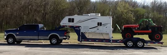

I know it's not what you asked, but 2 other outside the box options would be to buy a side by side instead - much lighter. Or buy a long flatbed trailer that could accommodate the camper and the fj40. Use that when you want to camp with the FJ and put it in the bed when you want to take just the truck. It could still pull the FJ40 without the camper too. Like this:
